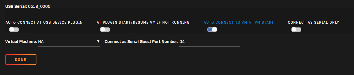

July 17, 20242 yr Community Expert 4 hours ago, testablet007 said: I have a little media server, HP elitedesk 800 g3 mini. My goal is to power on a VM using a USB device. I can turn on a VM using a phone via WOL, but my purpose is for little kids to turn it on by themselves. USB device > User script > VM turns on Is this possible? My usb manager can start a VM when a device is plugged in.

July 17, 20242 yr Author 1 hour ago, SimonF said: My usb manager can start a VM when a device is plugged in. Why I didn't think of this, I have this plugin install hahaha. Will check this out when I go home. Thanks
