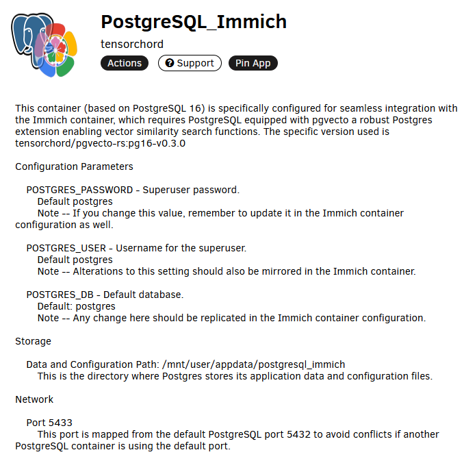

it is recommend to install the postgress v16 immichi database as it will be pre-set for immichi
for this docker it Should run as Docker network host.
the only path that should be edited is where teh database physical files will be stored on unraid:
for security you should change the password.

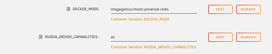

It is also recommend to add the docker mod and use redis inside this docker.
add 2 addition variables not found in the default template:
Information on that is inside Additional Requirements: within the template.
you will need to add unraids IP to the postgress line:
If you changed the password make sure the password matches here:
the template is prefilled with the other defaults. do not change them.

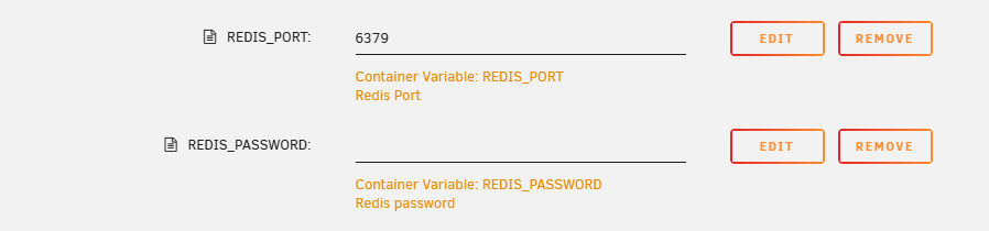

if using the docker mod option, leave the redis info alone and password blank:

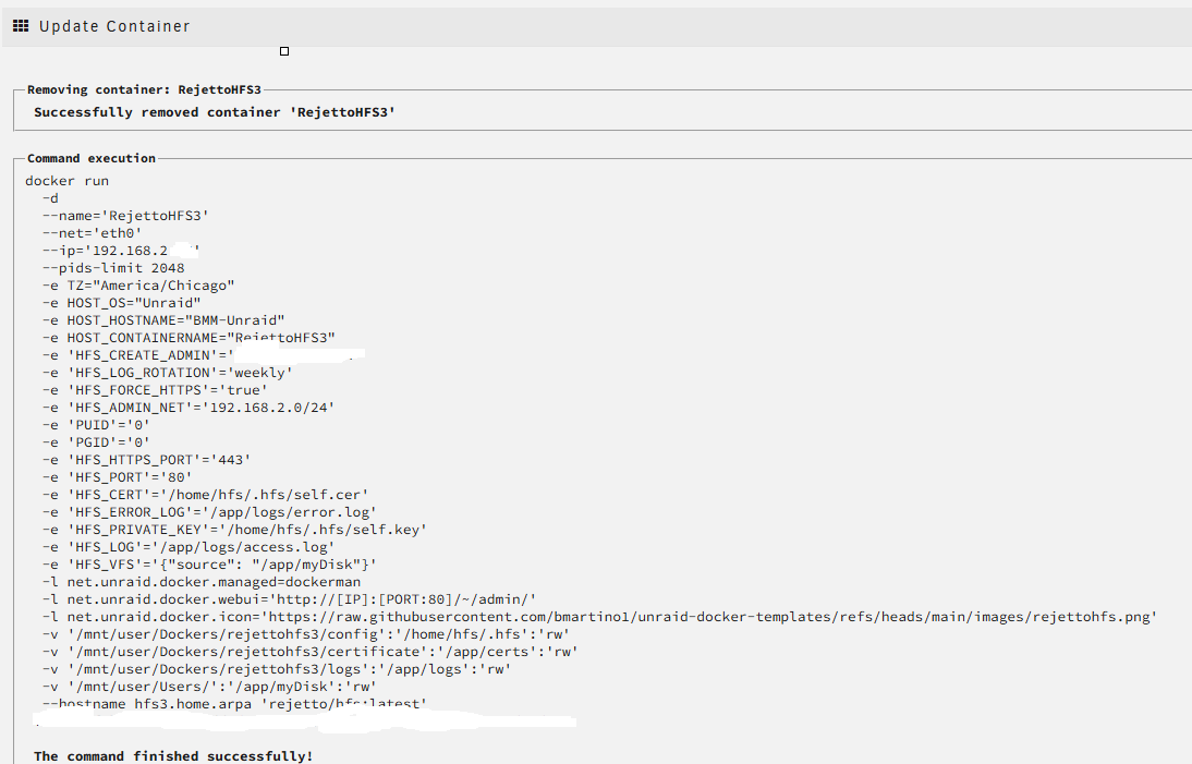

when you click apply after editing a template you have a docker run cli
you can copy that and make/ use coposerize to convert your immich docker into a docker compose
