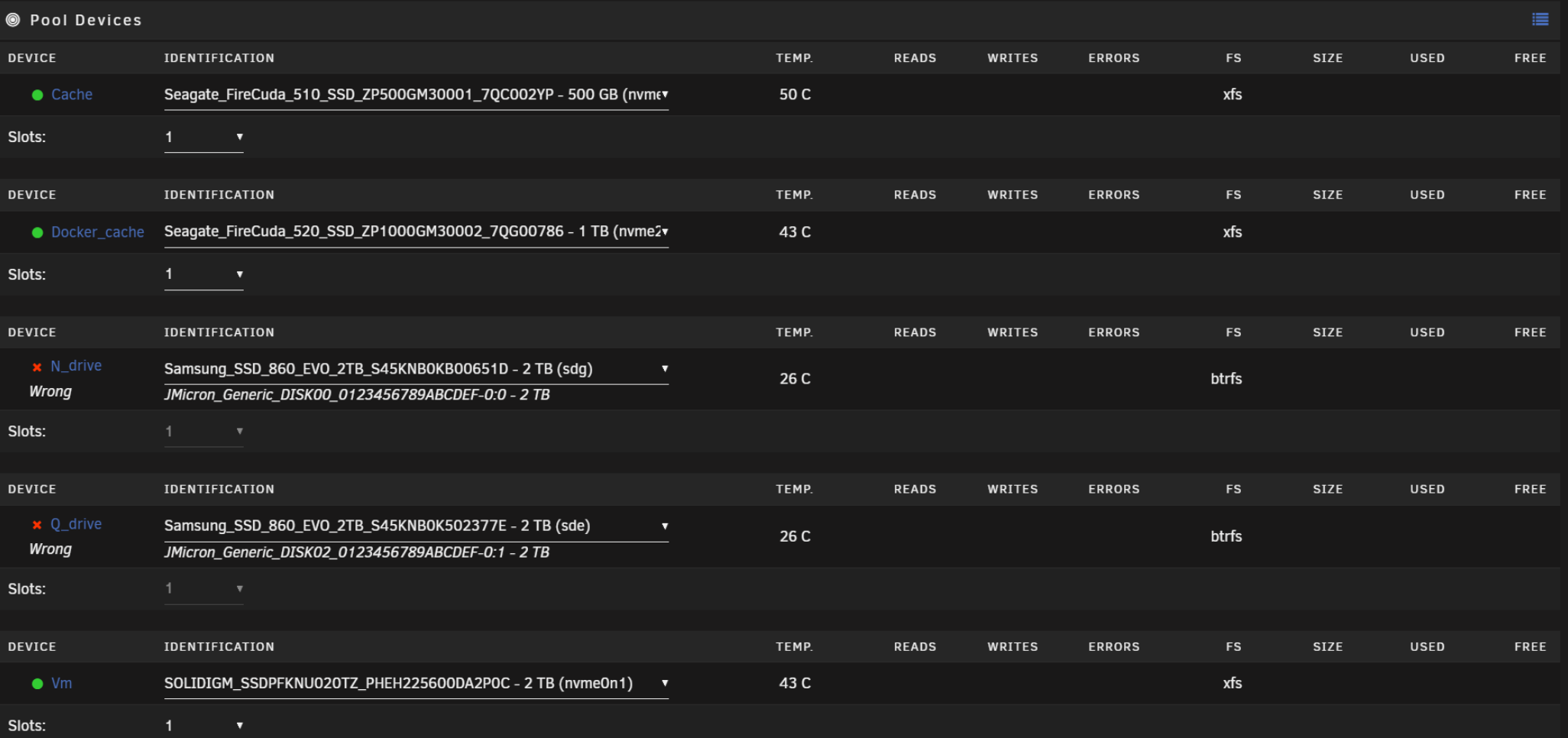

Hi @JorgeB, good day to you :) I finally had a chance to move my external 2.5" SSDs internally into my Unraid server. As expected, the device IDs on these pools are now "wrong" and I can't proceed to enabling the array.
You mentioned that I can re-import the pool, but I'm not sure how I should go about doing that. My apologies if this is a very straightforward process. I'm just worried of doing the wrong steps and making a bigger mess.
Just as a refresher, I am not swapping the drives for those pools with new drives, just moving those same drives from an external enclosure into the server and connecting them directly via sata ports. My only real concern is messing around with the pool and having to reconfigure my docker apps so they all work again normally.
Please let me know how I should proceed from here. Thank you very much for all your help.
To re-import a pool you can do this:
unassign the pool device(s)
start array
stop array
re-assign the pool devices(s)
That should re-import any existing pool.

@JorgeB, wonderful! Thank you so much for the guidance, everything is working perfectly normal now!
