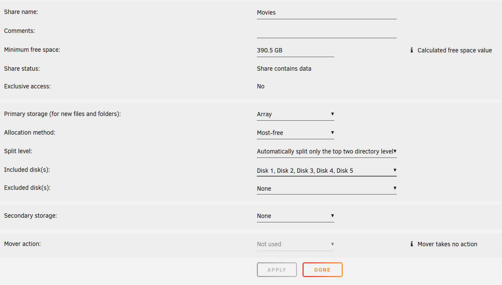

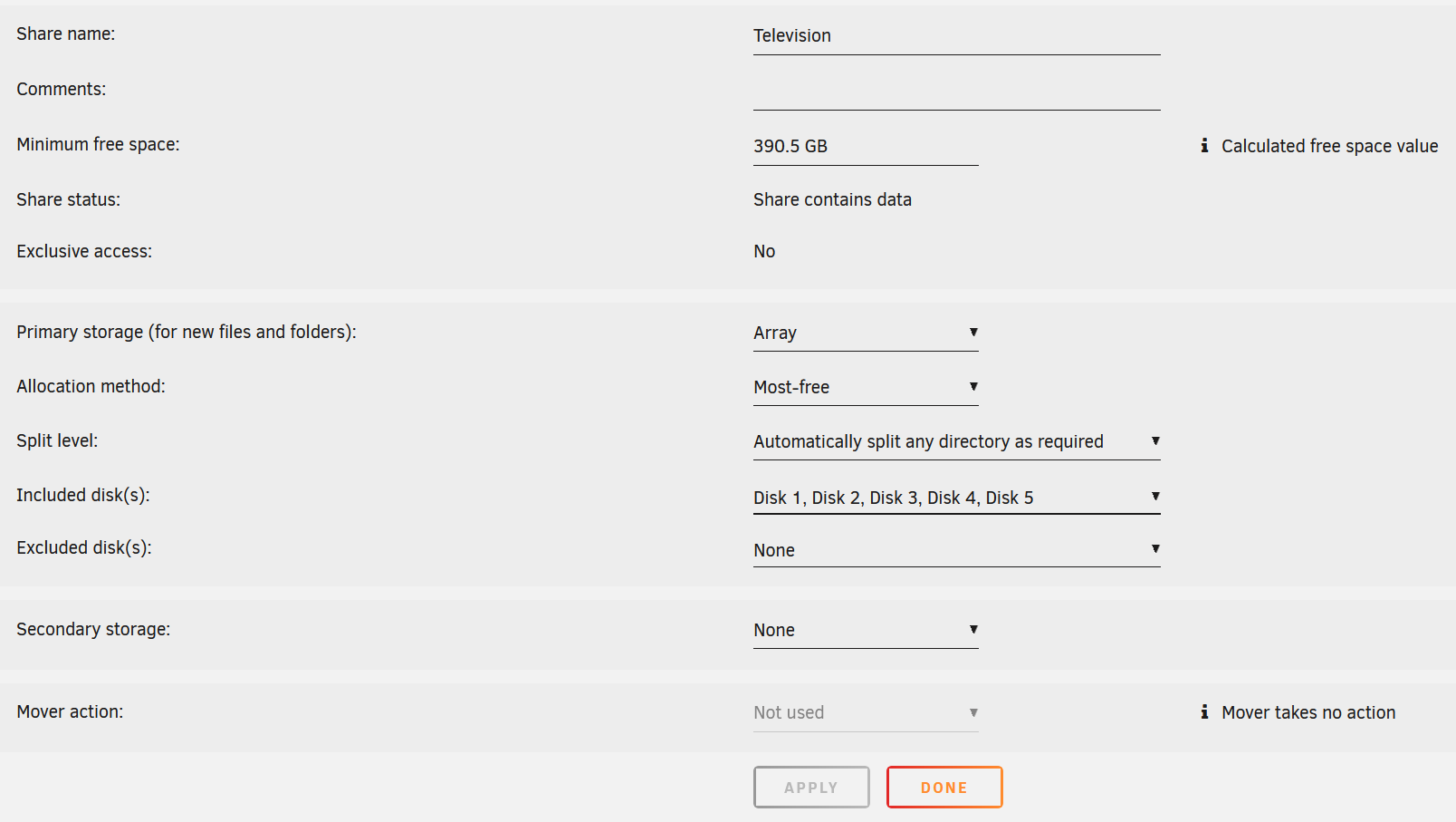

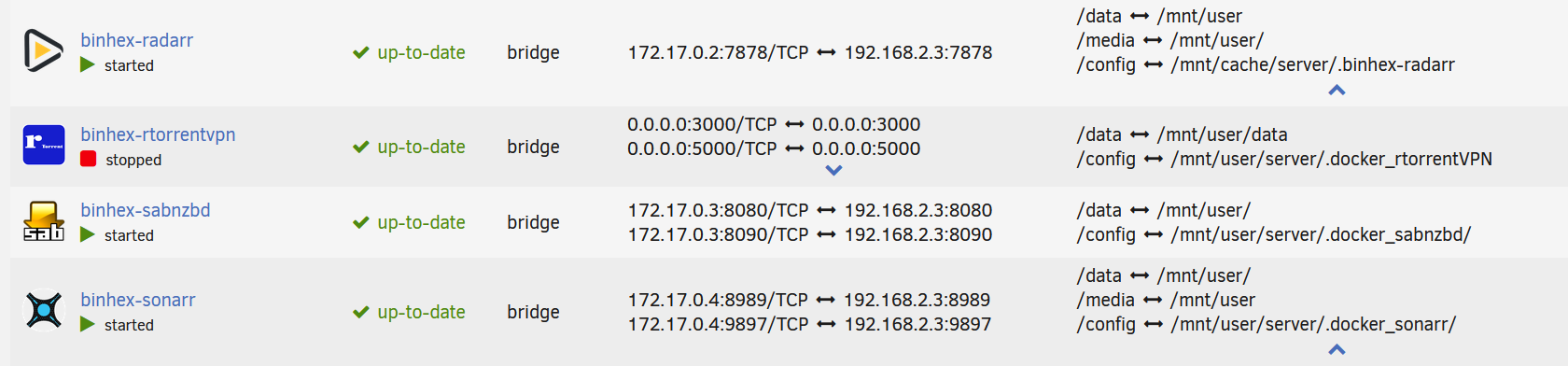

July 19, 20242 yr * I have had my system for 20 years, so I may have some hidden configuration files I've forgotten about. * My "Television" and "Movie" shares have ALWAYS used a cache drive. * I have recently turned off cache for these shares. * Radarr/Sonarr/Maybe Sabnzbd is writing to /mnt/user/cache/Movies and /mnt/user/cache/Television This ends up filling my cache drive, because the mover wont move, if the shares are not set to use cache. Share configuration Docker volume mappings I'm really confused why data is going to my cache drive... Any help or direction would be greatly appreciated.

July 19, 20242 yr Author I disabled the cache for those shares, but somehow Television/Movie files keep getting written to the cache drive.
July 19, 20242 yr Okay. Looking at the picture you have set the arrs to bind to /mnt/user, this should be /mnt/user/Movies and Television.
July 19, 20242 yr Author I don't know what difference it would make - For example, in Radarr, I just have my Library set to /data/Movies

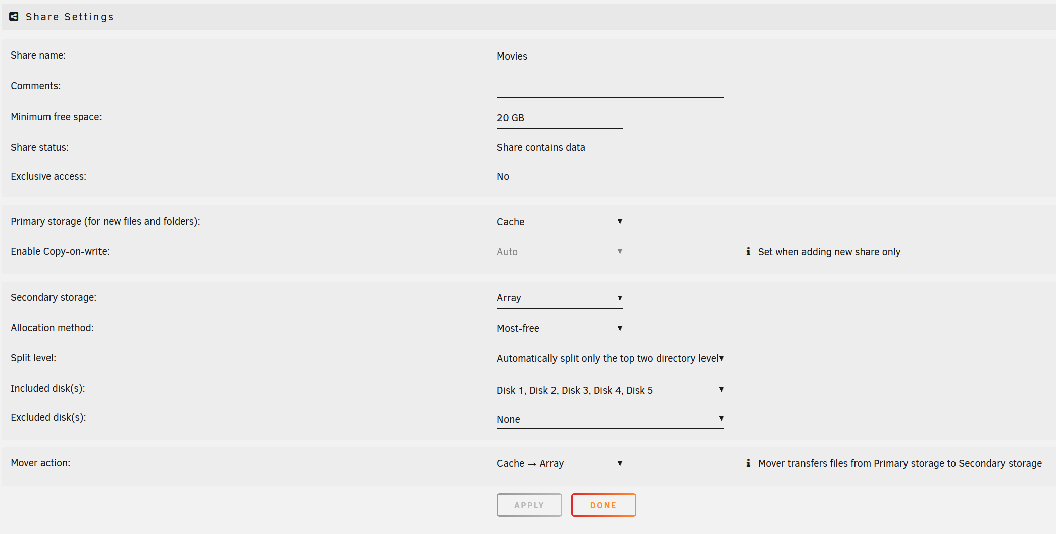

July 19, 20242 yr Author Roger. I did not have min free space set for either of these shares. Here is where I am now.
July 19, 20242 yr Community Expert Solution Note that I said the Minimum Free Space for the pool - not the shares. The one for the shares is aimed at stopping you filling up array drives too far. You need to click on the pool on the Main tab to get to that setting for the pool.
