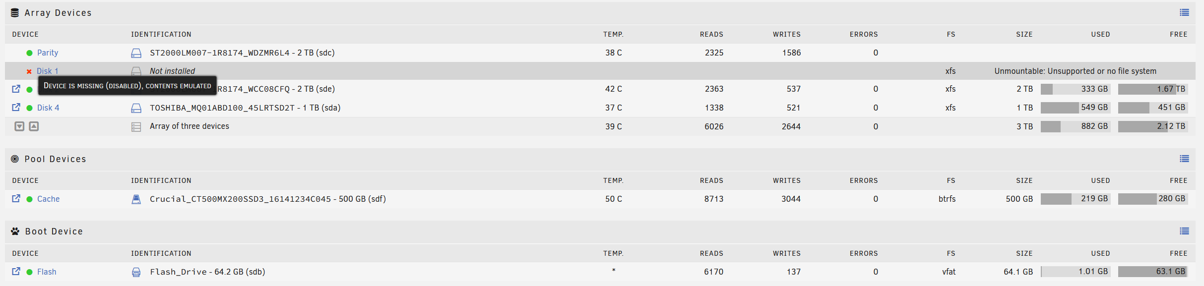

One disk failed, unraid says it is emulated, but there is no data from that drive accessible !
I am terrified, because I have one failed drive.
I have shutdown unraid and removed failed drive.
Now I can star array, it says disk 1 is emulated, but there is no data available from this drive. Does it mean that my data is gone? That parity didn't protect my data?
Or maybe I need to put back my failed drive into system again, which would be quite nonsense?
I do not want to buy new drive and rebuild, because it is too expensive. I want to move my data to second drive, as I have plenty of space free and then recreate array.
I have attached screenshot from my array. When it is started i do not see /mnt/disk1  as I should. Is there anything I can do or this unraid parity is complete garbage and I have lost my data? Help!

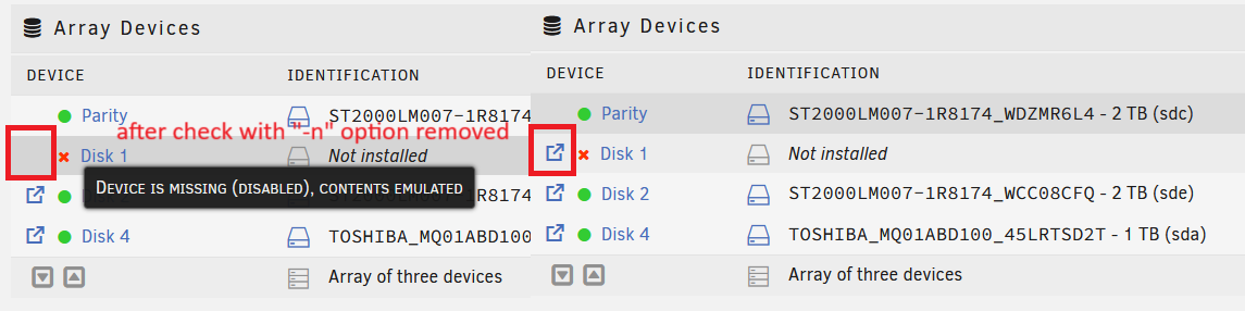

To conclude, in situation when one drive fails, then it says "context emulated" disk is marked with red cross but actually content of the disk is not emulated (you cannot see browse button next to Disk 1 name - see my first post). In this case unraid says "unmountable: blabla". In my case filesystem was corrupted on Drive 1.
So what You need to do is:
1. Stop array.
2. Star array in maintenance mode.
3. Click on removed or faulty disk and then run check for this one disk, however !!! MOST IMPORTANT !!! by default it adds -n option to check. It makes only do readonly check without fixing by default. Remove "-n" and click to check drive.
4. Stop array.
5. Start array in normal mode. Now you should be able to see emulated data from emulated drive.
See the screen shoot of my array before and after check.
Solution is so silly and it was impossible for me to figure it out from unraid docs. Doc are quite counterintuitive for me.
Community is what makes this product really cool and my faith in unraid parity has been restored. Thanks again Mr "itimpi", I get You a beer if You come to my city Wrocław in Poland! ;)

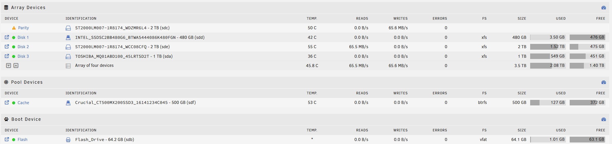

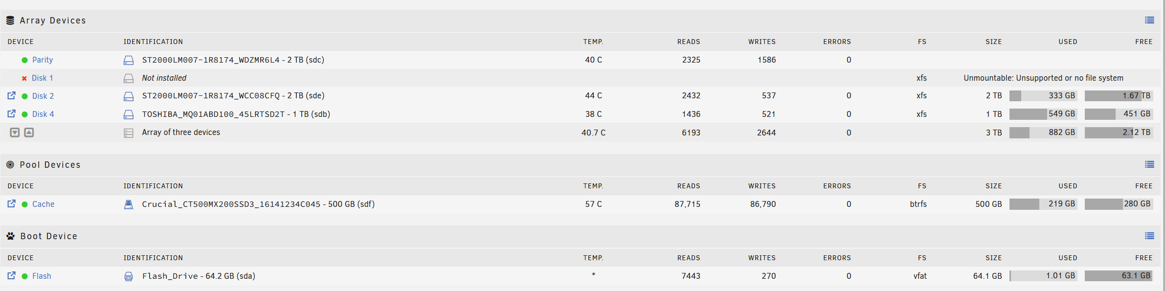

7. I went to Tools-> New Config and created new empty config of an array, without coping any old configuration. Just completely new array.
8. Then I went to main tab and assigned hard drives to new array, paying supper careful attention that parity drive is the same drive as it was before and that cache drive is the same drive as it was before. I check disk IDs with the screenshoot (p.6) 10 times :D I added new drive (smaller) in slot where Disk 1 is, as a replacement of failed drive (original drive was 2TB).
9. Then I have stared the array.
10. Then I went to docker tab to stop all dockers as the will degrade array parity rebuild performance a lot! I also stopped all VMs.
11. After parity was rebuild and array was safe I moved some of the most important data from disk 2 to new disk 1. In my case this is appdata, because owncloud is the main reason I am using self hosted NAS and Unraid. All other dockers are my playground, but Owncloud I am using in my job to sync data between PCs, so it is feeding my family, it is priority no 1! :)
Of course if I want to afford new 2TB hard drive to replace broken one (it must be equal size or bigger!), after fixing filesystem on drive 1 I could simply rebuild my array from parity. However I didn't want to do it simple way for those reasons:
  • I didn't want to spend cash on 2TB 2,5 inch HD.
  • My space usage was low enough that I didn't need that much space.
  • I had server grade Intel ssd in my drawer, but it was 0,5 TB in size. It is sufficient to keep my owncloud data and even maybe whole appdata folder. Also my server is running quite hot as this is laptop in my garage, so I preferred to replace hdd with ssd as ssd is more resistant to temperature around 50-60 Celcius degree.
Therefore I did procedure above to do it the way I wanted. The result I will show on screenshoot:
So it is rebuilding parity now. Point 11 actually I am just about to do in 30 minutes after I am writing this post :)
