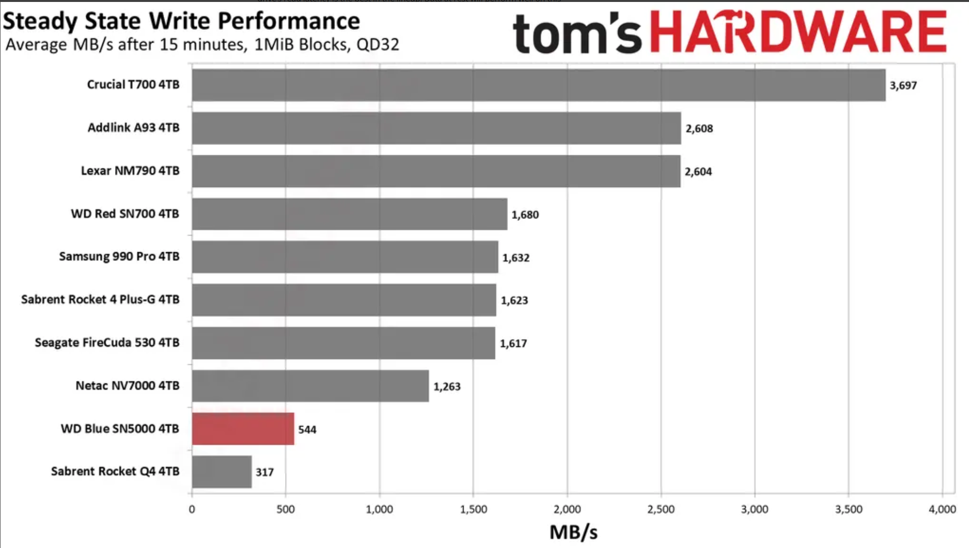

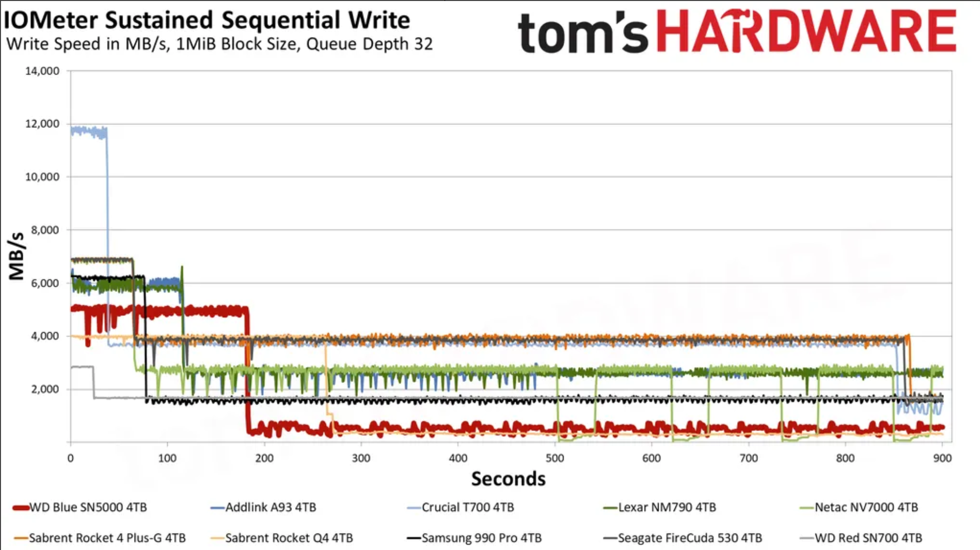

I would get them with heat sinks if you expect to have long periods of writing.  As I understand it, writing requires more power than reading.  Also the high speed write buffer is smaller (and, perhaps, slower) on the cheap MVMe devices.  Your use case will determine if this will be an issue...  (I would be looking at Independent online reviews by folks who subject the device to actual tests and provide the results for you to analyze.)  (If I recall correctly, the write speed on some of these devices is slower than a HD after that buffer is filled!)
This is an example of what I am talking about:
and
and
Thank you all. I'm glad I went with the Lexar NM790 in the end (with heatsink). No dram cache but performs well and has really good TBW value. That's also what I'm using for my 4tb Cache/App Data as well at the moment, and no issues so far. :)
