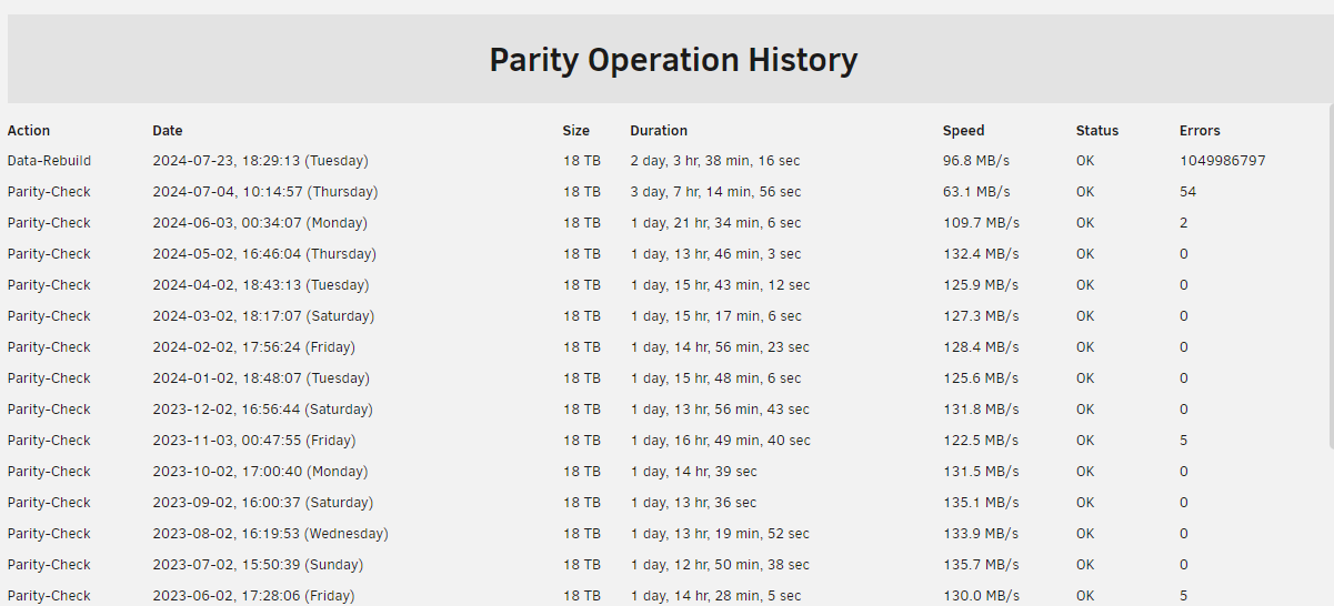

Old party history shows nothing too strange except for the rebuild.

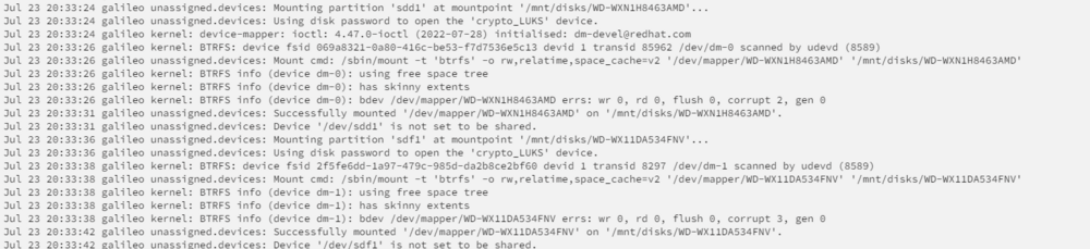

Both were mounted successfully (GUI popup said error while mounting, but syslog seems fine, they are listed as mounted in GUI and can be accessed via terminal [browsing the folder structure without any obvious errors)
Any parity errors at all needs to be understood and not dismissed as "nothing too strange".
The screenshot suggests you have configured scheduled parity checks to correct parity errors. Better to schedule checks to not correct. If errors are found, determine the cause. After eliminating the cause, then correct parity.
You don't want to allow a bad disk or connection to corrupt parity.
The small number of parity errors on previous checks could be due to unclean shutdowns, or possibly RAM.
If you were running a correcting check when you had the large number of parity errors, then probably you have corrupted parity so rebuild will not be good.
