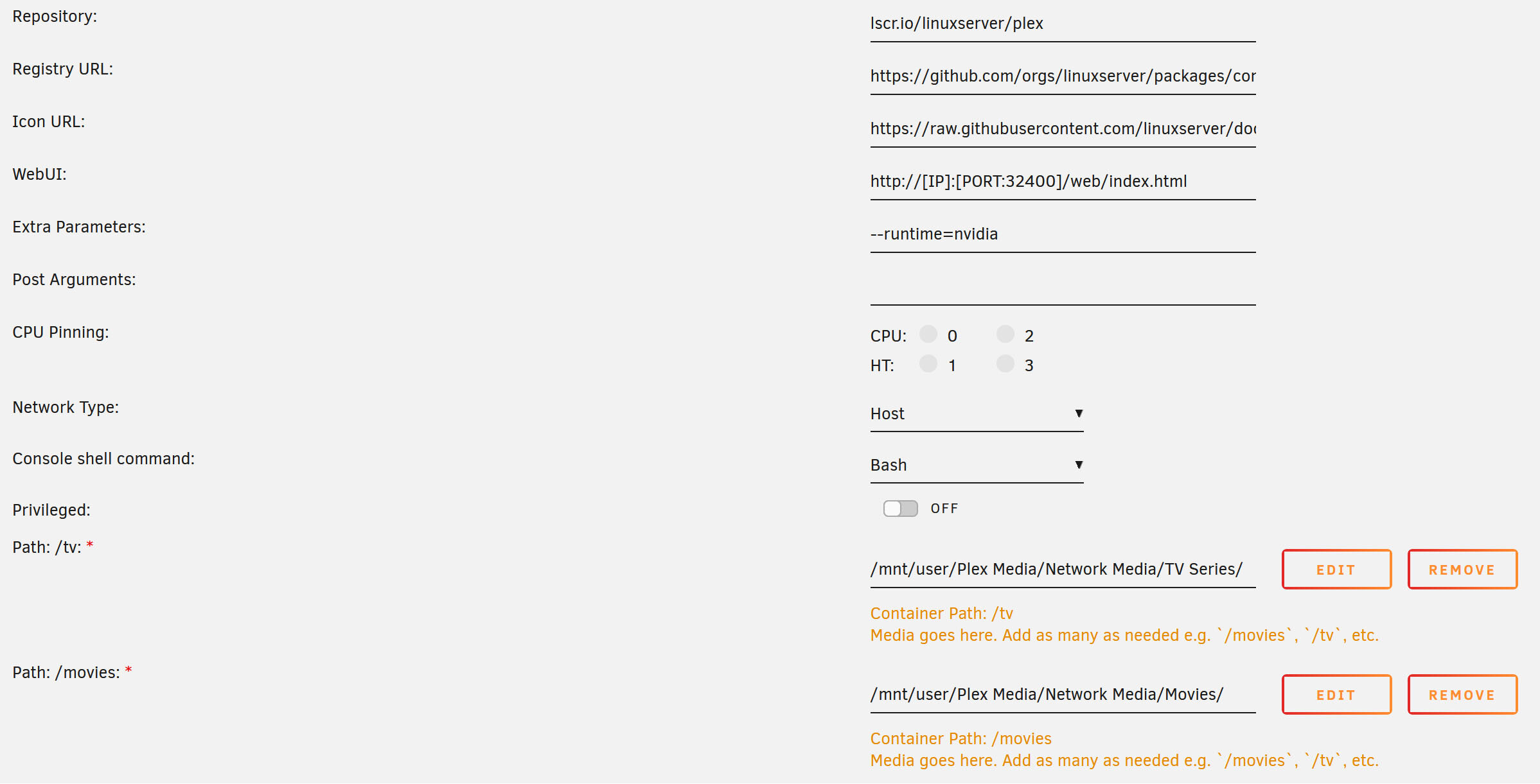

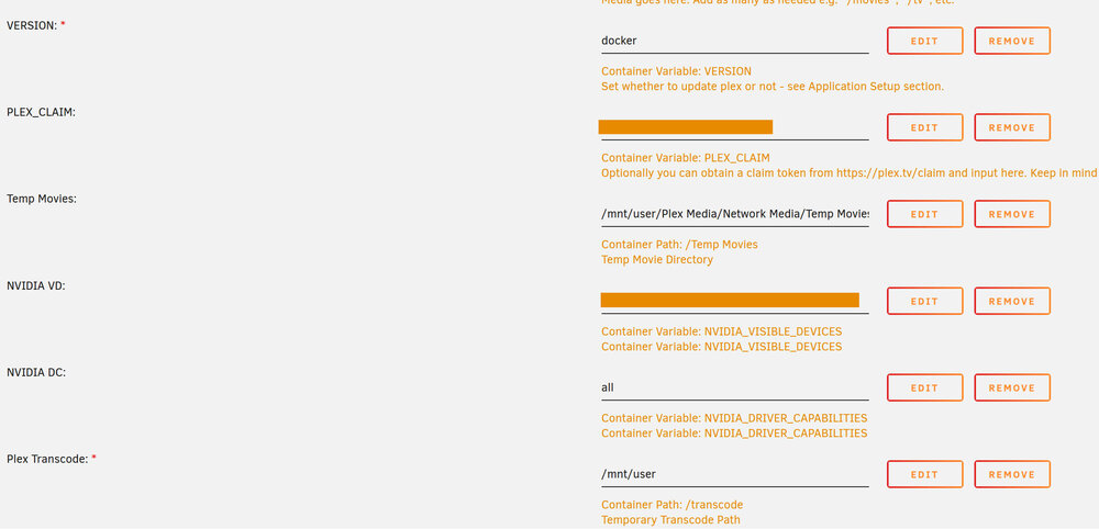

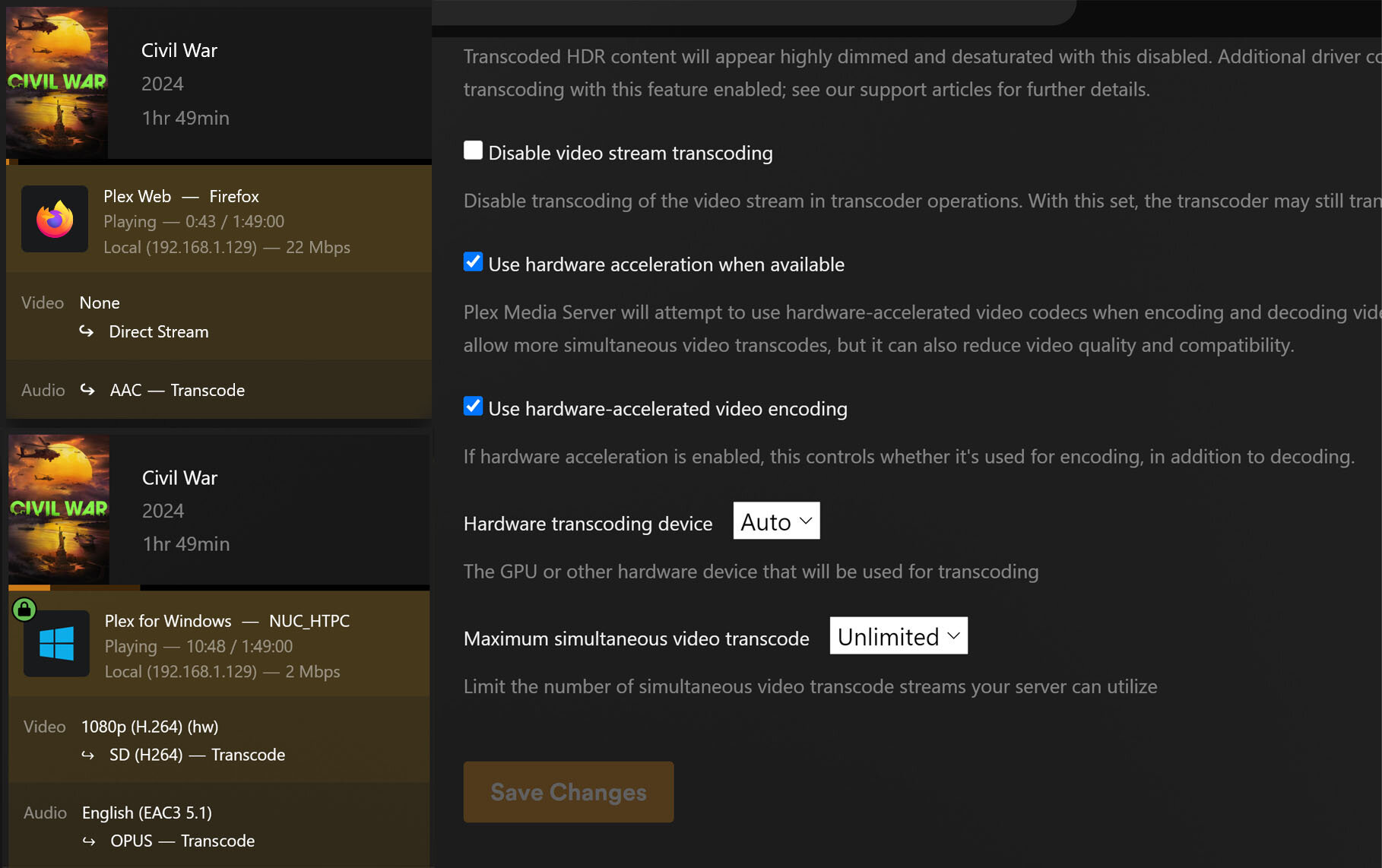

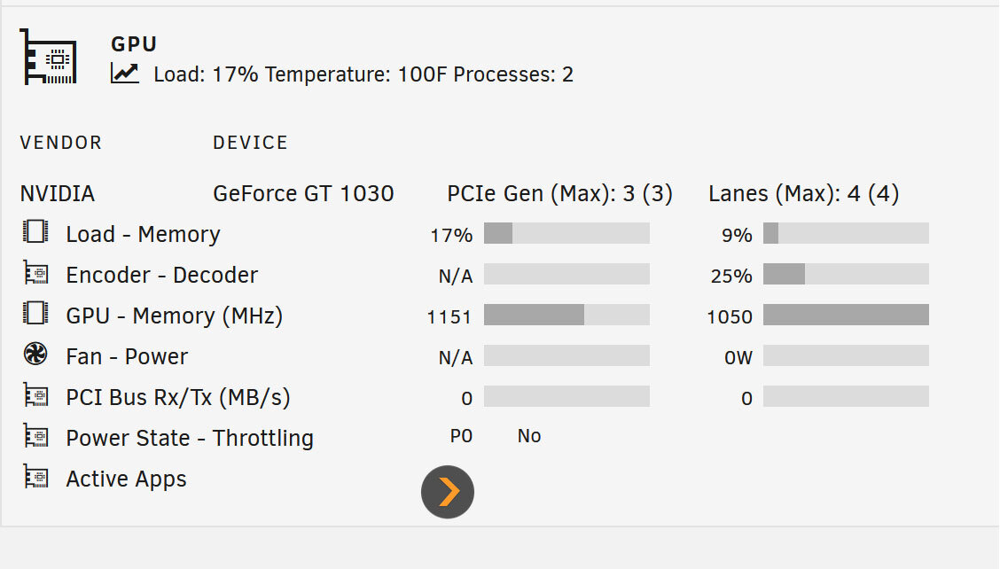

July 24, 20242 yr to the best of my knowledge, I have followed the instructions to the letter. I have some concerning issues are in my Transcoding settings page on my Web UI and my Windows App, I don't see my GPU as an option, only 'Auto'. The Web UI the videos play fine, no skipping or stuttering, but it's only playing direct play. On my Windows App, it is showing 'hw'. However, no matter what settings I chose in my transcoding setup, it still seems to stutter. I installed GPU Statistics to see how my GT1030 is handling the load and it seems like it could be doing more (last pic) Can anyone see a setting I have missed? Thank you n advanced! Edited July 24, 20242 yr by SmirkAction

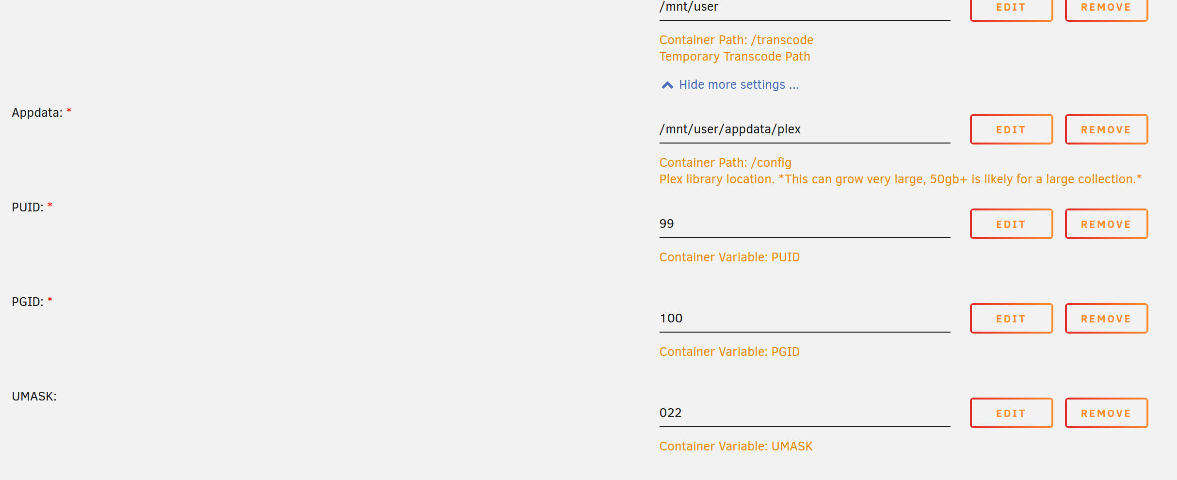

July 24, 20242 yr from what i see you are using /mnt/user as transcode path which is located on your array (probably spinning drives). you should use a ssd (/mnt/user/cache/plex-transcode)for that path or ram (/tmp/plex-transcode) if you have enough. Your problem doesn't seem related to gpu as it's used.

July 25, 20242 yr Thought I'd mention, GT1030 doesn't support HW Encoding, could this be your issue? GPU is decoding your media correctly, as I can see it's been used in GPU Statistics - it's then your CPU which is encoding the media, which I'm assuming is H264. From the screenshot I can see you have a dual core CPU, this isn't gonna like software encoding unless the encoding profile is set to 'veryfast' and extremely low resolution, and also a extremely low bit rate. Also, when anything is transcoded, the audio part of transcoding is handled by CPU So at this time, your dual core CPU is encoding audio and video, while your GPU is doing the decoding. It's got it's work cut out, would possibility explain the stuttering
July 25, 20242 yr Community Expert On 7/23/2024 at 11:13 PM, SmirkAction said: GT1030 is handling the load Your GT1030 isn't doing anything but wasting power, the GT line doesn't have any nvenc encoders (only the GTX does) https://developer.nvidia.com/video-encode-and-decode-gpu-support-matrix-new Edited July 25, 20242 yr by Michael_P
July 25, 20242 yr Author 4 hours ago, mrkambo said: Thought I'd mention, GT1030 doesn't support HW Encoding, could this be your issue? GPU is decoding your media correctly, as I can see it's been used in GPU Statistics - it's then your CPU which is encoding the media, which I'm assuming is H264. From the screenshot I can see you have a dual core CPU, this isn't gonna like software encoding unless the encoding profile is set to 'veryfast' and extremely low resolution, and also a extremely low bit rate. Also, when anything is transcoded, the audio part of transcoding is handled by CPU So at this time, your dual core CPU is encoding audio and video, while your GPU is doing the decoding. It's got it's work cut out, would possibility explain the stuttering I was under the impression this GPU did do hardware transcoding. My CPU is a AMD A10 7860k, there should be more than 2 cores, not sure why it's only showing 2. 2 hours ago, Michael_P said: Your GT1030 isn't doing anything but wasting power, the GT line doesn't have any nvenc encoders (only the GTX does) https://developer.nvidia.com/video-encode-and-decode-gpu-support-matrix-new This bums me out. Time for a full hardware upgrade it appears
