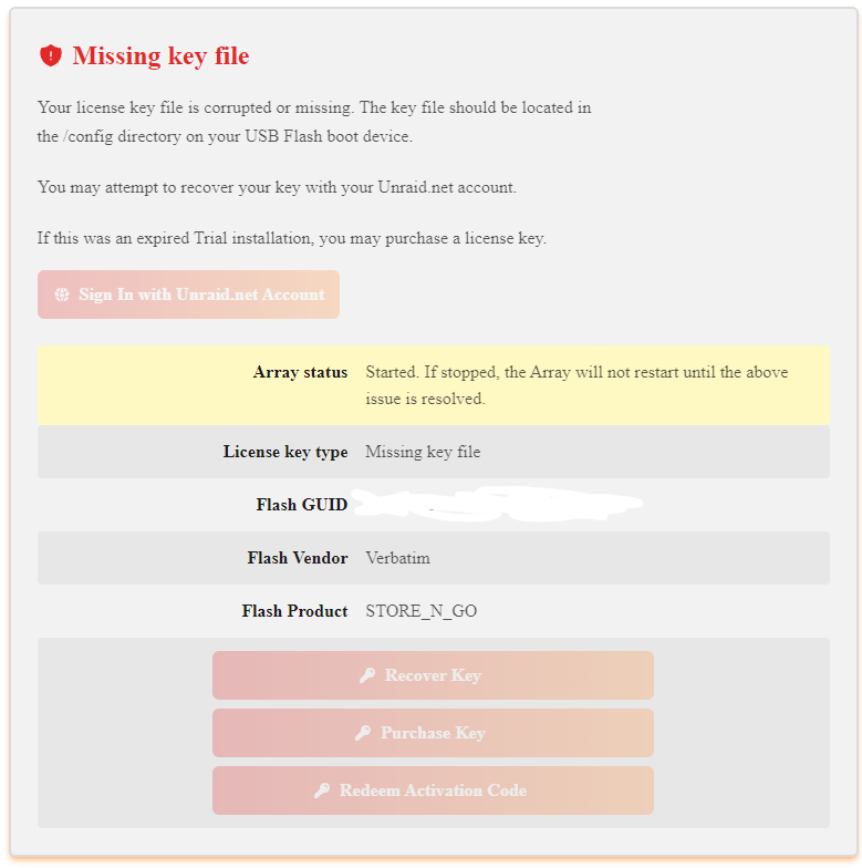

Once I get into the menus on the server, I get this message:

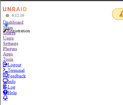

Also, the UI in general is kindof a mess:

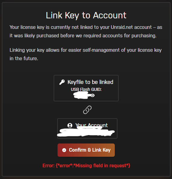

I've attempted to login to Unraid.net to link the license file to the USB key. I get this error:

My array is still running and the menu is still (more or less) navigable, so I took a screenshot of the assignments.
