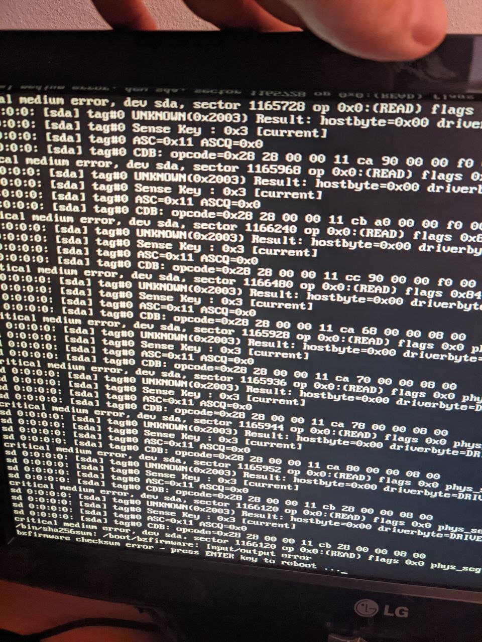

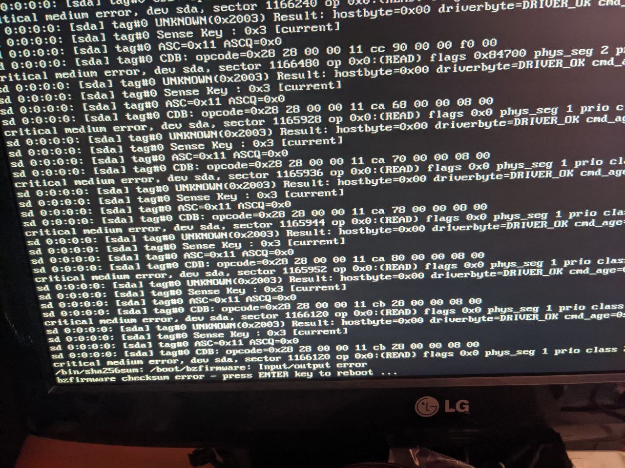

Docker stop working, now doesn't boot. New pen changed last month
As the title said, during night, on containers update docker stopped and didnt work. (venturanas-diagnostics-20240726-0923.zip)
Reboot, server booted, but docker still doesnt started.
On the last reboot, now doesnt boot into OS.
Pen is accessible in windows computer.
5846227140658447501.thumb.jpg.b0a827adf601bfaadaa2c525b2e238b6.jpg5846227140658447500.thumb.jpg.18d6dc33a8127187181624cdafbe2a38.jpg

Those screenshots show an issue reading from the flash drive.
Sometimes downloading the zip file for the Unraid release you are using and then extracting all the bz* type files and overwriting the 9nes in the root of the flash drive can help.

Thanks that worked.
I think the files got corrupted due the heat in the usb flash drive.
Thanks, everything works now!
