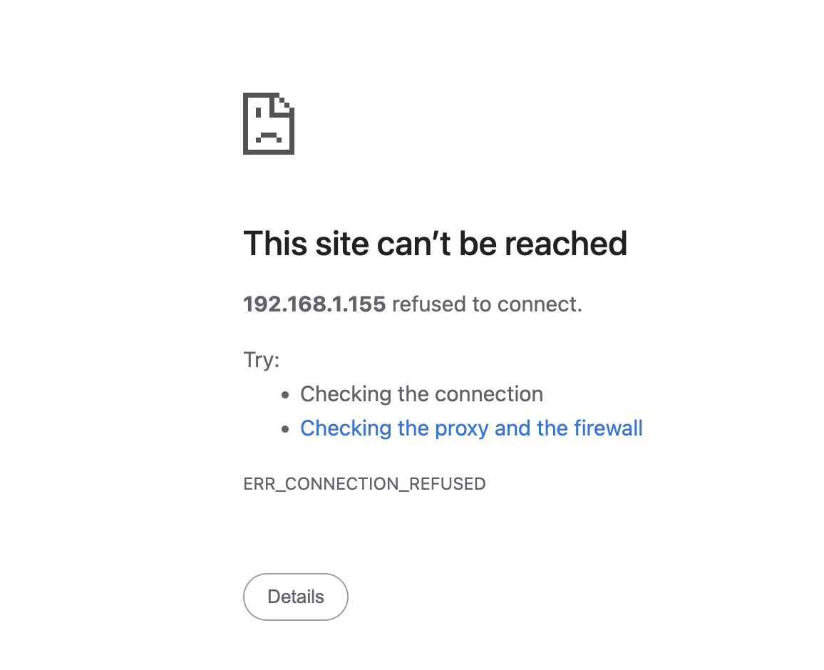

newby here, I been having a difficult time with dockers( radarr, sonarr, deluge and syncthing). everything worked well the first day then The next day it gave me a message "This site can’t be reached" I try downloading a reverse proxy and all failed. any help its greatly appreciated. thanks

Are you using the assigned port in the address?  192.168.1.155:####
That can be found in docker setting.
Also if you open it from within unraid using WebUI, that should get you there.  Also be sure the containers are running.

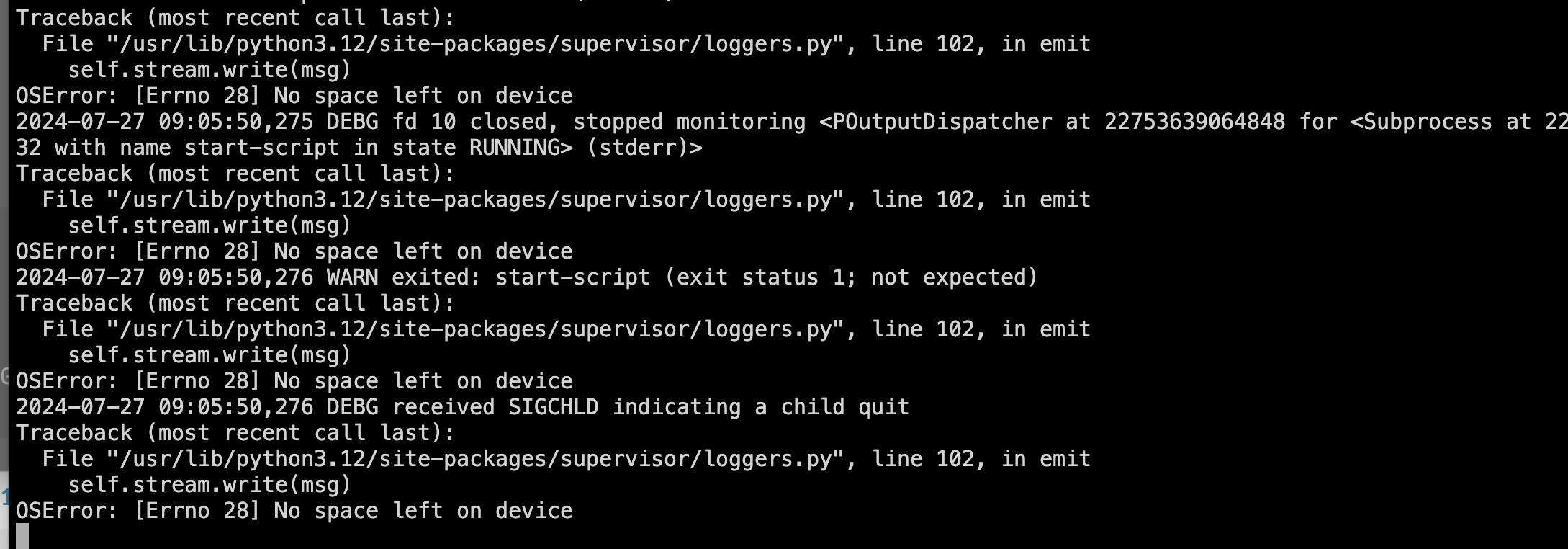

Everything seems to be in place, I'm using the right ports. When I use the WebUI is when I get that that message. Unless I can get to the docker another way? This is what I get on the logs. It seems that disk on is full. That's my bootable drive. I don't know how to change it.  I have 2  1TB storage that's not being used.
Your containers get mapped to /appdata.  Go to your shares section and check that is setup to use the disks you want.  Many people have it mapped to a cache drive as primary and the array as secondary.  You have to set it best for your needs, and it sounds like you need space.
