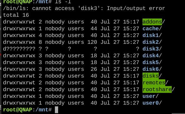

July 27, 20242 yr Hello, I have some issues with disk acting up. After a fresh reboot, I have no issues, but after a while one of my disks stops responding root@QNAP:/mnt# ls -l /bin/ls: cannot access 'disk3': Input/output error total 16 drwxrwxrwt 2 nobody users 40 Jul 27 15:17 addons/ drwxrwxrwx 1 nobody users 44 Jul 27 15:27 cache/ drwxrwxrwx 4 nobody users 40 Jul 27 15:27 disk1/ drwxrwxrwx 8 nobody users 120 Jul 27 15:27 disk2/ d????????? ? ? ? ? ? disk3/ drwxrwxrwx 3 nobody users 18 Jul 27 15:27 disk4/ drwxrwxrwx 3 nobody users 18 Jul 27 15:27 disk5/ drwxrwxrwx 3 nobody users 26 Jul 27 15:27 disk6/ drwxrwxrwt 2 nobody users 40 Jul 27 15:17 disks/ drwxrwxrwt 2 nobody users 40 Jul 27 15:17 remotes/ drwxrwxrwt 2 nobody users 40 Jul 27 15:17 rootshare/ drwxrwxrwx 1 nobody users 40 Jul 27 15:27 user/ drwxrwxrwx 1 nobody users 40 Jul 27 15:27 user0/ root@QNAP:/mnt# It's driving me crazy! Could anyone please help me resolve this? I will attach diagnostics qnap-diagnostics-20240727-1554.zip
