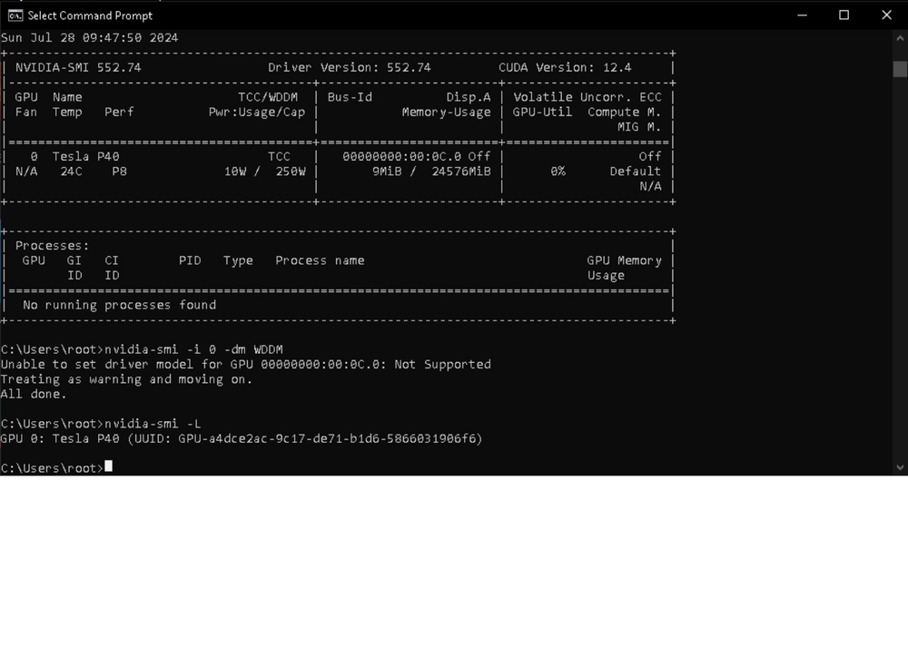

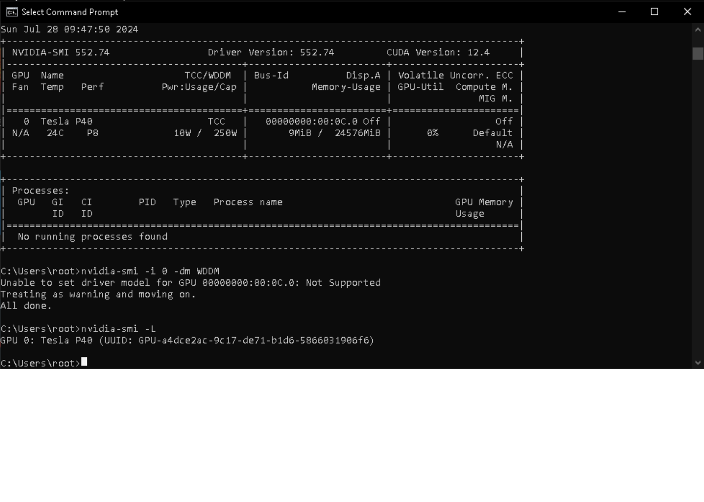

I have been going at this for awhile now. I can not get my p40 to switch from tcc to wddm in a VM I have. The Vm sees the gpu and I could use it as a compute card just fine. No method I have tried to change it from tcc to wddm works. I was wanting to make that card the primary card for that VM headless and then remote into it. Any help would be appreciated!

nvidia-smi -i 0 -dm WDDM

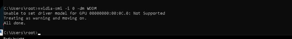

It came back as “option wddm is invalid for -dm” I am running windows 10 on the vm. I shouldn’t need a vgpu on unraid for it to work correct? Barebones and pass through shouldn’t require a vgpu driver to my understanding?

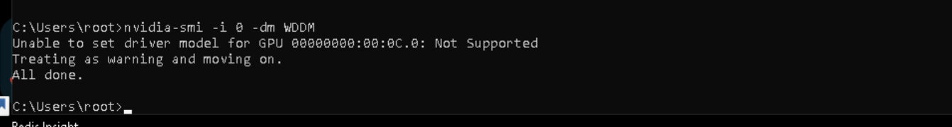

I didn’t realize it was case sensitive I ran it again and got this.

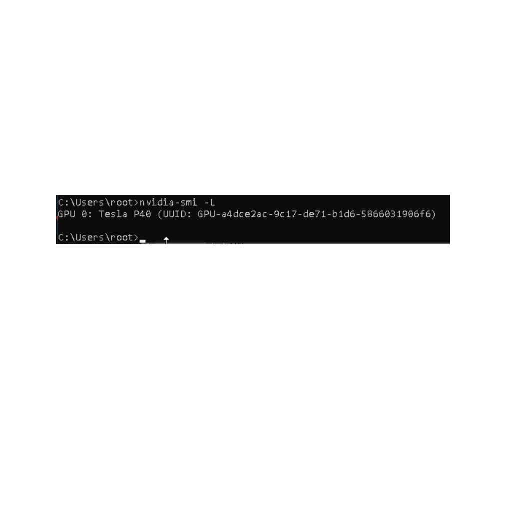

what does nvidia-smi -L provide?
It provides this

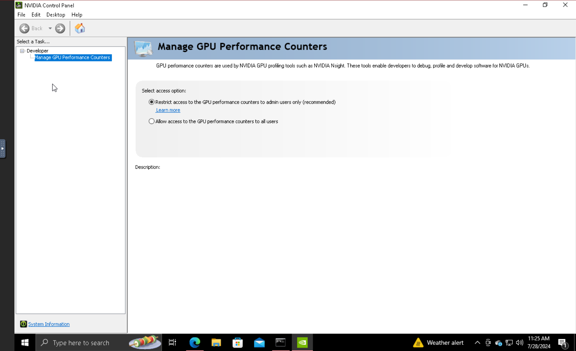

This is my control panel? I have no idea what could be going on.

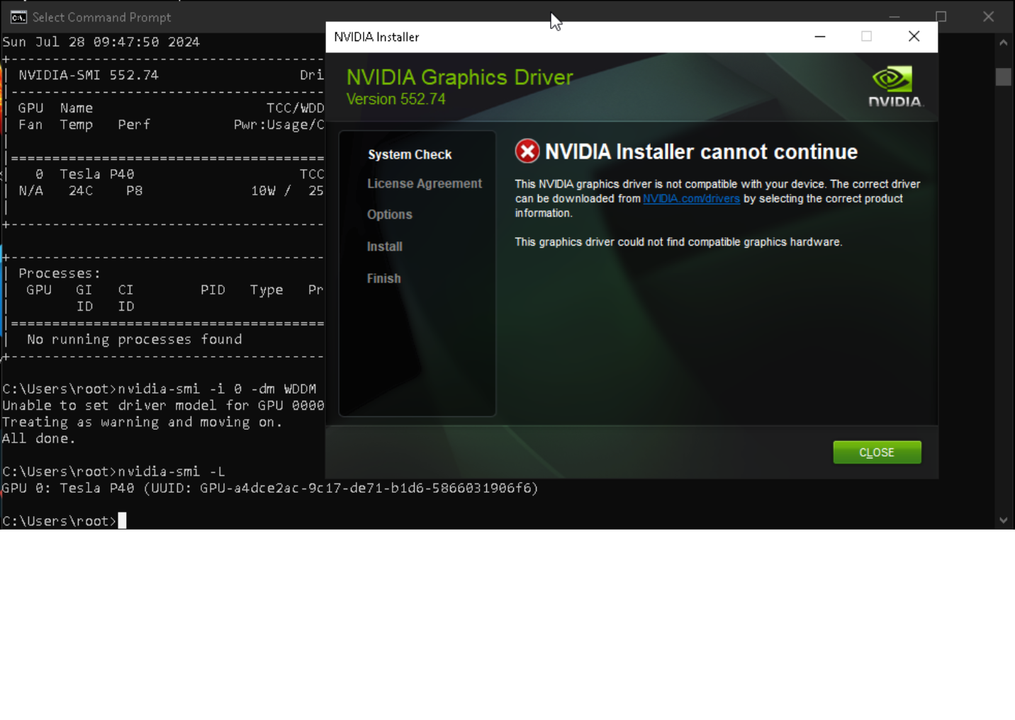

is vGPU drivers supported by unraid yet? Are you meaning like a GRID driver? I have GRID drivers that I have tried installing on the VM but it says my hardware is not compatible with the vGPU drivers?
I have tried the Data center driver as well as a quadro workstation driver as well; which will install but does the samething. This is what the GRID driver says.
