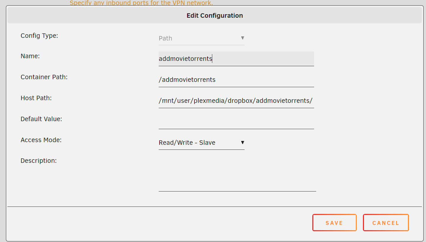

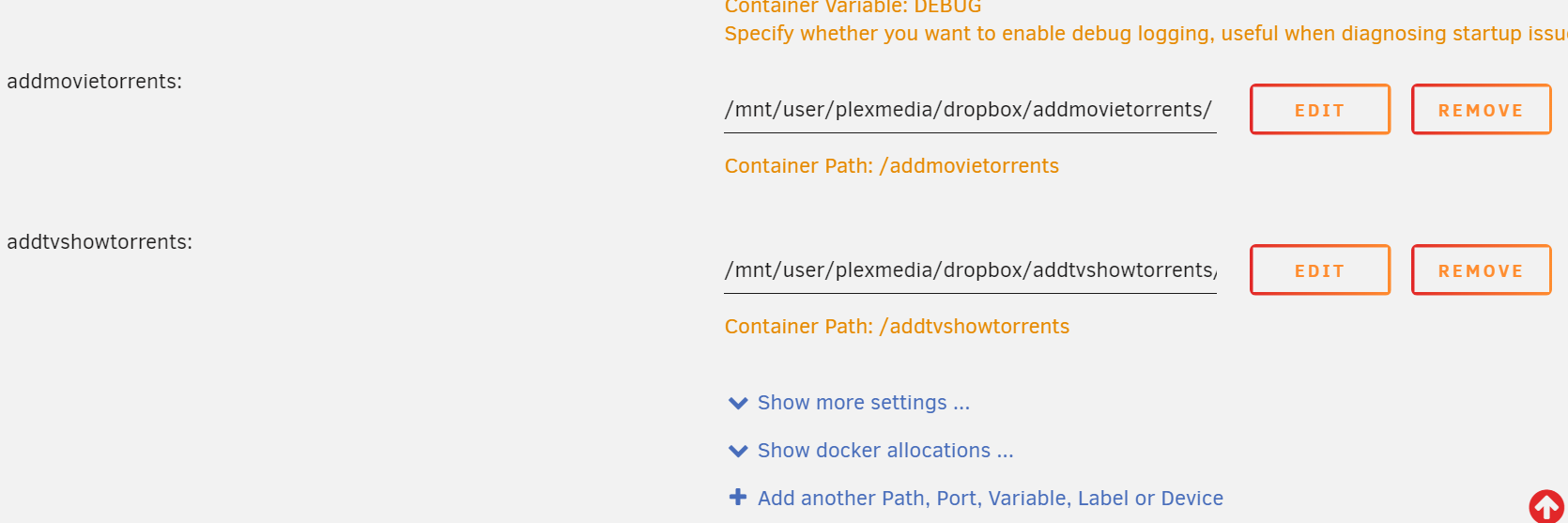

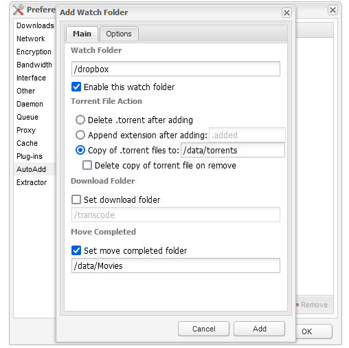

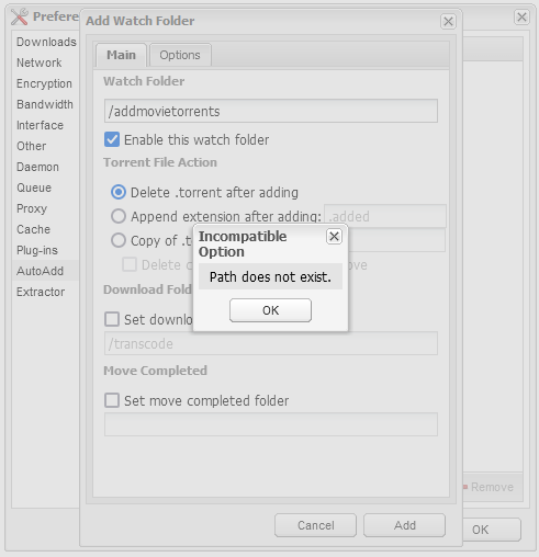

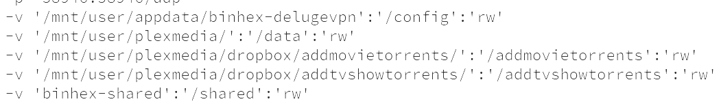

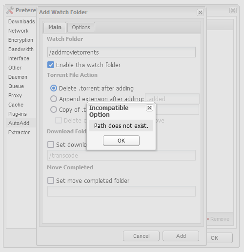

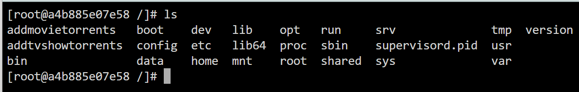

July 28, 20242 yr Hello, I am trying to setup deluge to watch folders that sync with dropbox. This will allow me to add torrents from my phone when I am mobile and my server will process them. Anyways, I have rclone all setup properly and dropbox syncing. I have added the folder paths to the deluge docker container. The issue is when I use the "AutoAdd" plugin inside of deluge the specific folder "addmovietorrents" does not exist. What is frustrating is that when I view the folder contents from a terminal (within the docker) it does exist. I have tried a combination of things including moving my rclone setup to a folder that already exists within deluge (this reports a read / write error instead of path does not exist). I don't understand why I can add almost every other folder without issue except any folder that rclone is syncing with. Any help is appreciated. See screenshots. docker folder setup docker output on creation deluge yelling at me docker terminal showing that the folder path does exist

July 28, 20242 yr Author I'm wondering if rclone is causing security issues and/or changing folder properties but my understanding of this falls a bit short. Example, I moved my rclone sync folder to exist within my plex library shares just because I KNOW that my docker has access to this folder (mnt/user/plexmedia). When I try to setup the "autoadd" feature in deluge I get an error saying I don't have write permissions to this folder instead of "path does not exist". I can read/write to the plex library just fine and the folders I am using in rclone are further down in the directory. This hints to me that rclone may be changing the folder properties?

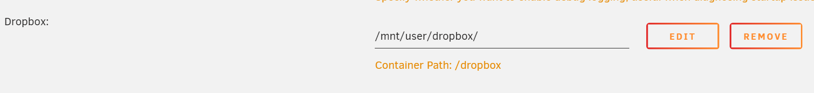

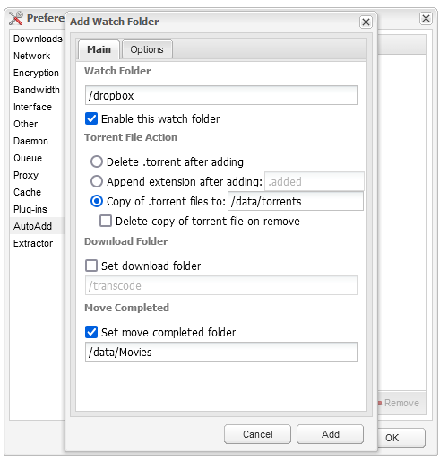

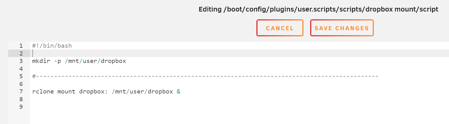

July 28, 20242 yr Author So I tried something else only for testing purposes and it did allow me to better understand what is going on but I still don't have a solution for fixing it.. I changed my docker share to reflect a folder that rclone is not syncing to (/mnt/user/dropbox/). I set the container path the reflect "/dropbox"; I then went into deluge and added the watch folder "/dropbox". When I click add it works as it is supposed to and adds the watch folder. This means that I am correctly setting up the docker (I am getting no error that path does not exist). I then go back to the user scripts plugin that I am using and change the script. I set it to point the rclone dropbox to mount to the file system under /mnt/user/dropbox (same directory that I originally set in deluge that worked). I run the script in the background and confirm via terminal that dropbox is working (it does). I then go back in deluge and remove the directory "/dropbox" (which is linked to /mnt/user/dropbox) and try to re add it again. I add it using the SAME EXACT DIRECTORY that I did previously. I get the error "path does not exist". This proves to me that rclone is changing something to the directory that prevents deluge from using / seeing it.

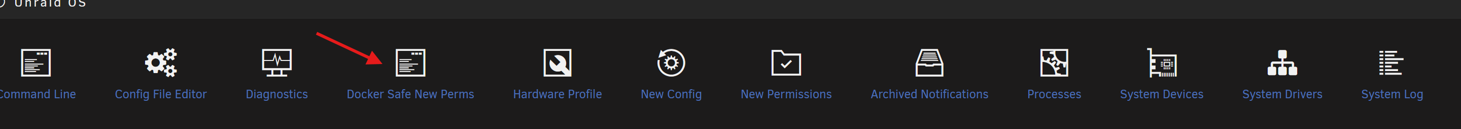

July 28, 20242 yr Community Expert Found the post: https://forums.unraid.net/topic/53807-support-binhex-radarr/?do=findComment&comment=1134701 Run the docker safe new permission tool on your the shares you mentioned first, then add the lines I mention in that post to your script and try again.

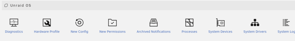

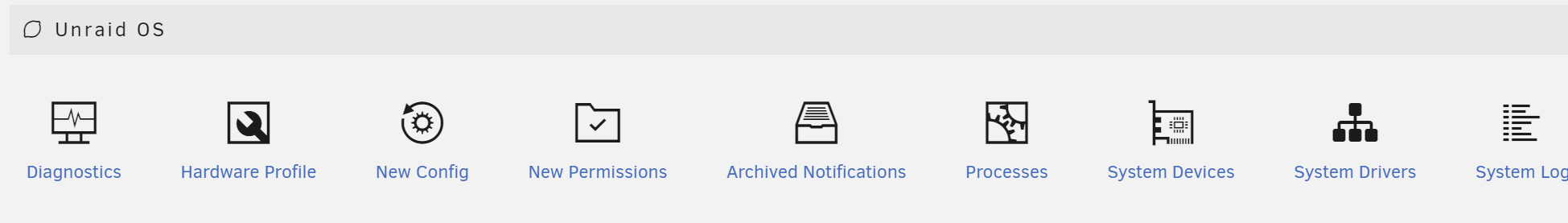

July 28, 20242 yr Author 2 hours ago, strike said: Found the post: https://forums.unraid.net/topic/53807-support-binhex-radarr/?do=findComment&comment=1134701 Run the docker safe new permission tool on your the shares you mentioned first, then add the lines I mention in that post to your script and try again. Sorry, I don't fully understand your post but am willing to try. I cannot find the "safe new permission tool". I can find a "new permissions tool" but want to confirm that is the same thing. Also, I don't understand the flags --uid 99 --gid 99. Would this be ran with my dropbox mount script? Sorry, entry-medium level user here rclone mount dropbox: /mnt/user/dropbox & --uid 99 --gid 99 Edited July 28, 20242 yr by AceEsCloud
July 28, 20242 yr Community Expert You don't have this one? It might be part of fix common problmes plugin I can't remember. I don't use rclone myself I just picked up that part about adding the uid/gid somewhere on the forum when somebody had permissions issues. But yeah you out that in your rclone mounting script.
July 28, 20242 yr Author thanks for the help but the --uid / gid flags are not found, I am trying to find out if there is a way to add these flags. That post does help with me understanding the issue a bit more though (if I am moving in the right direction). The more and more I look at it the more I believe it is a file permissions issue. they state that the rclone plugin maybe running on root so I would assume this would change file permissions. I'll keep searching...
July 28, 20242 yr Community Expert Do you have the fix common problems plugin installed? If not try to install that and check if it pops up.
July 29, 20242 yr Author So I got it working. I added --allow-other to my array startup script (listed below). This also did not fix it but I went back to my container settings for deluge and changed the Console shell command to "shell". I did this on a lucky guess because I could see the files in the sh terminal. I wish I fully understood the difference here but it is now working. mkdir -p /mnt/user/dropbox #----------------------------------------------------------------------------------------------- rclone mount dropbox: /mnt/user/dropbox --allow-other &
