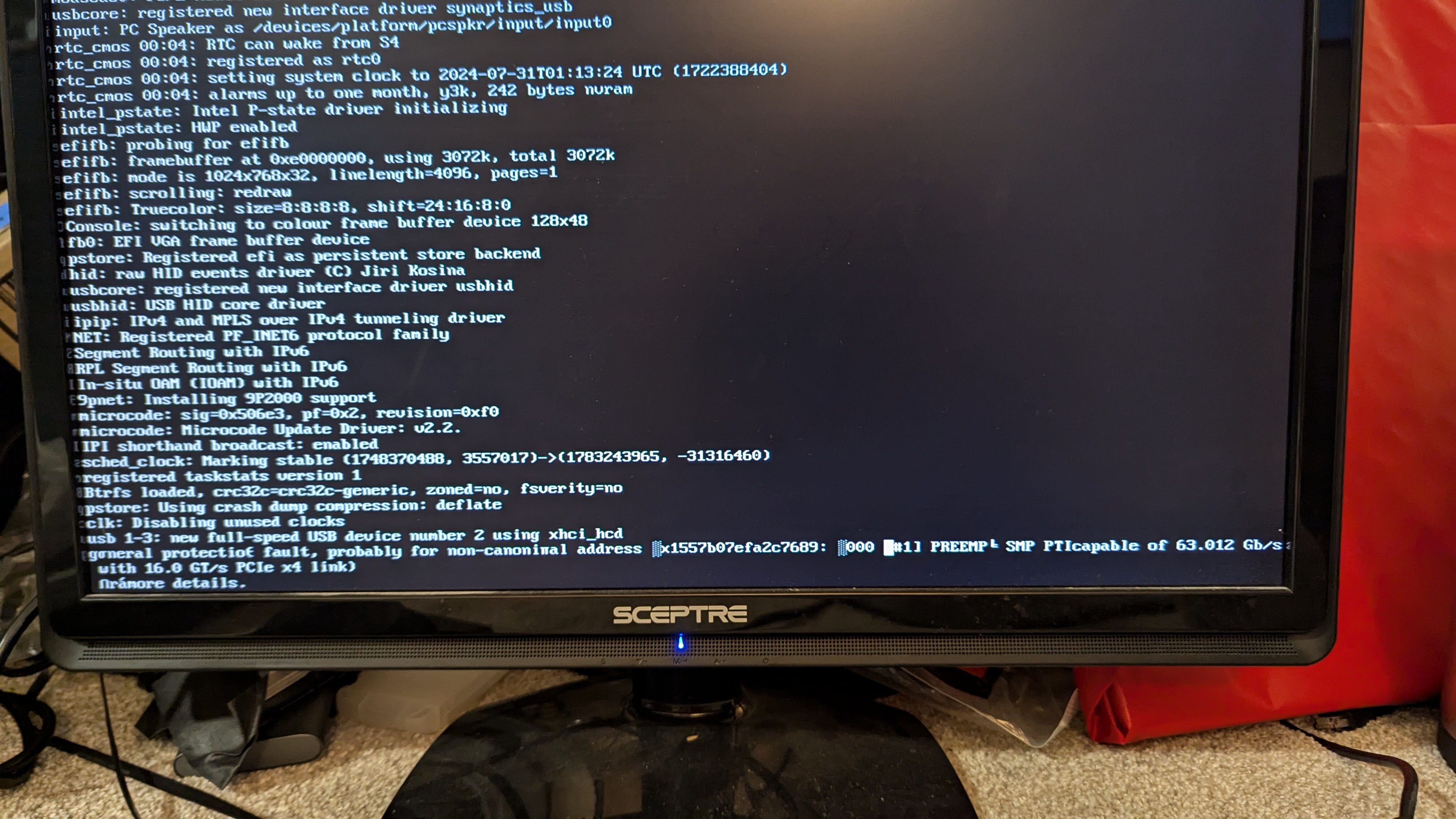

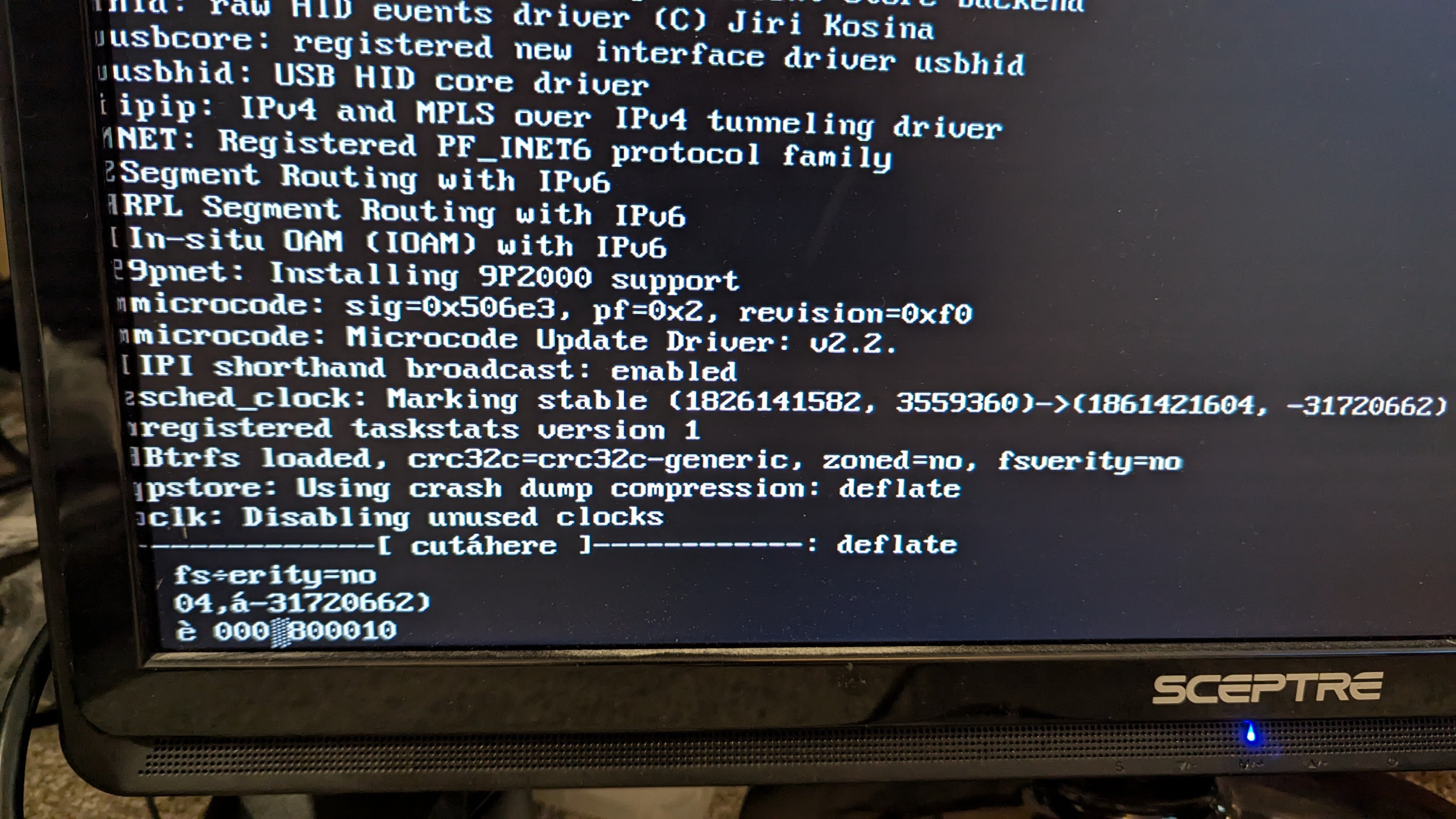

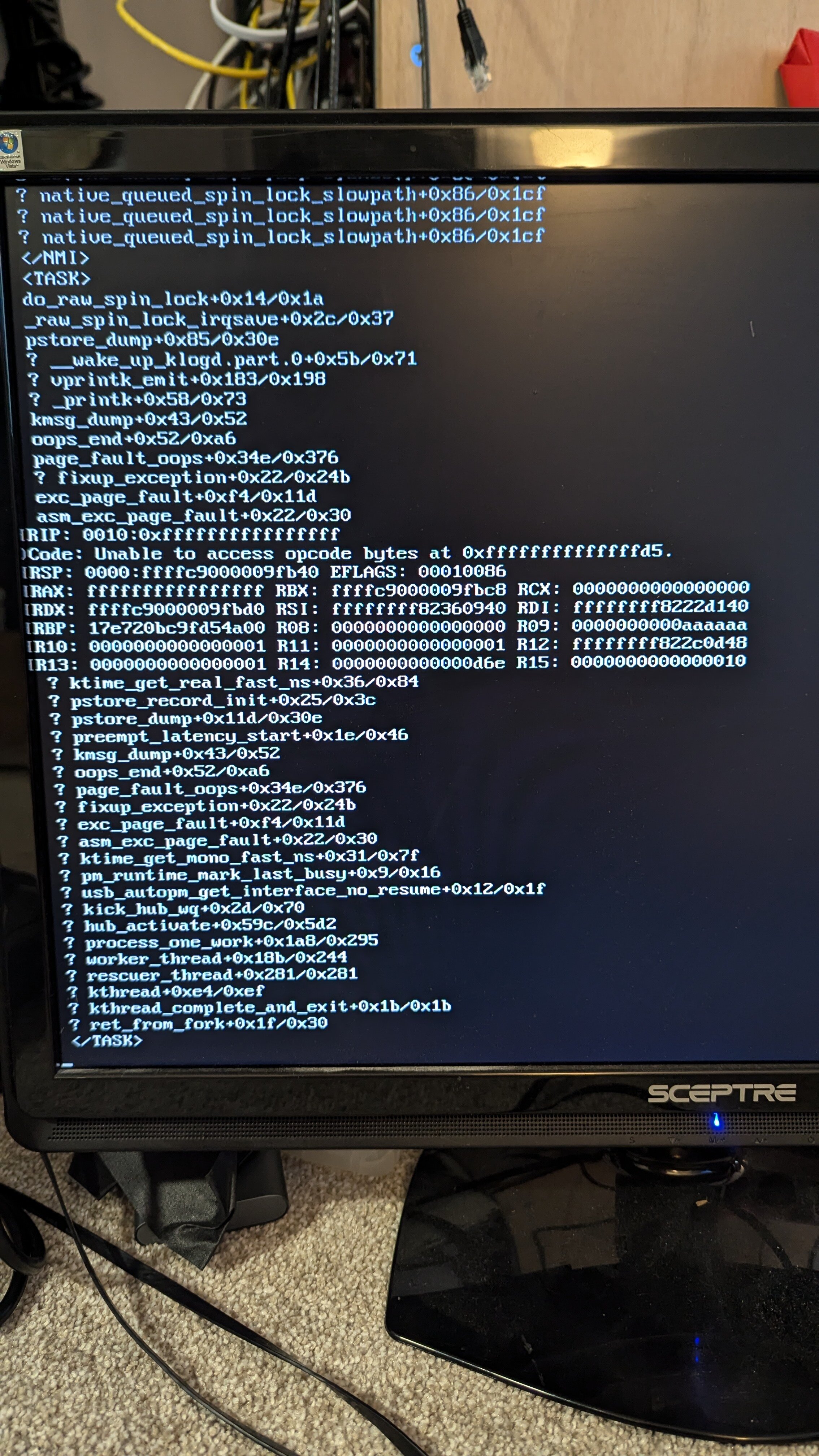

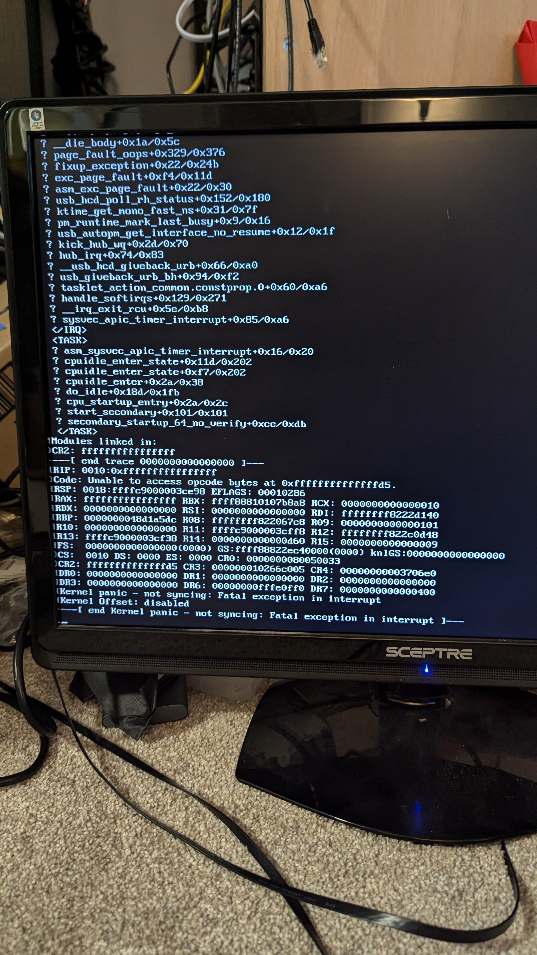

July 31, 20242 yr Author I have a update that is probably not good, but I would like to hear what others think. I have been running memtest for 48 hours. Zero errors were found. I then tried to boot into unraid, but now I unraid wont even load. Normal, or safemode. And it seems to do it in a different place when it tries to boot. I tried this around 10 times today. So I cant turn on syslog like @JorgeB recommended. I have also noticed that on the monitor I've attached to my server for troubleshooting, when it stops booting, the text at the end seems to get slightly corrupted. I've attached photos showing that, and some of the other screens that its shown when its died. I've also tried removing ram sticks, and swapping them in case there is a faulty stick, but that hasn't seemed to change anything. Questions: 1. Could my CPU be going bad/failed? Or is ram still the most likely issue. 2. Is there anyway check the integrity of my usb drive? I could do this on windows, or linux (if someone could walk me through that process). I managed to pull a usb backup before this went REALLY down hill. But I would also guess if that was the case, it would probably fail to boot in a more reputable way and not seemingly randomly? 3. If this is a hardware failure, I'm probably just going to upgrade my system with a new motherboard, cpu, and ram. Unraid and the dockers it runs have become a thing that I am now using so often that its extremely inconvenient to loose access to it. Should I look into a system that supports ECC ram? Is that worth it? Any other ideas before I start shooting the parts cannon at the problem? Edited July 31, 20242 yr by indianazoidberg Added another image
July 31, 20242 yr Community Expert You can try booting with a new flash drive using a stock install, no key needed, if it also fails it will confirm a hardware issue.
July 31, 20242 yr Author 2 hours ago, JorgeB said: You can try booting with a new flash drive using a stock install, no key needed, if it also fails it will confirm a hardware issue. Okay. And that won't fuck anything up in that long term?
August 1, 20242 yr Author 16 hours ago, JorgeB said: You can try booting with a new flash drive using a stock install, no key needed, if it also fails it will confirm a hardware issue. Just tried this a few times. Still won't boot. I guess I will use this as an opportunity for an upgrade. Just sooner than I thought. I'm just going to get a new motherboard, CPU, and RAM. I'm going with the assumption that my PSUs, HBA, and backplane are all still working (the HBA shows drives connected to it on boot, and its showing everything I believe)
