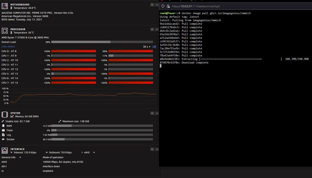

  • Just wanted to update - Anytime I have a container that fails to update "normally", I just run the docker pull command and it works.  May take a while, but it works so far every time.

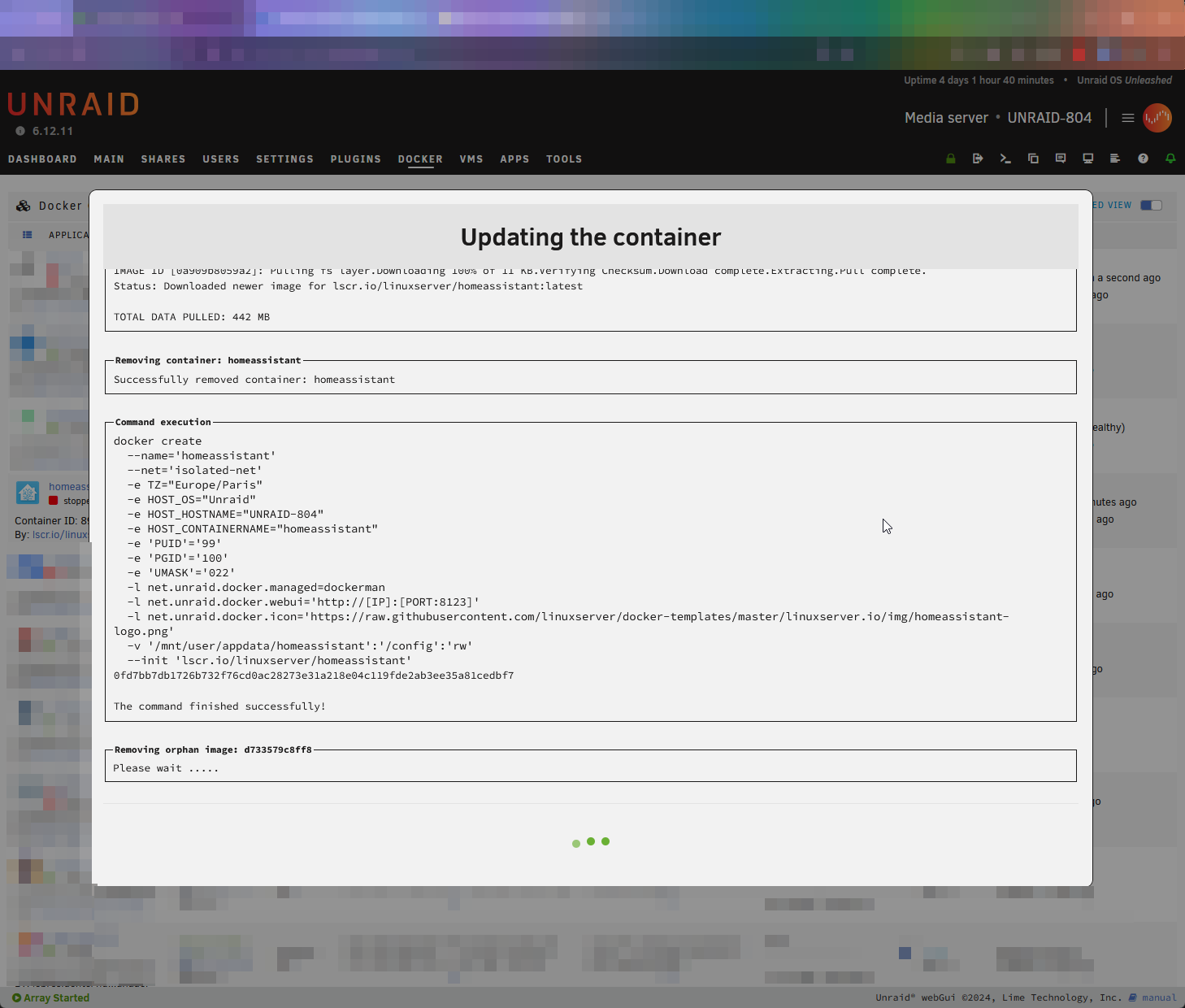

I tried adding --init to the last container that has the problem at the moment, but it actually doesn't start at all with it : ( lscr.io/linuxserver/homeassistant )
s6-overlay-suexec: fatal: can only run as pid 1
** Press ANY KEY to close this window **

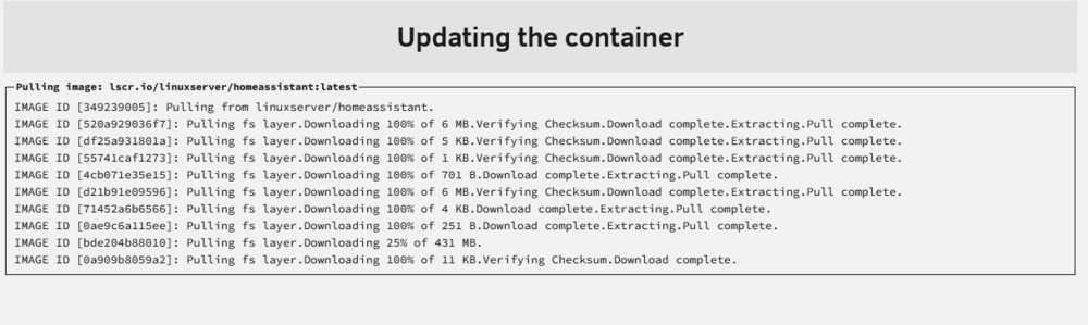

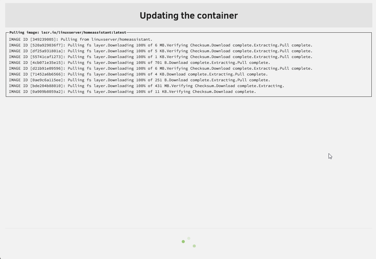

Anyway, the docker is stopped right now, with a pending known update : image.thumb.png.750ac72f8afde85fda0be8ff70a00c59.png
That hangs at this stage... :
And woah, it actually worked this time. Without the --init line just for confirmation.
Is there any way to help any further ? I tried updating this specific container about a dozen times, I have no more pending update at the moment.

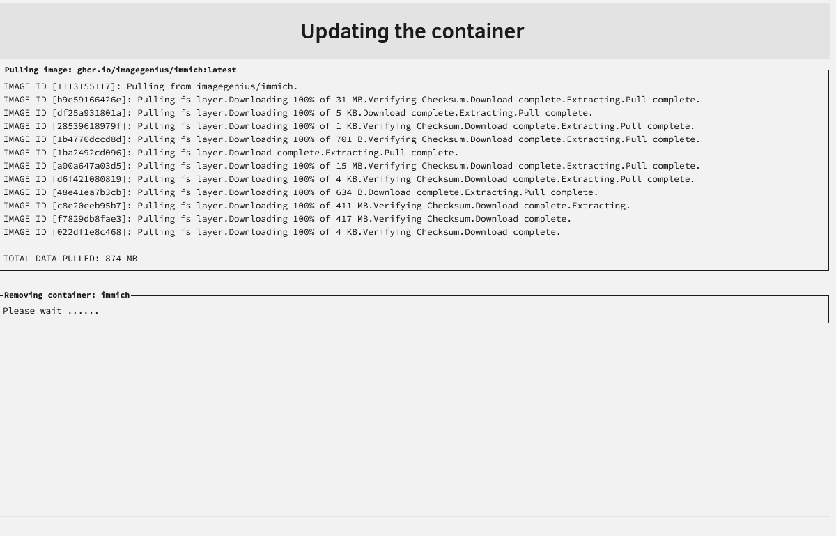

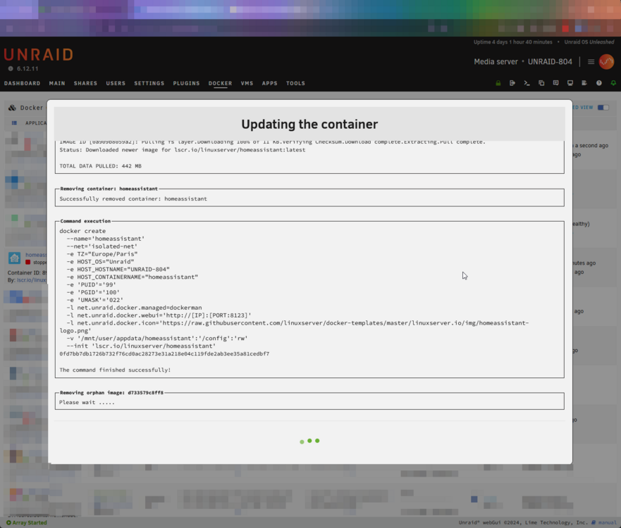

So, with these settings and immich docker stopped & waiting for upgrade, i did push the upgrade, which stayed stuck as following for a couple minuts : image.thumb.png.4405ad50e8578cf1120f5e030f116ce4.png
After which it tried to start the docker, ending in the following situation : image.thumb.png.f671e5175d553310c2c4923a39401666.png
My docker setup has no Extra parameter or post arguments, only --init for this test.

Correct indeed, the immich docker was still in the old version, the new update didn't correctly apply.
