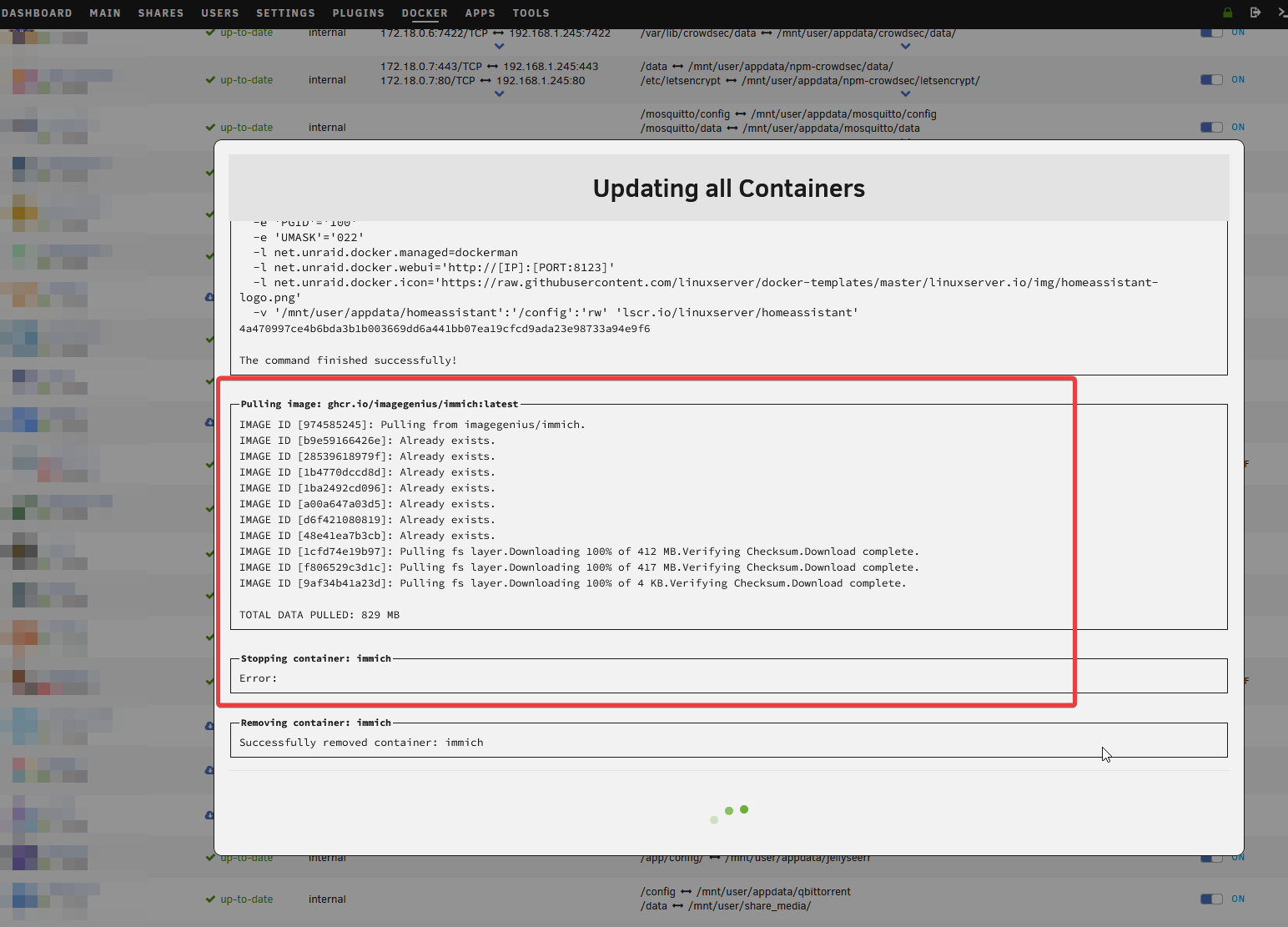

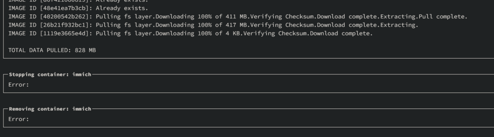

Okay, problem was getting really annoying, so i'm plunging a little further in Docker domain.
I activated Docker Daemon debug, and now scroll through

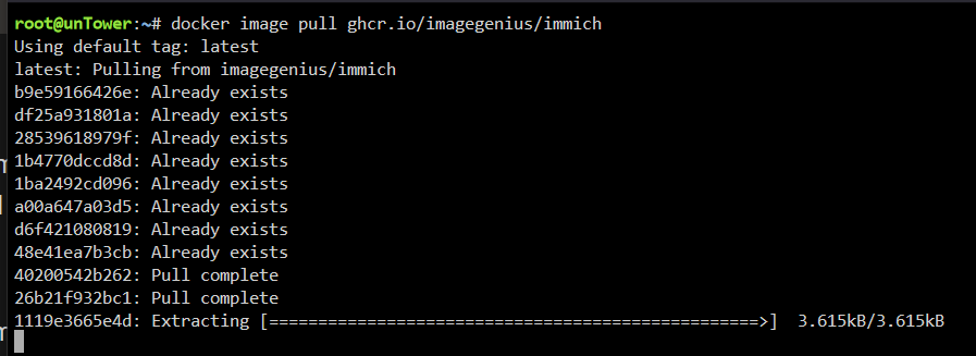

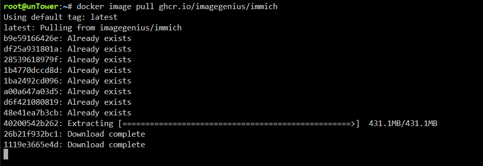

/var/log/docker.log
after manually doing a
docker image pull ghcr.io/imagegenius/immich
in an unraid bash.
I see the extraction process is quite long, and when examining the log, it seems it need more than 5 minutes to finish extracting the image components. Hence the 300s timeout on docker gui / php commands not being enough I guess. Anyway, once the image is "correctly" pulled through bash without any timeout, unraid then obviously uses the already correctly pulled image through the GUI.
In order to know a bit more about this issue, I am trying again to do a reproductible docker image pull on a bigger (5gb) but simpler image, slightlytyler/large-image-test, that is currently ticking at 15+ mn and still extracting, hoping I would find something interesting in docker logs.
I'll post curated logs if anything interesting arises.

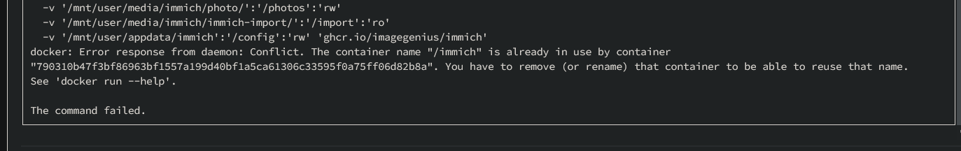

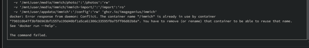

I tried to update immich today with only the time out set to 300 (did not use the init flag and it also failed for me.
Looks as thou the larger img pull did not complete

I needed 5+ mins to pull the immich image a couple days ago.
For me (check the exact image you use!) that'd be :
Unraid bash +
... wait
Then safely clic "Update" on the Docker unraid GUI, the image being already present, she'll get used in a snap.

Hey - thanks for the tip.  I tried it and it did work.
Very strange how it hangs at certain points (above and below) for an extended period
but it does complete and then can update from GUI
I tired running pull from CLI on paperless-ngx, which I was also having problems updating and it worked here also
Again, it took an extended period, but it did work

Ah yes, there might be something I begin to see :
When I was on a Docker directory (and not an ISO), and while there was a slow pull running, I think I remember the Unraid Web UI was still responsive, I could browse it without any issue. Still, any Docker container was practically halted until the pull was complete.
Now that I am back on a BTRFS Docker ISO, it seems the whole Unraid UI (not just docker containers) is systematically unresponsive when this slow docker pull is pending.
Take this specific point with a grain of salt, I still have to confirm it's systematic, but it might be symptomatic of a specific process, who knows.

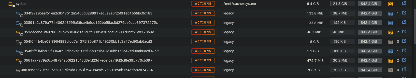

I did notice something unusual,  This was under ZFS Master tab.  There are approximately 170 entries like this
Are these the orphaned images?
(I am not as technically savvy as the two of you)

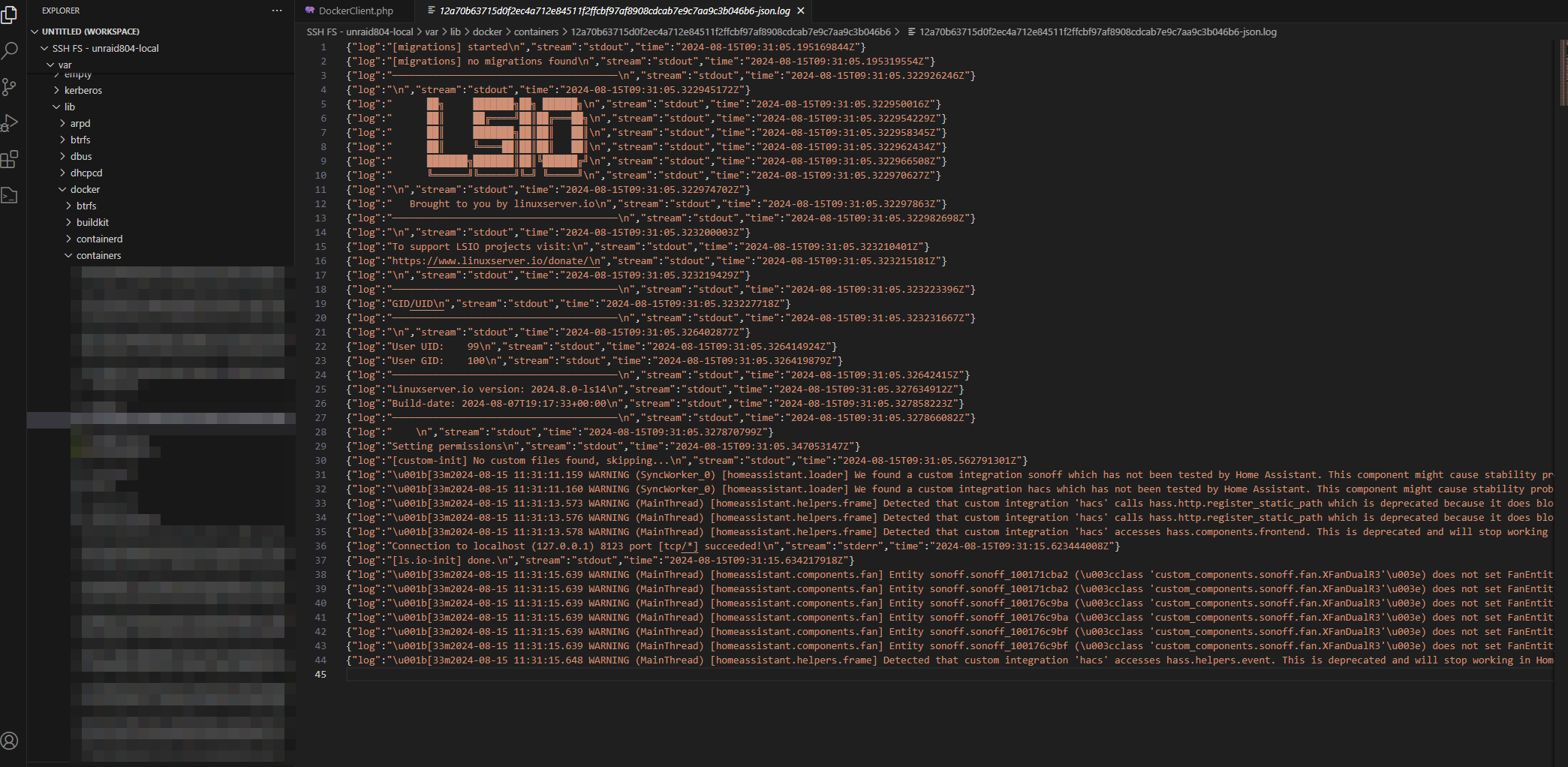

Well, nothing really interesting since the docker log starts when the container itself starts, and it starts nicely, excepted it's on the "old" undecomissionned image
Homeassistant for instance
I will re activate docker daemon debug logs, run the upgrade test through GUI and post curated log here.
Okay, so...
I activated the docker daemon debug again, and ran :
- A tentative to update 3 pending dockers through the GUI, while running a tail -f docker.log on a screen, and captured the process with a timewatch besides the GUI,
- As the update didn't stick, I ran a docker image pull of 1 of the 3 images that didn't run, waited... and then updated the container through the GUI,
All this while screen filming the whole process

Some timestamps... :
6:30 : Finished manual GUI update tentative
7:20 : docker image pull of a previously unsuccessful update
10:09 : First "big" missing layer successfully downloaded extracted etc
12:48 : Second missing layer successful & end of image pull
13:00 : "Update" container (to latest image) through GUI
As stated above, I'm sending you this video through PM in a couple seconds
