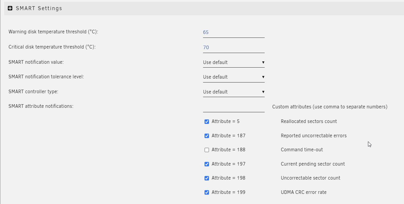

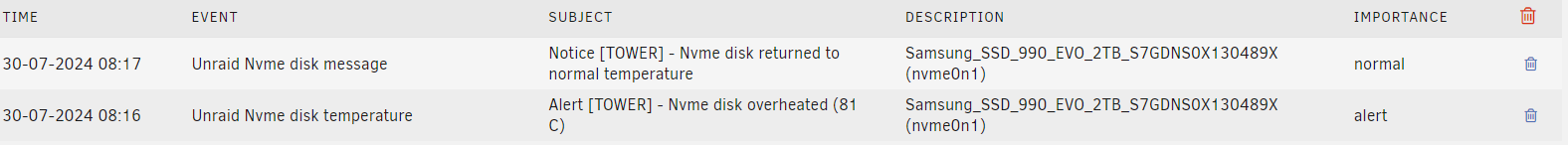

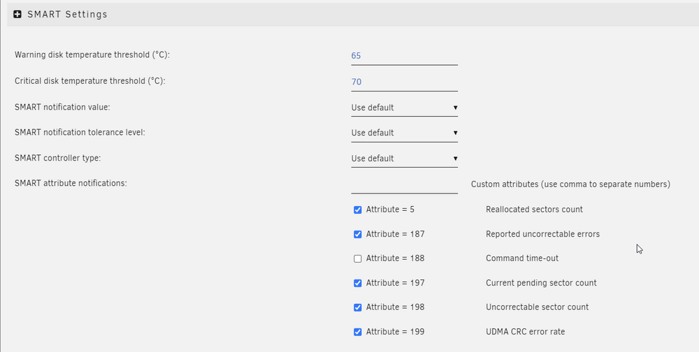

July 30, 20242 yr I keep getting warnings like this: But the NVMe is almost always low temps: SMART Settings: During load it reaches 55C and I have never seen it above. I already have a heatsink on. Is there something I adjust to prevent this warning all the time? Edited July 30, 20242 yr by mrbusiness
July 30, 20242 yr Community Expert Solution just edit the warning level for this disk. NVMes can safely run up 70°, error would be >85°. The next version of unraid will contain seperate warning settings for normal hard drives and SSDs (with a much higher default).
July 30, 20242 yr Community Expert I believe there is a firmware bug in those drives where it it can intermittently report and abnormally high temperature so it may be worth check to see if there is a firmware update.
