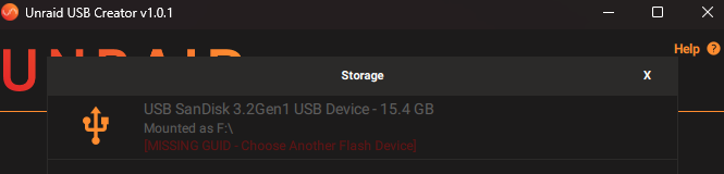

July 30, 20241 yr I'm currently trying to replace my super big USB Stick with a small one, so I chose from Spaceinvader One's video, the SanDisk 64 Go Ultra Fit, USB 3.2 one, to be more precise. Using the Unraid USB Creator tool, I found out that is has no GUID. Is there anything I can do to use it? Have I ordered a fake stick? (even though it was ordered from Amazon, sold by Amazon) Thanks! Edited July 30, 20241 yr by gvrx Spelling
July 30, 20241 yr Community Expert Solution There's a known issue with the new tool and some flash drives, you can do a manual install: https://docs.unraid.net/unraid-os/getting-started/manual-install-method/
July 30, 20241 yr Author 54 minutes ago, JorgeB said: There's a known issue with the new tool and some flash drives, you can do a manual install: https://docs.unraid.net/unraid-os/getting-started/manual-install-method/ That worked flawlessly! Thank you for the quick response, and thank you to the Unraid community! Cheers!
November 20, 20241 yr I am having the same problem, scared me a bit: Followed @JorgeB post, hope all goes well, when I plug it in the server.
January 24, 20251 yr I have the same problem. When I first opened the creator tool, the usb stick was shown with GUID and everything was fine. I didn't flash it and restarted the program later. Then the same stick, without disconnecting it between the two program starts, was shown with MISSING GUID. From there on, I never got the Stick to work again with the creator tool. Changing USB-Port, restarting the PC, reinstalling the software, nothing helped. It's a shame, that they can not make it work correctly.
January 25, 20251 yr Community Expert 11 hours ago, Flow_Grisu said: From there on, I never got the Stick to work again with the creator tool. You can use the manual method: https://docs.unraid.net/unraid-os/getting-started/manual-install-method/
