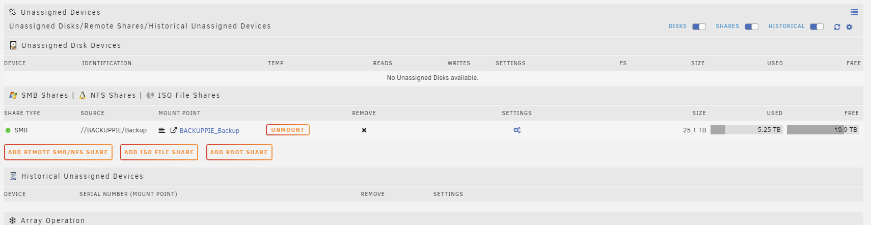

The machine is a backup UnRAID server from my main UnRAID server, and through SMB via unassigned devices they are connected and with Krusader I copy files to the backupserver. This also often throws errors. Cannot copy the file. I have added the logs, maybe you can help me troubleshooting.

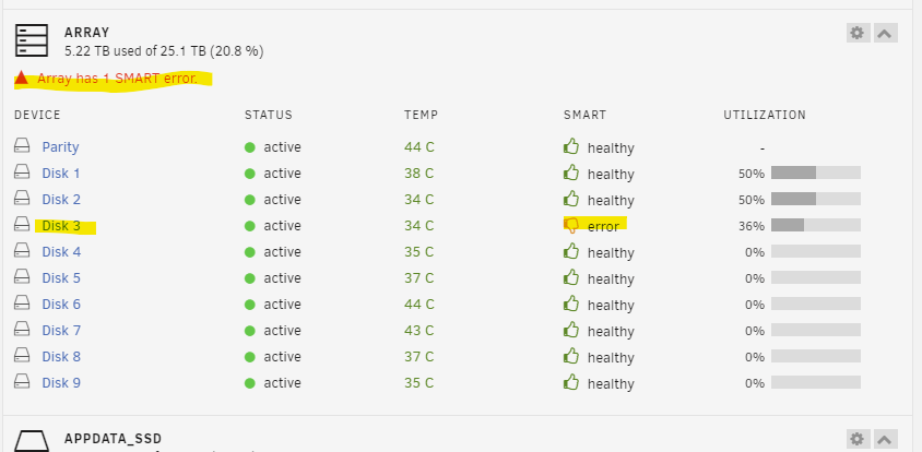

FYI: The server that we are talking about exist of old HDD's which I already needed to remove 2 x4TB because of errors. Now I see another drive is giving errors. This is not related to the webUI issue, but just informative.

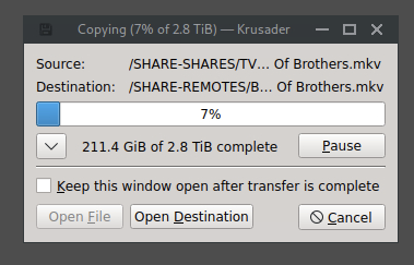

Copying happens through Krusader. SMB share from Unraid MAIN to 'Backuppie' makes the connection, and I reach out to that share through Krusader and this is how I copy the files for backup.

SMART if flagging the UDMA CRC errors, that is usually a SATA cable problem, you can click on the thumbs down and acknowledge the current errors, if more appear replace the SATA cable
Yes, I agree, but the server has a backplane, and I moved it to another slot, and it still shows errors. I don't think it is the backplane or the cables. The backplane has 4 cables going to the HBA, the drive is really on a part of the backplane with another cable.

CRC errors are never reset, but as long as they don't keep increasing the problem is resolved.

In the meantime, the main unraid server, is copying movies via Krusader, over an Unassigned Devices share between the unraid main and backup server.

Krusader also throws an error that it cannot copy files, so that stalled. Retry on the copy does not work.
