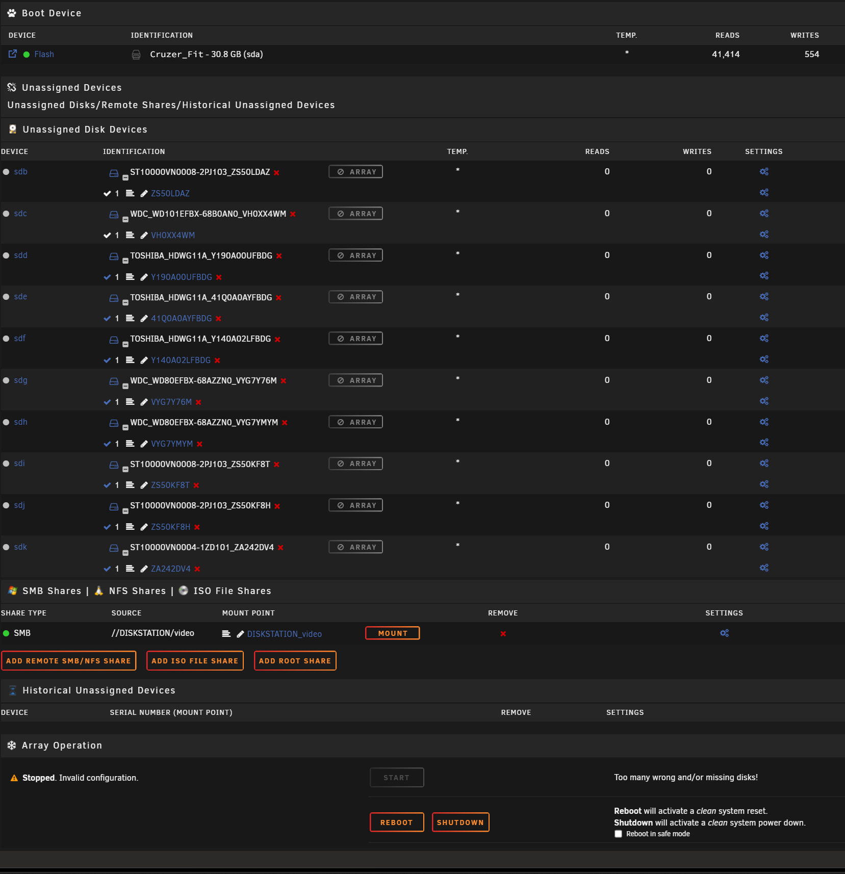

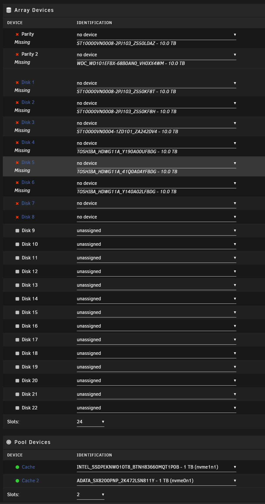

July 31, 20242 yr Wondering if I can get some help here. I believe I have a cabling or controller issue. The drives when parity is being checked are incorrectly being labelled with errors and then going offline. Now 2 of my drives have gone down, and Unraid has removed all of the disks from the array. Luckily I still have the drive order saved, but I don't know how to add them back to the array without losing data since they are all removed. Here is the current state: What is the correct procedure to rebuild the array without data loss? Do I go under New Config and add the drives? Do I use "Use the 'Preserve current assignments' selection to populate the desired disk slots after the array has been reset."? I'm scared to lose data and have a rebuild, so I will wait on a response if anyone can lend a hand. I have logs/diagnostics as well if needed. Thanks!
