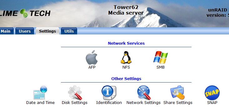

The icon points to http://tower/Settings/snap

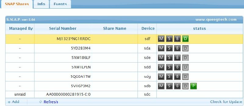

Build 5.04
The next build of SNAP-5.0-1 is launched.  Anyone who already installed SNAP 5.0 can use the "Check for Update" button to upgrade.  Any new comers will get the new build.
This link is still where to get the plugin file for initial installation.
http://lime-technology.com/forum/index.php?topic=18046.msg162098#msg162098

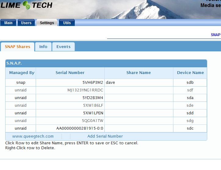

Towersnap_-_Google_Chrome_2012-02-14_22-37-46.jpg.07ed8b19ad038707275673190ac50f14.jpg
HI queeg
one last bug to correct ;)
had it already in the previous version and i assume you don't have Samsung drives otherwise you would have noticed
These drives are "owned"by unraid ...  you can see them below ...  i guess you need to escape the first characters .... not sure if there is a pattern
for the rest seems all working for me
HI queeg
Please run this at the command line and reply back the output.  I have seagate, hitachi and WD but no samsung.
ls -l /dev/disk/by-id/*9163
root@p5bplus:~# ls -l /dev/disk/by-id/*9163
lrwxrwxrwx 1 root root 9 2012-02-12 15:14 /dev/disk/by-id/ata-SAMSUNG_HD204UI_S2H7J9BB209163 -> ../../sdi
lrwxrwxrwx 1 root root 9 2012-02-12 15:14 /dev/disk/by-id/scsi-SATA_SAMSUNG_HD204UIS2H7J9BB209163 -> ../../sdi
hope this helps
hope this helps
Whoa!  Samsung drives get two device entries with different serial numbers.  unRAID uses the shorter one,  the "ata" one.  I'll fix it in the next build which will be 5.05.
ata: S2H7J9BB209163
scsi-SATA: HD204UIS2H7J9BB209163
