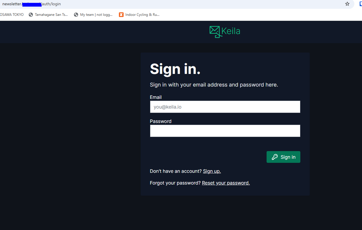

August 1, 20242 yr Summary: Support Thread for Keila Docker Application: Keila DockerHub: https://hub.docker.com/r/pentacent/keila This template has been tested on a production machine but not extensively. If you find any errors with the template please post here so that I can fix them. If you need some support or guidance also write here. If you find errors in the app itself then please contact the developer through their issues page: https://github.com/pentacent/keila/issues The password is auto generated on first boot and can be found in the log. You can change it afterwards. Edited August 2, 20242 yr by gxs
