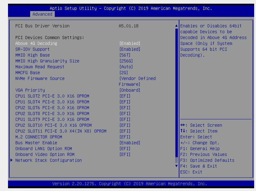

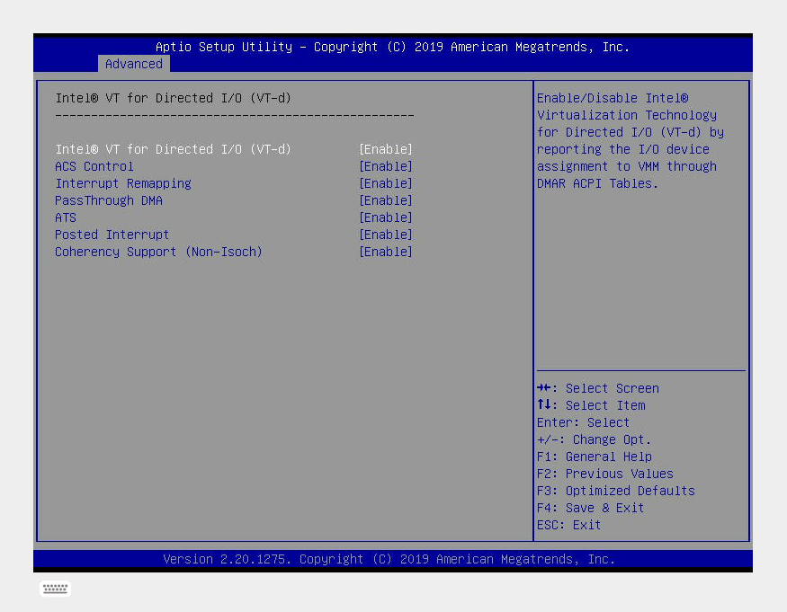

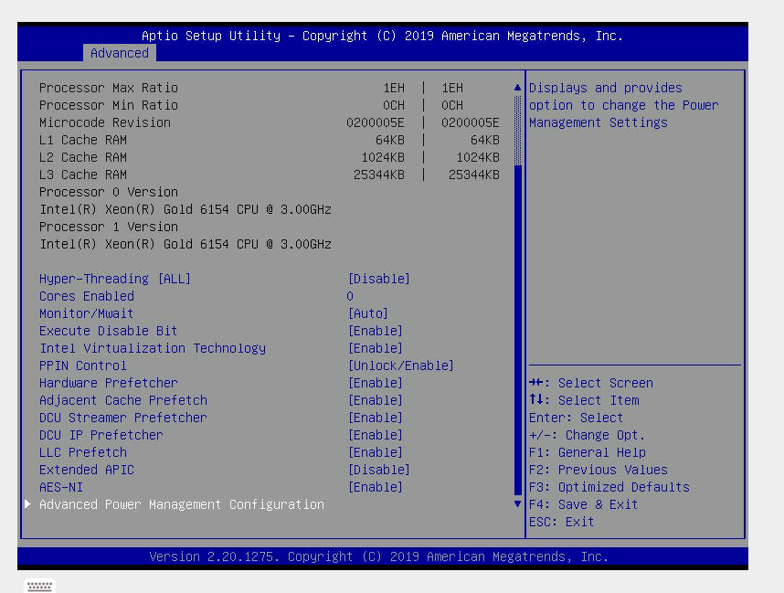

Here are snips from bios
After some experiments disabling "Above 4G Decoding" seem to have been the solution.
*After some troubleshooting its because the os is mapping too small / or can't map memory addresses for the pci devices (its unresolved bug), and when kvm is triggered to take ownership of the pcie port its trying to bind that device pcie memory rebar first it fails to acquire the lock resulting in infinite wait nothing - and person who wrote it didn't add any tagging for logs at this step (to log timeouts or end the process, resulting in infinite wait for memory address that it won't be able to bind anyway) i haven't gone too deep into the stack but it might be something with certain systems using 64bit mmio root bus the os fails to assign correct addresses.
supposedly this is a fix but... it likely doesn't work.

I dislike it the solution of just disabling BAR pci- so i'll keep searching.
Next tries:
pcihole64 to adjust rebar size given by the bios to the pcie device.
<controller type='pci' index='0' model='pcie-root'> 894- <pcihole64 unit='KiB'>0</pcihole64> 936- </controller>
