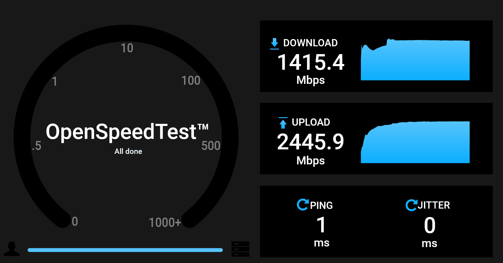

August 8, 20242 yr Author 10 hours ago, JorgeB said: Unfortunately there's nothing relevant logged, this can be a hardware issue, one thing you can try is to boot the server in safe mode with all docker containers/VMs disabled, let it run as a basic NAS for a few days, if it still crashes it's likely a hardware problem, if it doesn't start turning on the other services one by one. Hmm... makes me wonder if its the Realtek 2.5Gbps USB NIC I'm using... it always seems to choke when theres a lot hitting the 'net'. Like I'll lose the ability to connect, but the hard drives will still show activity.
August 9, 20242 yr Author Yeah, there might be something up with the Realtek r8152 NIC Driver on Unraid 7 beta 2's kernel. I suppose I'll wait and see. Thank you again both of you, for getting back to me on this. Its very much appreciated.
