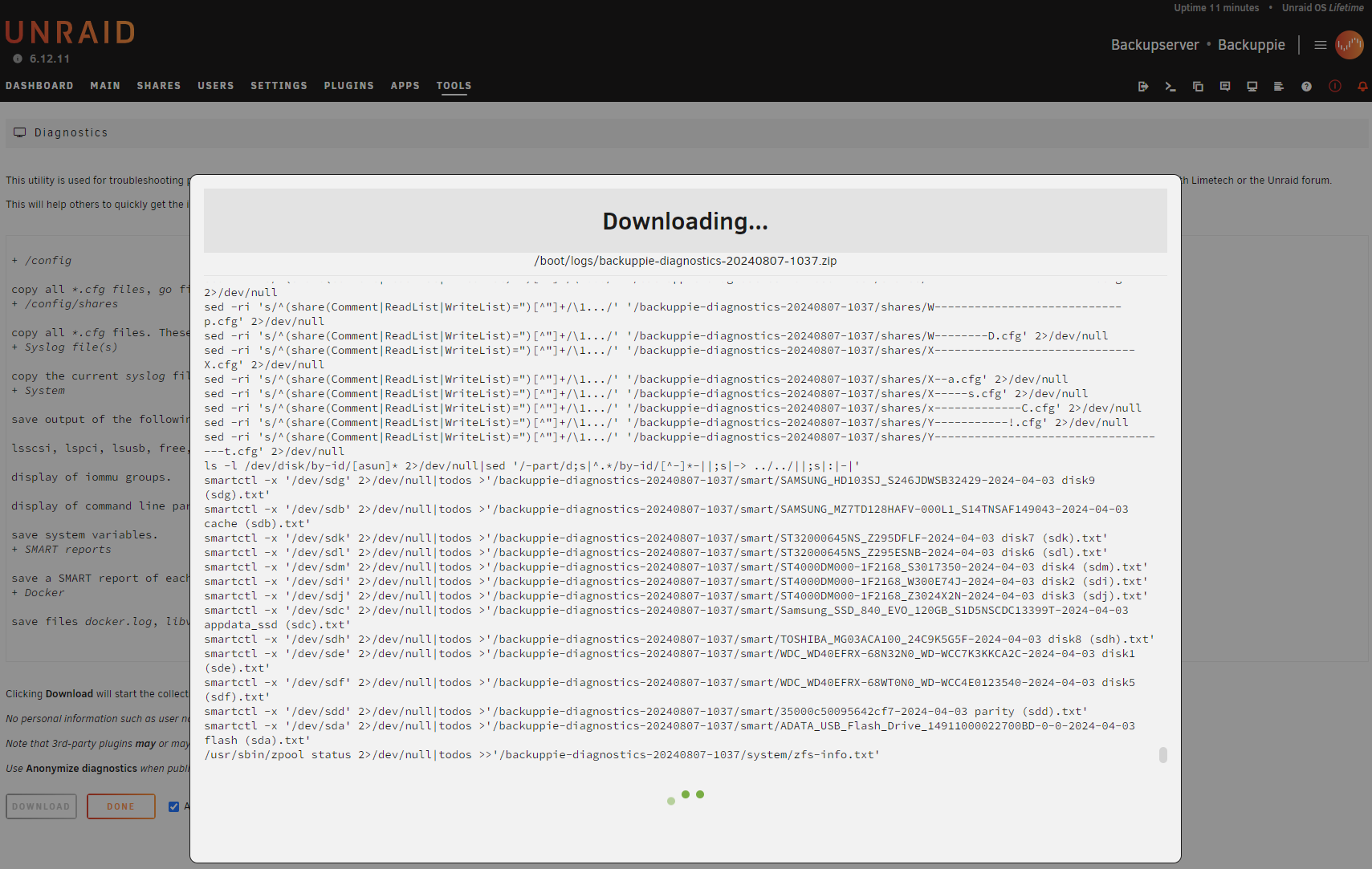

Hi all,
My recently build Backup UnRAID server is stuck on mounting disks now. I don't know what is going on with this machine but it is unstable AF.
I cannot even add the diagnostics, because ZFS Status does not continue.
Anyone an idea what to do?
Thanks.
