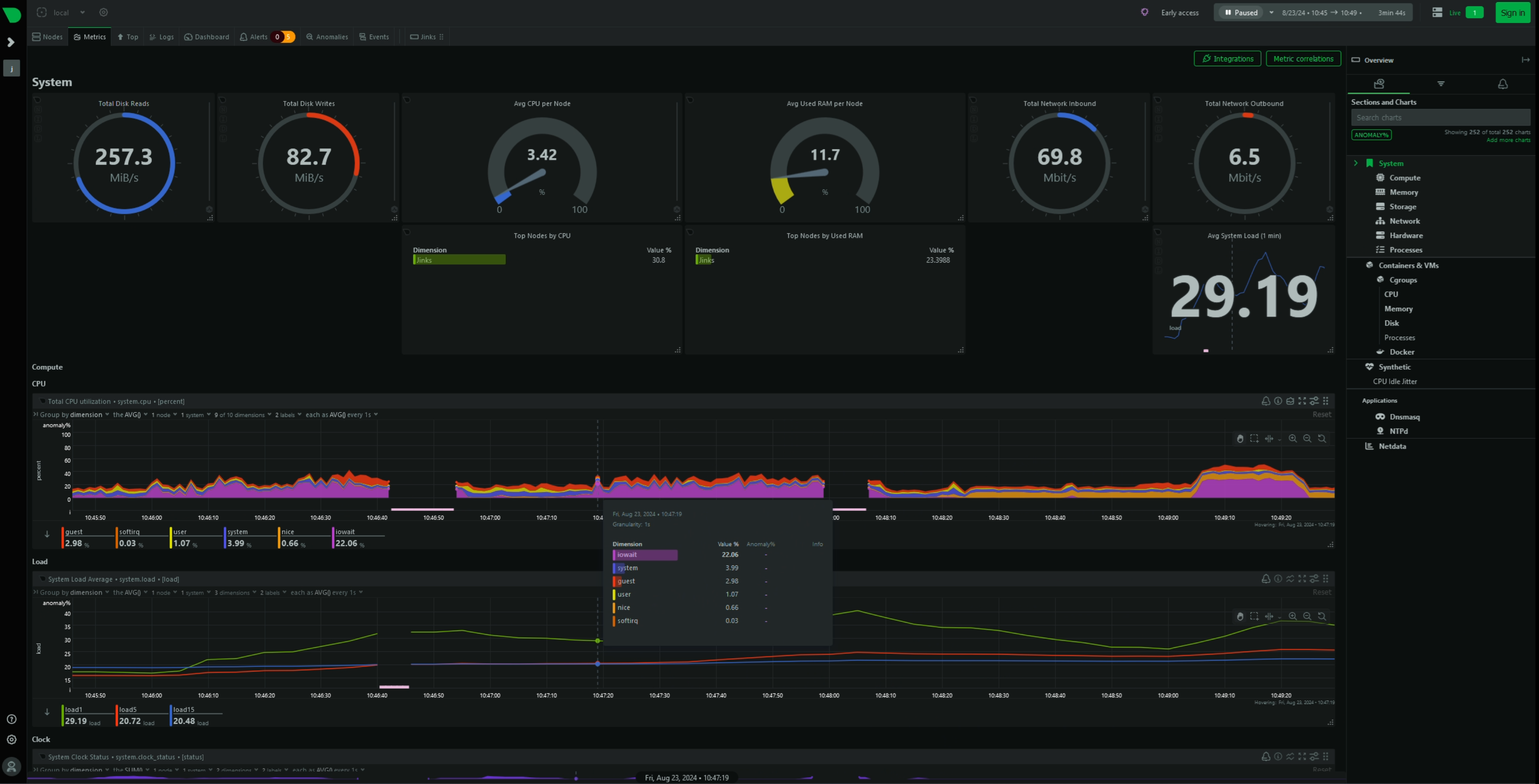

Also, here is a screenshot of netdata.
Unfortunately there's nothing relevant logged that I can see.
The netdata screenshot was to illustrate that when iowait is high is when everything becomes unresponsive. Hence the gap of unrecorded data. I was actively copying files(deluge was anyways) when this was taken.
Yes, but there's nothing logged in the syslog to explain that, if you are already using disk/exclusive shares, I don't see another reason for that, could be just slow devices, that won't leave anything logged.
