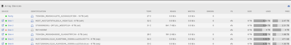

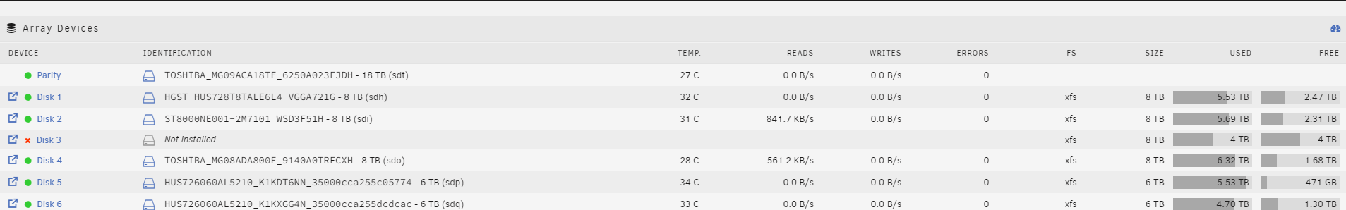

I had a drive remove itself from the pool due to read errors showing contents emulated.  I have a new drive arriving today but had to reboot for a different reason and now the drive is showing as not installed?  It does show the correct usage of the old disk but wonder if this is going to cause me problems when I install a new drive later?

That means the old disk is not being detected, or the array was started with the disk unassigned.
I never unassigned any disks but the disk is showing in the unassigned section, what is the best way to recover from this please?
Disk was already unassigned when the server last booted, I assume this was disk3:

If yes, SMART looks fine, would recommend replacing the cables to rule that out, then rebuild on top:
https://docs.unraid.net/unraid-os/manual/storage-management#rebuilding-a-drive-onto-itself
Disk is already unassigned, so you just need to re-assign and start the array to rebuild.
