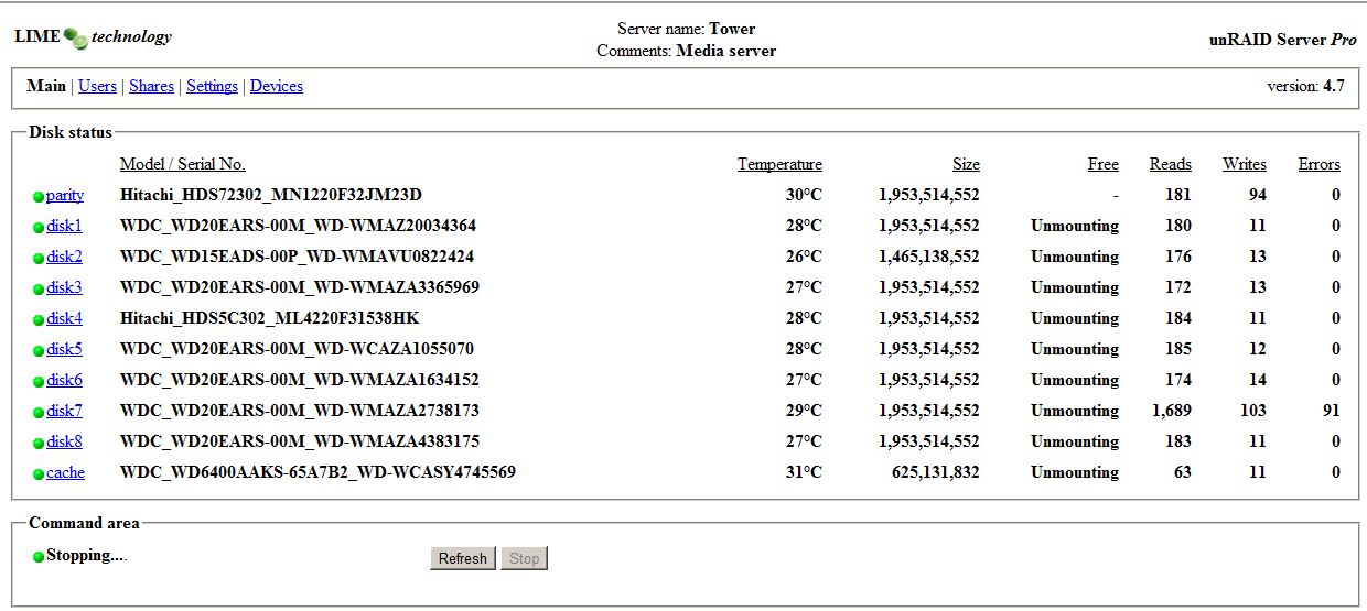

As of this today, I am suddenly having problems accessing my unraid array. I am running 4.7. A syslog is attached below along with an image of my main page that I fortunately grabbed while the system was still responsive intermittently. The syslog shows a flurry of errors as near as I can tell. It also appears to my untrained eye to be something to do with disk7 (which is also sdi if that is relevant).
I first noticed the problem when running YAMJ to update it to include some new media files I had just added to the server. I run YAMJ on my PC, having it set to put the YAMJ output on the unRAID server. This setup works so I’m sure that’s not the problem directly. The last step of running YAMJ is that it copies the changed file to the server and it was at that point that it hung. It had to copy about 2000 small files (a completely routine operation) but it would only copy a few and then hang. I tried spinning up all drives on the server and that allowed it to apparently copy a few more files but it stalled again. I then noticed that the even after spinning up the drives, the cache drive was still showing as flashing. Eventually I quit YAMJ since it refused to complete.
I next rebooted both the unRAID server (which appeared to come up fine) and the PC. It was at this point that the PC started connecting to the server erratically, so  I dumped the syslog. The web interface was still responding at this point, but was doing so erratically. Sometimes it couldn’t find the web interface and sometimes it could after longer than normal delays. I then attempted to stop the array but it wouldn’t enter a stopped state, at which point I took the attached snapshot which shows errors on disk7.  Then the web interface wouldn’t connect at all. I tried to connect via putty but it couldn’t find the server either.
