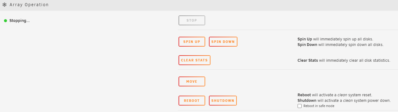

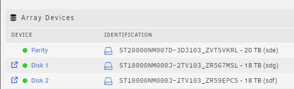

I have a situation that is occurring, which is preventing me from being able to stop the array or even successfully issue a shutdown.
I'm running 6.12.11 with 9 drives + parity + boot; 64GB RAM.  I was not able to mount a drive that I precleared, then I proceeded to stop the array and start the array in maintenance mode.  Now my array is stuck in stopping mode.
Thank you.

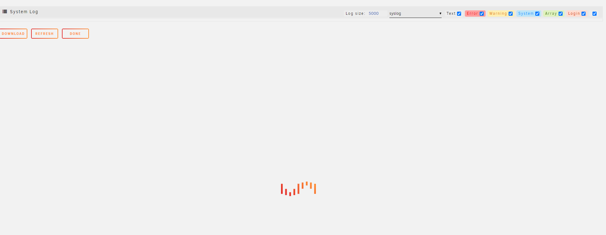

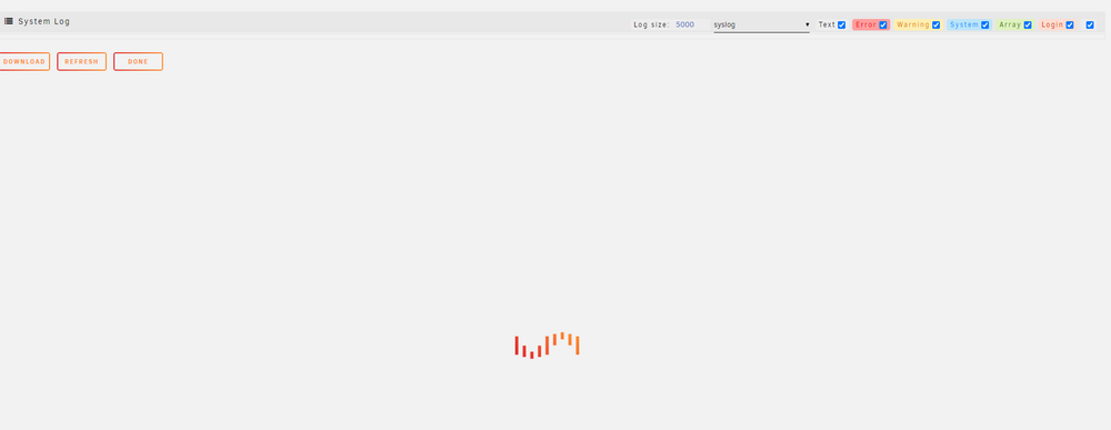

Trying to get diag and nothing is happening.

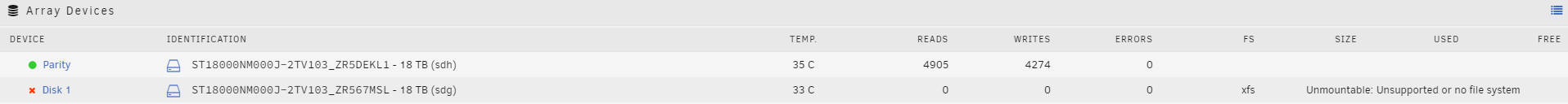

Since I executed a hard shutdown, disk 1 is unmountable.
I tried running Array in Maintenance Mode checking Disk 1 without any parameters and also using -L.  Stopped the array and tried starting the array in normal mode and disk 1 will not mount.

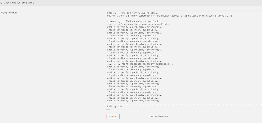

I ran a Filesystem check without -n and also with -L and started the array in normal mode and disk 1 still will not mount.

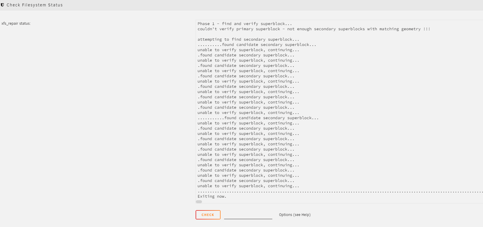

Post the output of xfs_repair without -n
Phase 1 - find and verify superblock... couldn't verify primary superblock - not enough secondary superblocks with matching geometry !!! attempting to find secondary superblock... ..........found candidate secondary superblock... unable to verify superblock, continuing... .found candidate secondary superblock... unable to verify superblock, continuing... .found candidate secondary superblock... unable to verify superblock, continuing... .found candidate secondary superblock... unable to verify superblock, continuing... .found candidate secondary superblock... unable to verify superblock, continuing... .found candidate secondary superblock... unable to verify superblock, continuing... .found candidate secondary superblock... unable to verify superblock, continuing... ...........found candidate secondary superblock... unable to verify superblock, continuing... .found candidate secondary superblock... unable to verify superblock, continuing... .found candidate secondary superblock... unable to verify superblock, continuing... .found candidate secondary superblock... unable to verify superblock, continuing... .found candidate secondary superblock... unable to verify superblock, continuing... .found candidate secondary superblock... unable to verify superblock, continuing... .found candidate secondary superblock... unable to verify superblock, continuing... ................................................................................................................................................................................................................................................................................................................................................................................................................................................................................................................................................................................................................................................................................................................................................................................................................................................................................................................................................................................................................................................................................................................................................................................................................................................................................................................................................................................................................................................................................................................................................................................................................................................................................................................................................................................................................................................................................................................................................................................................................................................................................................................................................................................................................................................................................................................................................................................................................................................................................................................................................................................................................................................................................................................................................................................................................................................................................................................................................................................................................................................................................................................................................................................................................................................................................................................................................................................................................................................................................................................................................................................................................................................................................................................................................................................................................................................................................................................................................................................................................................................................................................................................................................................................................................................................................................................................................................................................................................................................................................................................................................................................................................................................................................................................................................................................................................................................................................................................................................................................................................................................................................................................................................................................................................................................................................................................................................................................................................................................................................................................................................................................................................................................................................................................................................................................................................................................................................................................................................................................................................................................................................................................................................................................................................................................................................................................................................................................................................................................................................................................................................................................................................................................................................................................................................................................................................................................................................................................................................................................................................................................................................................................................................................................................................................................................................................................................................................................................................................................................................................................................................................................................................................................................................................................................................................................................................................................................................................................................................................................................................................................................................................................................................................................................................................................................................................................................................................................................................................................................................................................................................................................................................................................................................................................................................................................................................................................................................................................................Sorry, could not find valid secondary superblock Exiting now.
I am posting the image.  Thank you.
I started the array in maintenance mode.
Edited by Scuba_Steve
That looks being repair, suggesting your parity wasn't 100% valid, see if the actual disk1 mounts with the UD plugin

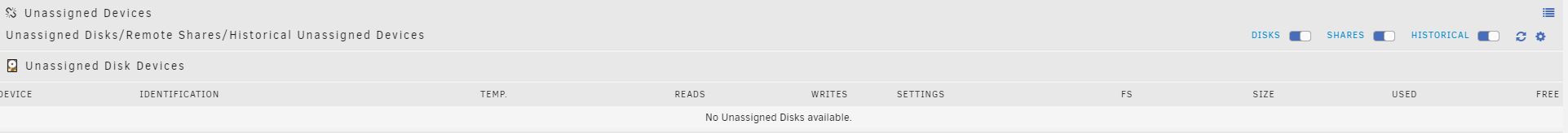

It is not showing any disks for UD.

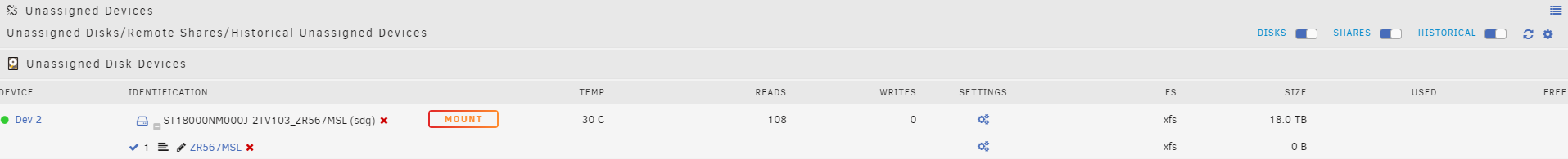

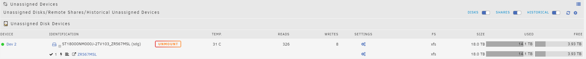

You need to unassign the disk.
I unassigned the disk.  Used UD to Mount the d2024-08-1618_35_35-USS-ENTERPRISE_Main.thumb.png.0d799352552cf4dc6e3317b89b7b61cc.png2024-08-1618_33_34-USS-ENTERPRISE_Main.thumb.png.3004b6f2c62690a45bcac080343b930e.png2024-08-1618_32_19-USS-ENTERPRISE_Main.thumb.png.1229a10f2e47ebe2dac9c50c9043766b.pngisk and still It is not mounting when I start the array.
