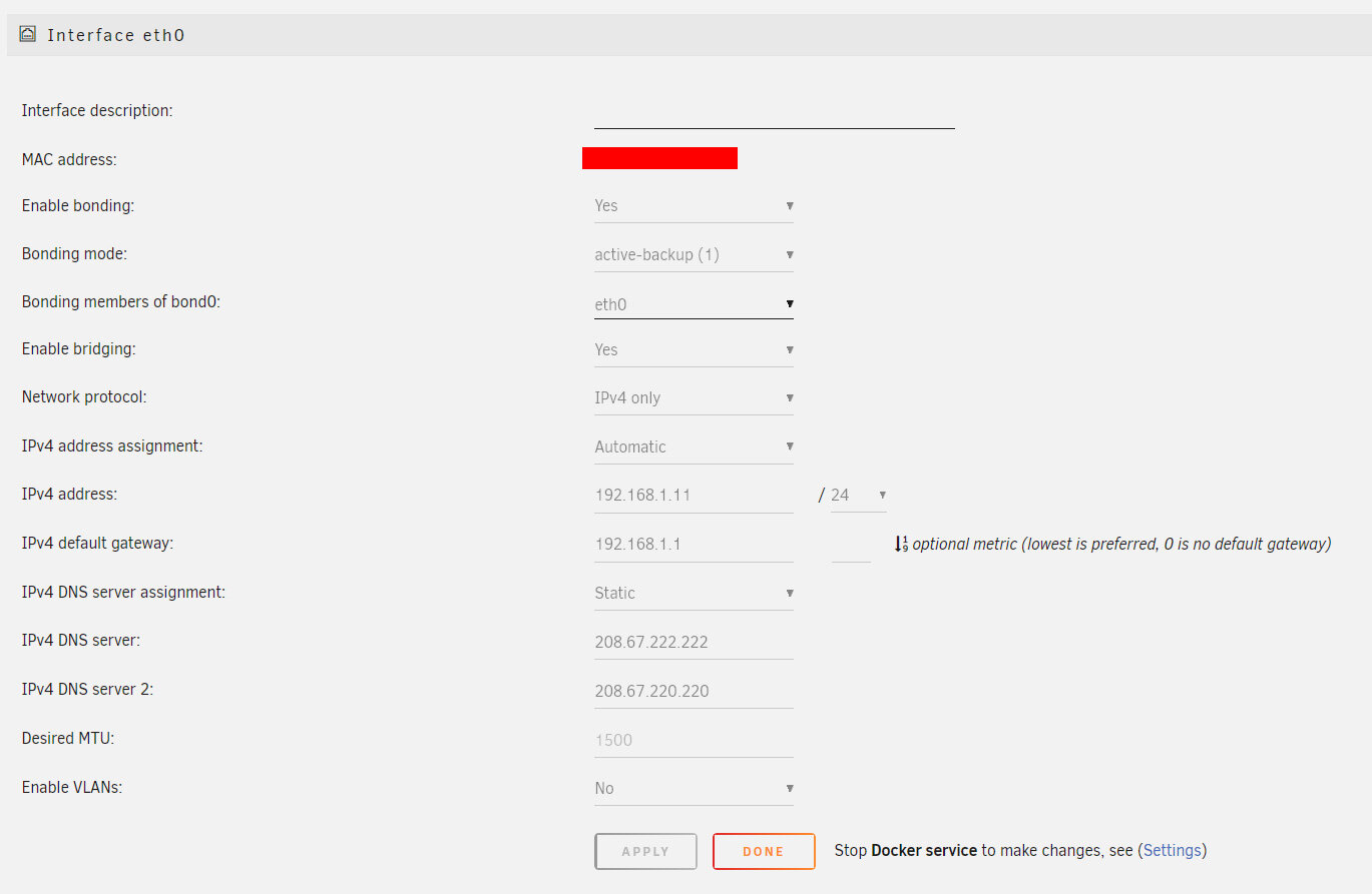

Nothing obvious logged, is it the same in safe mode? Also try changing your DNS server to 208.67.222.222 and 208.67.220.220 instead of using your router.  Settings - Network Settings
  • DanielCoffey changed the title to [6.12.11] Plugins/Docker slow to Check for Updates
I stopped the Docker process and edited the Network Settings to point to those OpenDNS addresses and rebooted the server but nothing changed.

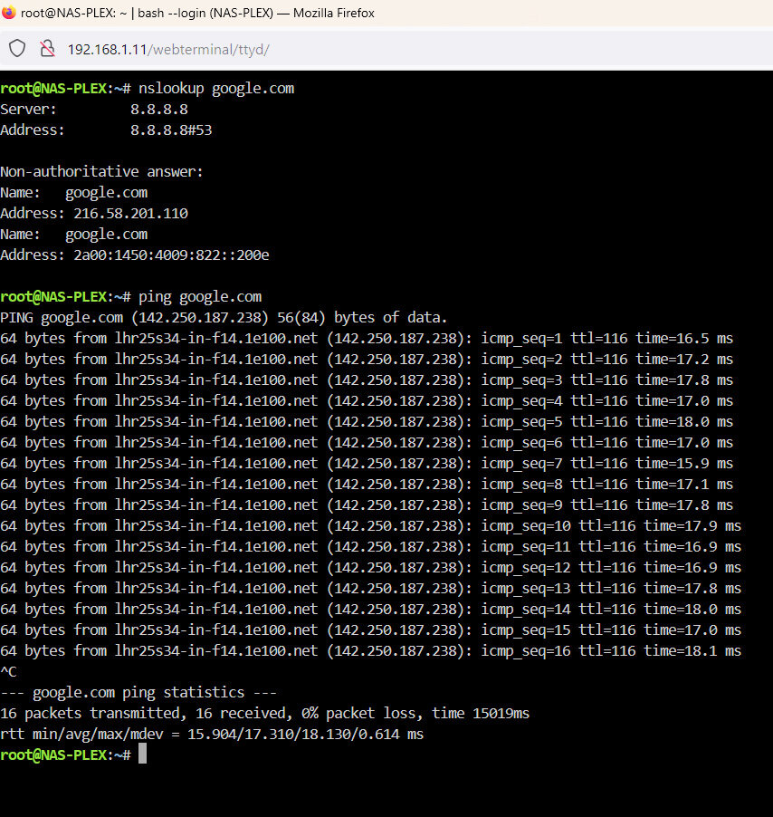

Just an update. I have reset back to 8.8.8.8 and 8.8.4.4 for my DNS and rebooted both my server and router/switch. I am still getting slow responses for each plugin when checking for updates.
When I open a command prompt in the UI and ask unraid to tell me the dns server it responds fine. Ping works quickly too. I still don't know why the plugins are so slow to check for updates however.

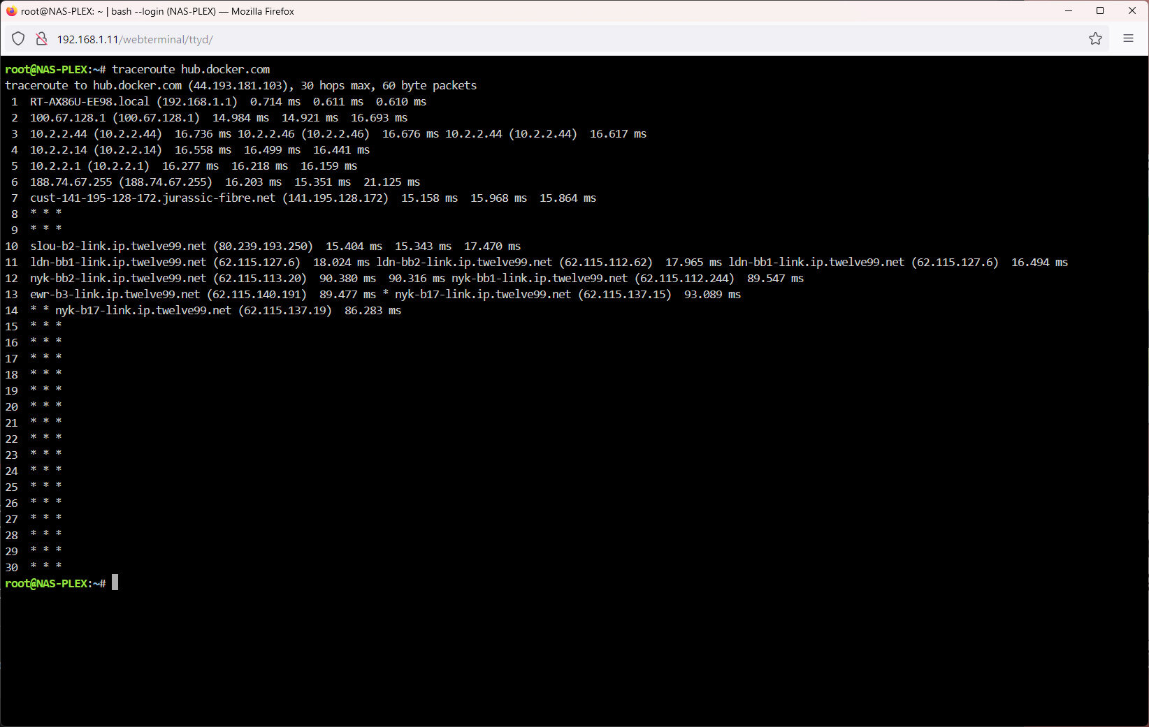

ping hub.docker.com and raw.githubusercontent.com
Now that was very revealing, thank you.

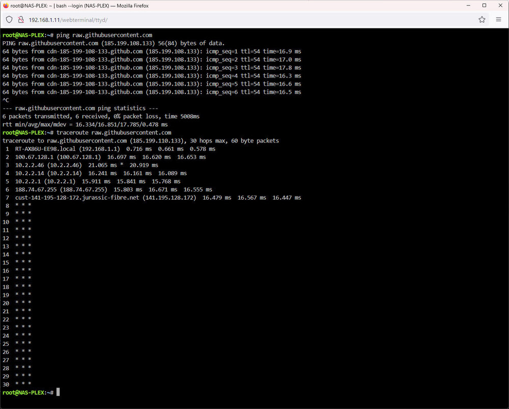

My unraid server seems to be set up for IPv4 but my Windows machine is IPv6 so I get different results depending which machine I ping/traceroute from.
hub.docker.com is 100% packetloss on both machines since I suspect the server does not respond to pings. Both machines get partial results from traceroute/tracert. Each line of traceroute is slow to appear, regardless of which machine I run it on.
raw.githubusercontent.com pings perfectly on both machines but Unraid is slow to start pinging. With traceroute, the Windows PC gets most of the hops normally but Unraid is again slow to start the traceroute, loses one, picks up again and then drops the thread.
Any thoughts as to the issue? If told how, I could attempt to turn on IPv6 on the Unraid box.
