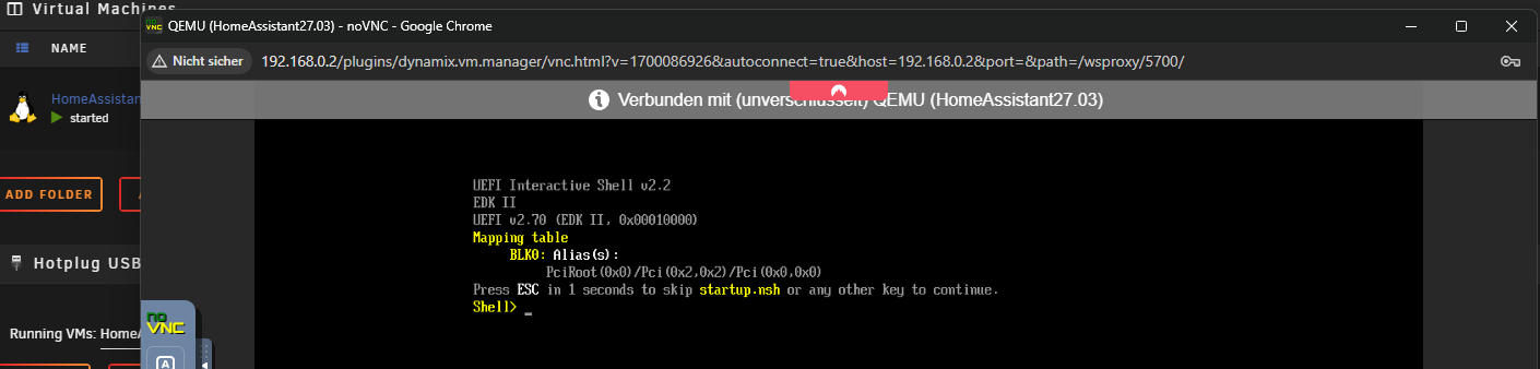

However, when I try to boot it up, it only stays in the UEFI shell and doesn’t actually start the VM.

- I created a new VM without using the XML and pointed it directly to the image at `/mnt/cache/domains/imagename.qcow`, but I still had no luck getting it to boot.
I'm stuck at this point and unsure what I might be doing wrong. If anyone has any ideas or suggestions, I’d really appreciate the help! I attached the XML and the fd file. I can provide more details if needed.

Update: I couldn't get the Backup to run. Luckily, I had another Backup from a few months ago that did work. Maybe the new VM Backup Add-on corrupted some files.
