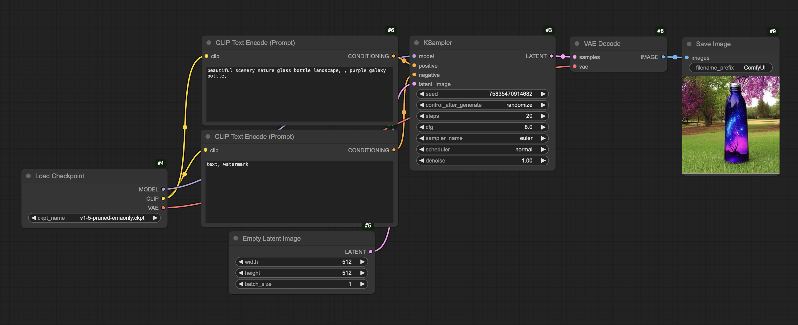

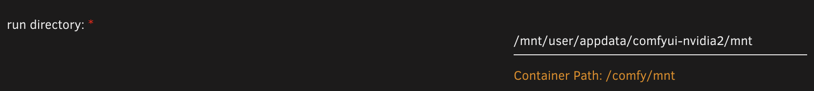

I got the beta on DockerHub; which appears to work for me so far (I get the WebUI)
To test it, edit your "Docker" entry and modify the "Repository" line from "mmartial/comfyui-nvidia-docker" to "mmartial/comfyui-nvidia-docker:ubuntu22_cuda12.3" (the attached screenshot is missing the last part of the 12.3)
You can rename the user_script.bash as user_script.bash.off to avoid having it run this next time.
It loaded the default SD1.5 bottle example, I placed the model there and got the resulting image

Thanks for the updated log.
It shows the "== Checking for user script: /comfy/mnt/user_script.bash" line but not that it found or ran the script (see my above log to see the difference)
Do you have multiple version or have you modified the default run directory and placed the script in the alternate version?
The default "run directory" should be "/mnt/user/appdata/comfyui-nvidia/mnt" (my screenshot shows my second install with the beta I just shared with you)

1 minute ago, DeusVault said:
I see the difference. Apologies, I should have mentioned using the value of the "run directory" in my earlier instructions instead of /mnt/user/appdata
