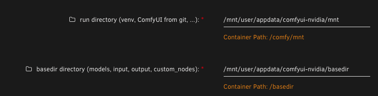

FYSA, a new release of the container (20250202) uses the new command-line option (—-base-directory), which allows the separation of the ComfyUI sources from the user's content (models, input, output, custom_nodes, user).
You can use this to place the `basedir` on a separate volume, outside of the `appdata` folder.
For new users, this should work out of the box, manually adapt the `basedir` mount location to reflect the preferred location.
This option was recently added to ComfyUI. For users with a ComfyUI that was not "git pulled" within the last week, you must upgrade the code using the manager before enabling the variable.
If you already have a large model collection, I recommend manually moving the "run/ComfyUI/models" to the new "basedir" as documented at https://github.com/mmartial/ComfyUI-Nvidia-Docker?tab=readme-ov-file#533-base_directory
The template has been updated to reflect this change. This is the "basedir" variable (and its matching "BASE_DIRECTORY" hidden value)
For people using the "user_script.bash", you need to add "${COMFY_CMDLINE_EXTRA}" to your "python3 ./main.py" line.
For details, see https://github.com/mmartial/ComfyUI-Nvidia-Docker?tab=readme-ov-file#52-user_scriptbash

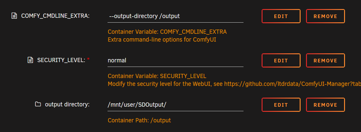

I would like to request that the docker template be adjusted to utilize the  --output-directory command line flag to specify an output directory separate from the directory where I store my checkpoints/loras/embeddings/etc.
I have my checkpoints/loras/embeddings stored in a directory on a SSD, and I don't want to be writing continuously to that SSD with the output of my image generations.  With the addition of the /basedir feature, the default behavior is to have the output folder in the same base directory as the inputs.
Fortunately, by utilizing the --output-directory command line flag, we are able to specify a location outside of the base directory to output images to.  However, in order to move it away from the same drive as the base directory, the docker needs to have an additional path added to it which points towards where you want to output images to.  I've done this on my end as shown in the screenshot:
While it was not difficult to work this out, I feel that other users would find it more convenient if the docker config already included the field to identify the output path, and the --output-directory command line flag was built into the docker by default.
Thanks for the question.
I agree about having a separate directory for output.
The good news is that at the end of January, the Comfy team integrated a new option to the ComfyUI CLI (--base-directory), and I have integrated it into the container and updated the Unraid template to reflect the change. You can see below a screenshot how what the template should show you at this point.
I had to install a second instance of the container (turn off the first one, change the port) and install a new instance with the same parameters (locations) to use the updated template.
My recommendation is to FIRST use the old container to update ComfyUI through the Manager so your container supports the new CLI option..
Then, manually create the new "basedir" folder before moving the files (you can do this using an SSH into your Unraid, a terminal from the WebUI, or a File Manager WebUI such as Double Commander). The reason behind this recommendation is that the container, when started, will attempt to MOVE "input, output, ... " (see list in the screenshot) to that location. That process is extremely slow because it will copy one file per file before deleting the folder. Not only is it slow, but if you have a large model collection, it will duplicate all the content on disk before deleting it.
That solution also allows you to separate the "run" folder from the "basedir," which can be placed on an alternate disk (let's say you have a Docker Application backup running every day; not having the models as part of that backup is very convenient).
Please see the last paragraph of this post
for details on installing a second instance.
Edited by martial
I was not specific enough.  What I'm requesting is an additional parameter besides the Base Directory option.  I'm already using the base directory option in the new template.  The behavior of the base directory option by itself is to have the Output folder in the same base directory as the Inputs (checkpoints/loras/embeddings/etc).  Many people put their inputs in a SSD to facilitate load times, and some of them may not want to have their generated images output to the same SSD due to size and repeated write concerns.
ComfyUI allows for the separation of the Output Folder from the Base Directory folder via the --output-directory command line flag, but in order to utilize that flag to put the Output folder anywhere besides the Base Directory folder in the current Docker template requires an additional field to allow the user to specify where the Output folder resides in the array.  As shown in my screenshot, it's not difficult to get it working.  However, I think that many users would prefer having that field added as part of the default Docker installation, and the corresponding --output-directory command line flag incorporated into the docker instead of  needing to be manually entered into the COMFY_CMDLINE_EXTRA field.
Hello. This stopped working for me so i uninstalled it and reinstalled and i still can not get it to work. I have the following in end of the logs.  Let me know if there is anything else that is needed to help.
Thanks for your time
Unriaid 6.12.9

main.py: error: unrecognized arguments: --base-directory /basedir

== Setting base_directory: /basedir
++ Logic to move content from ComfyUI directories to the new base_directory
  -- /comfy/mnt/ComfyUI/models not found, /basedir/models exists, skipping

!! COMFY_CMDLINE_EXTRA extended, make sure to use it in user script (if any):  --base-directory /basedir
== Container directory: /comfy/mnt/ComfyUI
== Checking for user script: /comfy/mnt/user_script.bash
== Running ComfyUI
-- Command line run: python3 ./main.py --listen 0.0.0.0 --disable-auto-launch  --base-directory /basedir
!! ERROR: ComfyUI failed or exited with an error
!! Exiting script (ID: 1)
Hi, the error is at the beginning of your logs: "main.py: error: unrecognized arguments: --base-directory /basedir"
This is due to a version of ComfyUI installed in the venv that is older than the end of January 2025 (base-directory is a very recent option)
Please see https://github.com/mmartial/ComfyUI-Nvidia-Docker?tab=readme-ov-file#63-using-base_directory-with-an-outdated-comfyui for a couple of options to fix this
Thanks. Im back up now.
