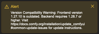

Hello, can somebody help me how to update frontend for ComfyUI Docker? I went through docs, but I am not wiser.
I am getting this message.
Thanks.
Sadly, I do not have a magic solution for this, unless you are able to force its installation from the "Manager" while using Comfy.
My usual solution for those types of issues is to reinstall ComfyUI and the virtual environment needed to run my custom nodes (ie, a couple of re-runs with re-downloads --and using the Manager to reinstall failed nodes, which will have failed because the venv does not contain the expected content)
To do this, I recommend deleting (or renaming) the run folder in /mnt/user/appdata/comfyui-nvidia/mnt so that a new one can be created. Comfy will redownload, and after the "couple of failed nodes reinstall from the manager" step, you should be back in business.
Thanks.
i update my frontend with the the command comfyui shows you when you start the container with an old frontend. You find the command in the container protocol. In my case the command is /comfy/mnt/venv/bin/python3 -m pip install -r /comfy/mnt/ComfyUI/requirements.txt
You can now start your container command line and just copy and paste this command. The frontend will be updaded and after a container restart you will have the new frontend.

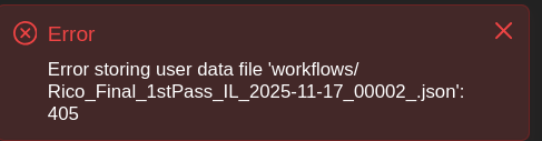

I am having a weird issue saving and opening workflows that I've saved in the past. When I try to save a workflow, I get an error like attached.
Then when I try to open an existing workflow, I can see the files in the webui, but clicking on it does nothing. I am able to download the existing workflows on my unraid serverfiles here '/mnt/user/appdata/comfyui-nvidia/basedir/user/default/workflows' and just upload them directly and keep working. I just dont really understand why I can't open or save workflows directly in the webui. Any thoughts? I do have set_chown to true to try and resolve but it doesn't help.
a 405 is a "method not allowed" error, which is very weird to see.
I expect your Comfy installation is not too old, there seems to have been a similar error posted on their GH but that was March this year and the issue appears to be related to the reverse proxy is use in front of Comfy

Wow that fix worked perfect thanks!
