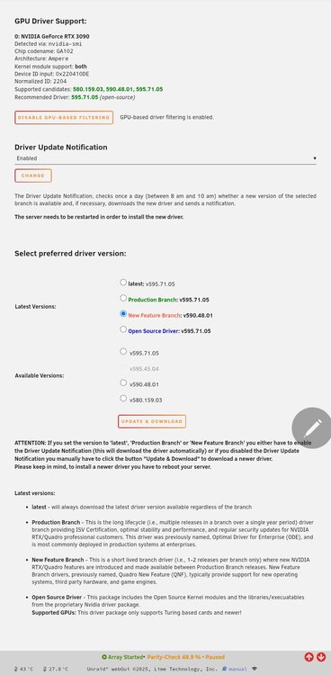

Hi, I found the Problem. It is the old Nvidia driver 580 in the Unraid Nvidia Plugin. Actually I can't get the version 590 to work with my 5070ti. Currently, I'm passing the GPU through to a VMware and everything works fine.
Blackwell cards are only supported by the open source driver on unraid, so 580.

Hi, thanks for your response. I need the driver version 590 to get this card run in the docker container. The card doesn't work in the Container with the open source driver 580. In tested it in my VM. With driver 580 I get the coda error too, but installing driver 590 solves this problem.
I have a 5070 TI working with this docker, which Cuda version are you on?
Support was added in 12.8 I think

I had this working a few weeks ago. Worked right out of the gate on the first install. I updated the nvidia plugin and it broke this docker. No ones fault. But i have tried 20+ times with different combinations or nvidia drivers and associated docker cuda versions. None or them work, i either get an error about torchaudio incompatibility, wrong cuda version or an error pops up saying a requirement is not installed(Just depends on the combination i put togeather). The torchaudio seems to be the most prevalent as i can install cuda 13.0 and everything else seems to load but torchaudio is at 12.8 and incompatible. Does anyone have a good way to get this installed? i would like to just go to an older version of the nvidia plugin but i am not smart enough to figure out how to go to an older version of the plugin.
Had something similiar in the past. Updated the Plugin and ComfyUi stopped working. It was the newest driver version that caused it. Go into the Plugin and try with an older driver version. Reboot required.
So i installed the same driver set you have, I also happen to have the 3090. My log shows failed and exit when launching. I was trying to load up the cuda 12.8 version of this docker. I get the below in my log as the last line. Not really sure why its registering cuda 13.0 when i ran the 12.8 docker. Either way it did not work. I am going to try some more configs with this driver. If i may ask what version did you install with that driver?
"RuntimeError: Detected that PyTorch and TorchAudio were compiled with different CUDA versions. PyTorch has CUDA version 13.0 whereas TorchAudio has CUDA version 12.8. Please install the TorchAudio version that matches your PyTorch version."
