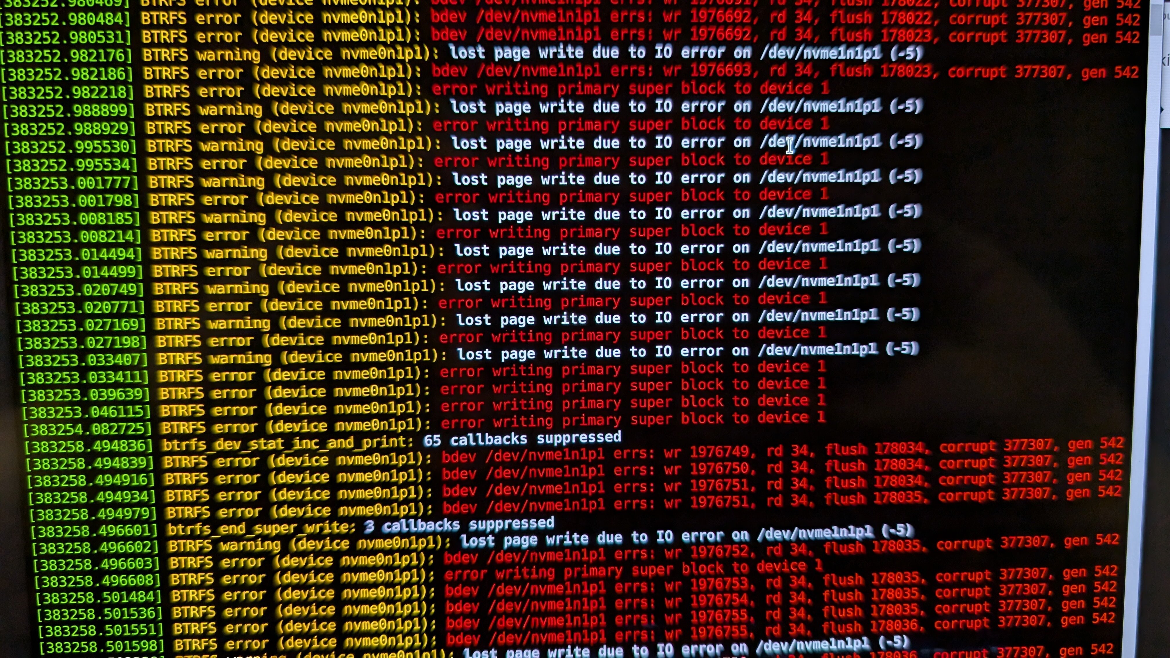

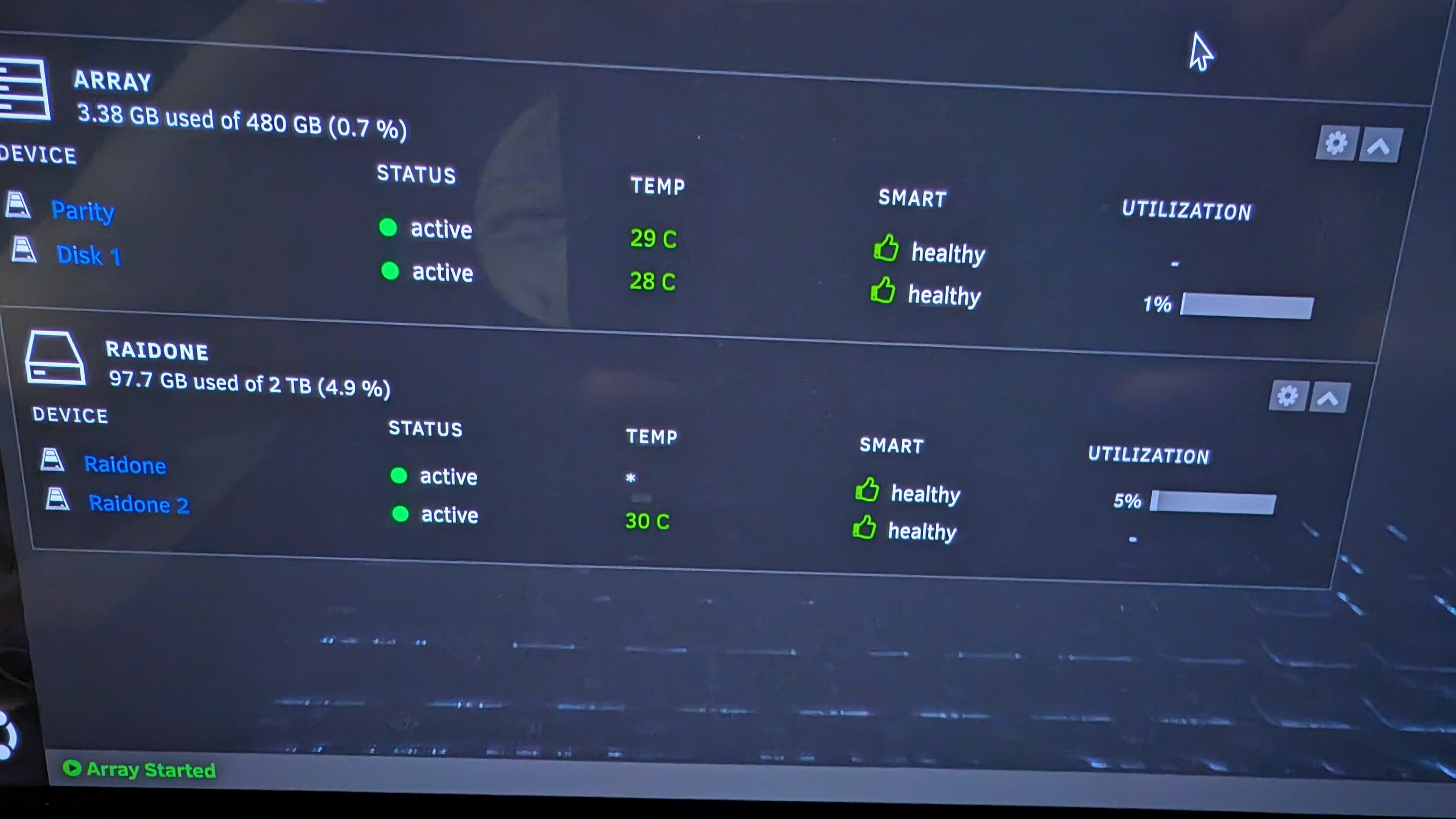

I have a BTRFS mirror of 2 NVME drives, twice now the same NVME drive has "failed" yet the volume shows as healthy and no warnings in the UI about the failed disk.

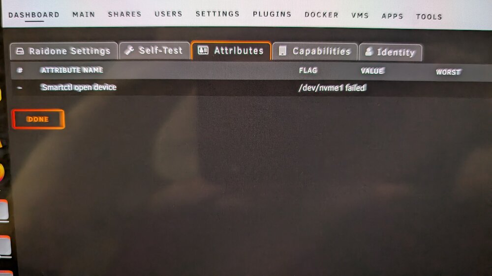

If I reboot the system, the drive comes back online and a srub with repair resolves the problem.  This is concerning that the UI shows the volume as healthy.  The only clue is that the drive reports no temp just a *.
Any thoughts? this is a new Samsung 990 Pro drive and has the latest firmware. see attached images.

Also why didn't unraid report the failed array/drive?

Aug 18 08:47:37 unraid kernel: nvme nvme1: controller is down; will reset: CSTS=0xffffffff, PCI_STATUS=0xffff
Aug 18 08:47:37 unraid kernel: nvme nvme1: Does your device have a faulty power saving mode enabled?
Aug 18 08:47:37 unraid kernel: nvme nvme1: Try "nvme_core.default_ps_max_latency_us=0 pcie_aspm=off" and report a bug
NVMe device is dropping offline, try adding those options to syslinux, after /bzroot, then reboot and retest.
As for no warning, pools are not currently monitored by the GUI, old issue, see here for now.
