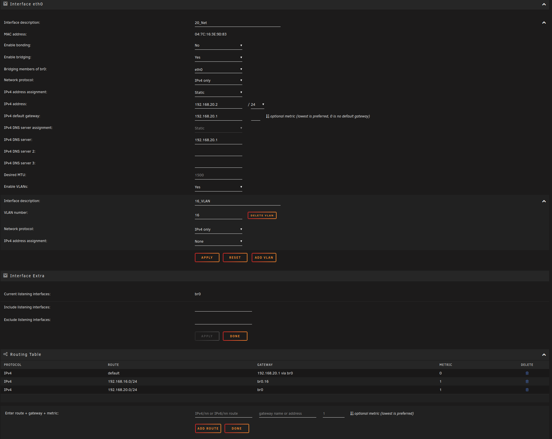

Previously, Proxmox managed the VLANs and I just passed through 2 virtual NICS to UnRaid, br0 and br1.
My host has 1 physical NIC so I need UnRaid to manage the VLANs. I have configured this and now have br0 and br0.16.
I want to simply change everything previously configured as br1 to br0.16.

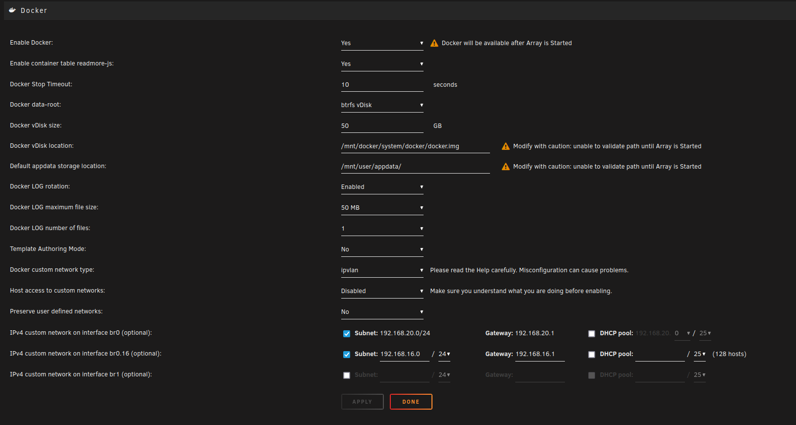

Docker config has br0 and br0.16 set up as interfaces but when I try to change docker configs, it shows only the following options:
Bridge
Host
None
Custom: br0 -- 20_Net
Custom: br1
br1 no longer exists and br0.16 should show but doesn't.
Not sure what is wrong here. Any input would be appreciated.

Thanks for the input @Vr2Io. Doing this seems to have removed the br1 interface from the Docker settings which you highlighted however, the problem with only br0 and br1 appearing when actually configuring a docker network setting persists. Ther is still no br0.16 option and br1 remains there.

Resolved...
Deleted docker.img file and reinstalled apps. correct network was there after deleting.
