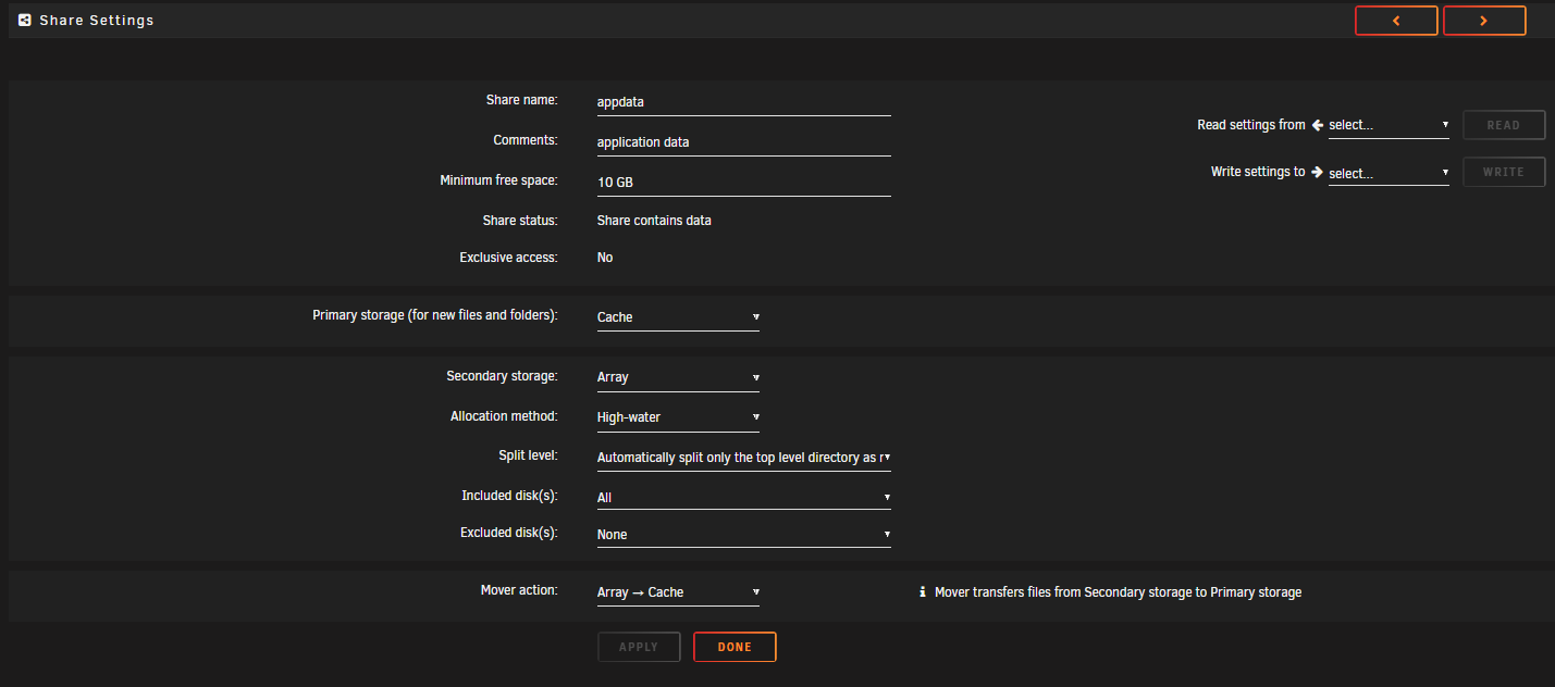

2. Change AppData shares to ensure Array -> Cache Move

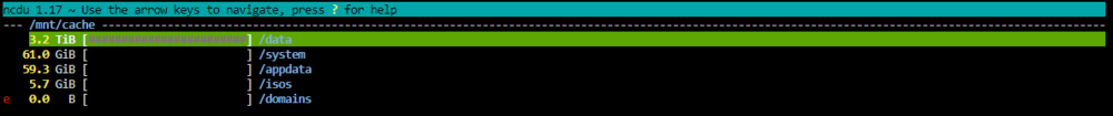

3. Run NCDU from NerdTools to examine the Cache drive contents (It was mostly Media files, which is to be expected, however not sure why these appdata files take so long to transfer)

The main problem is that other data on cache which is taking 3.2TB. You need to get that moved off cache.
Your diagnostics has a share with files on cache and configured to be moved to the array, but that doesn't show in your ncdu output.

I actually think the share did display on the NCDU command, it's just that the green highlight almost makes it not visible, which is the Data share which shows 3.2tb.

Also you typically want your appdata only on cache, not being moved to slow drives.
With the settings shown in the screenshot then mover will attempt to do this once space has been made by flushing the 'data' share to the array.
Nothing can move open files, so you may need to disable Docker in Settings to get all of appdata moved to cache.
