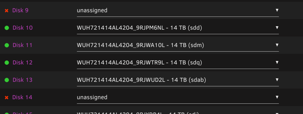

August 19, 20242 yr Hi guys, I got quite unlucky yesterday with my server, 2 drives showed up as disabled with no prior warning from unraid or read/write errors. I thought there might be something wrong didn't think the drives would die that suddenly so I rebooted the server to see if they popped up and it showed them as "Device is missing, content emulated". As I'm getting replacements for these disks another drive (Disk 13) started getting read errors and its got up to 10k now. After doing some research I decided to use unbalanced plugin to transfer data from the failed disks to the functional ones (excluding the one with errors) unfortunately this will take a few days to finish as the disks had 7tb of data each. The plan is to transfer the data, make a new config and rebuild parity then add the new replacement disks once they arrive. The content on the disks is not irreplaceable I've got a backup I can go back to, I just need some advice with regards to what is the best way of doing it. Should I use unbalance on the disk with errors as well, or should I get a new copy of what's in it? I made "ls -R" txt documents for each disk individually so I know what was in them in case another one dies on me, I know whats in it and I can get a back up. The problem is time... it took a while to transfer that data there in the first place I only have the diagnostics of the server after reboot, not sure if it can tell you much about what had happened. You guys are awesome thanks for helping out newbies like me! olympus-diagnostics-20240819-1219.zip

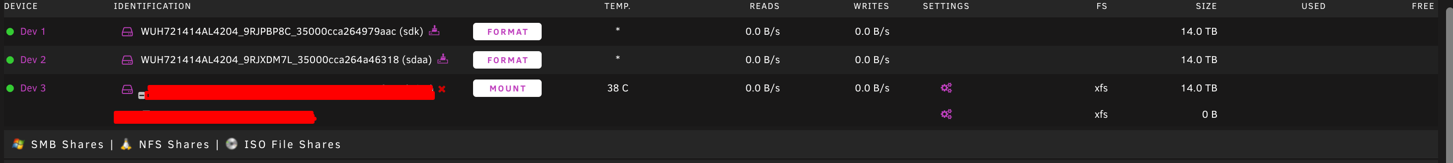

August 19, 20242 yr Author 2 hours ago, JorgeB said: Looks more like a power/connection issue, check cables for affected disks, especially if they share something in common, and post new diags after array start Thank you for your prompt response! 2 days ago I installed an Intel ArcA310 GPU to my server, it didn't cross my mind that it would affect the power delivery to the drives because right after the installation everything seemed to be working fine. I moved the hard drives to the front bay and it seems to have fixed the reading errors! Im hoping it doesn't happen again. the 2 drives that failed are now recognizable by the server, I had deleted their configs when they were first disabled thinking Im gonna have to replace them so unraid did not automatically mount them. I know I screwed up as I should have waited, Ive got a lot to learn...They are popping up in UD as new drives (Dev 1 and Dev 2) but are unformattable, preclear doesn't work on them either. Is there any hope for them? New diagnostics attached after starting the array olympus-diagnostics-20240819-1443.zip Edited August 19, 20242 yr by lqpnote

August 19, 20242 yr Author 12 minutes ago, JorgeB said: That's from the UD plugin and unrelated to array operations. Strange part is UD not offering to mount those disks, post the output of: smartctl -x /dev/sdk smartctl 7.4 2023-08-01 r5530 [x86_64-linux-6.9.5-thor-Unraid+] (local build) Copyright (C) 2002-23, Bruce Allen, Christian Franke, www.smartmontools.org === START OF INFORMATION SECTION === Vendor: WDC Product: WUH721414AL4204 Revision: C240 Compliance: SPC-4 User Capacity: 14,000,519,643,136 bytes [14.0 TB] Logical block size: 4096 bytes LU is fully provisioned Rotation Rate: 7200 rpm Form Factor: 3.5 inches Logical Unit id: 0x5000cca264979aac Serial number: 9RJPBP8C Device type: disk Transport protocol: SAS (SPL-4) Local Time is: Mon Aug 19 08:11:03 2024 PDT device Test Unit Ready [medium or hardware error (serious)] A mandatory SMART command failed: exiting. To continue, add one or more '-T permissive' options. I added -T permissive to the command this came out smartctl 7.4 2023-08-01 r5530 [x86_64-linux-6.9.5-thor-Unraid+] (local build) Copyright (C) 2002-23, Bruce Allen, Christian Franke, www.smartmontools.org === START OF INFORMATION SECTION === Vendor: WDC Product: WUH721414AL4204 Revision: C240 Compliance: SPC-4 User Capacity: 14,000,519,643,136 bytes [14.0 TB] Logical block size: 4096 bytes LU is fully provisioned Rotation Rate: 7200 rpm Form Factor: 3.5 inches Logical Unit id: 0x5000cca264979aac Serial number: 9RJPBP8C Device type: disk Transport protocol: SAS (SPL-4) Local Time is: Mon Aug 19 08:12:23 2024 PDT device Test Unit Ready [medium or hardware error (serious)] SMART support is: Available - device has SMART capability. SMART support is: Enabled Temperature Warning: Enabled Read Cache is: Enabled Writeback Cache is: Enabled === START OF READ SMART DATA SECTION === SMART Health Status: OK Current Drive Temperature: 0 C Drive Trip Temperature: 0 C Elements in grown defect list: 4
August 19, 20242 yr Community Expert 15 minutes ago, lqpnote said: device Test Unit Ready [medium or hardware error (serious)] This is not normal, does the other one show the same? Also post the output of: blkid /dev/sdk and fdisk -l /dev/sdk
August 19, 20242 yr Author 7 minutes ago, JorgeB said: blkid /dev/sdk This has no output at all Quote blkid /dev/sdaa (Other drive) No output Quote fdisk -l /dev/sdk fdisk: cannot open /dev/sdk: Input/output error Quote fdisk -l /dev/sdaa fdisk: cannot open /dev/sdaa: Input/output error Quote smartctl -x /dev/sdk smartctl 7.4 2023-08-01 r5530 [x86_64-linux-6.9.5-thor-Unraid+] (local build) Copyright (C) 2002-23, Bruce Allen, Christian Franke, www.smartmontools.org === START OF INFORMATION SECTION === Vendor: WDC Product: WUH721414AL4204 Revision: C240 Compliance: SPC-4 User Capacity: 14,000,519,643,136 bytes [14.0 TB] Logical block size: 4096 bytes LU is fully provisioned Rotation Rate: 7200 rpm Form Factor: 3.5 inches Logical Unit id: 0x5000cca264a46318 Serial number: 9RJXDM7L Device type: disk Transport protocol: SAS (SPL-4) Local Time is: Mon Aug 19 08:47:54 2024 PDT device Test Unit Ready [medium or hardware error (serious)] A mandatory SMART command failed: exiting. To continue, add one or more '-T permissive' options. root@Olympus:~#

August 19, 20242 yr Community Expert Are the emulated disks mounting correctly? If you start the array with those disks unassigned.
August 19, 20242 yr Author 4 minutes ago, JorgeB said: Are the emulated disks mounting correctly? If you start the array with those disks unassigned. Yes. It says contents are emulated and I can access them through /mnt/disk9 and /mnt/disk14/ Its just weird because they both went from being healthy to dead within a few minutes!
