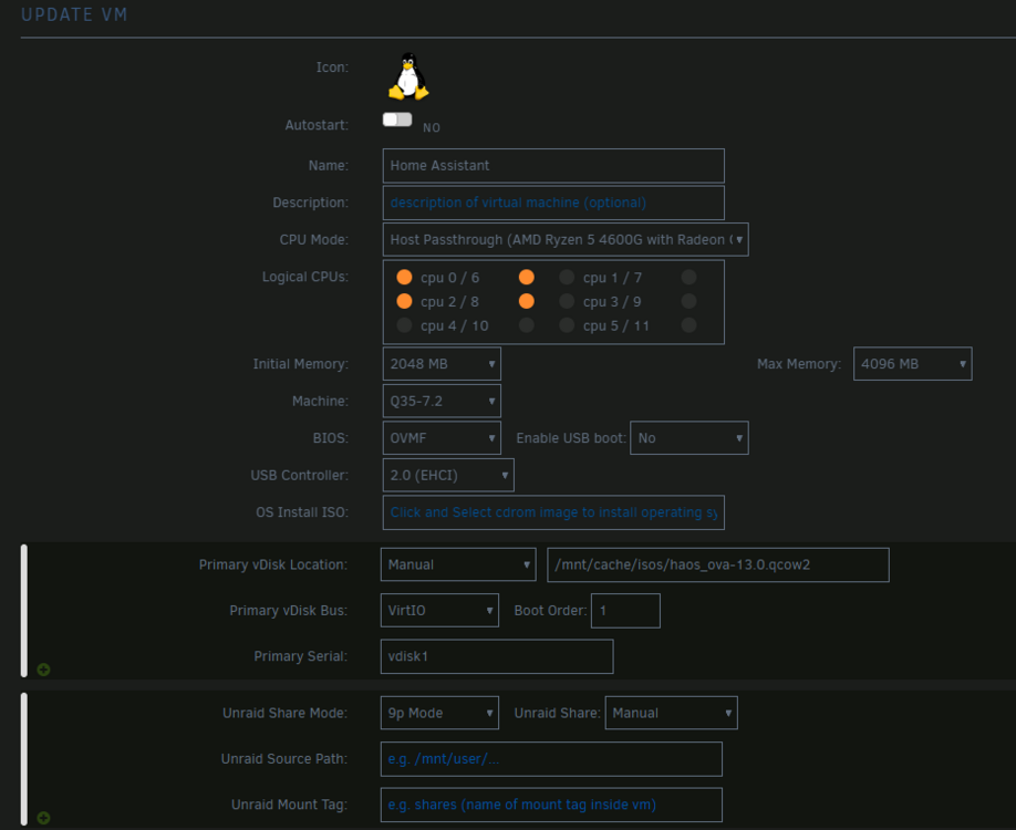

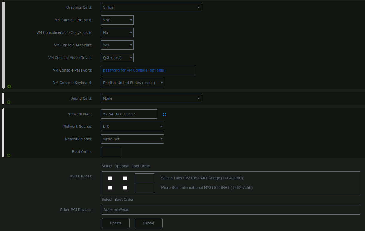

Here is my VM configuration for reference
I tried a whole bunch of debugging steps that I found online and I eventually narrowed it down to the fact that the network adapter on my VM is getting stuck on getting an IP from my router. I couldn't find a good reason for this on my router's side especially since my unraid server pulled the static IP I set for it on my router just fine.

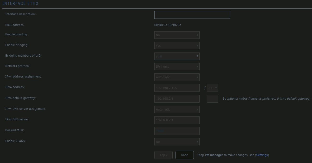

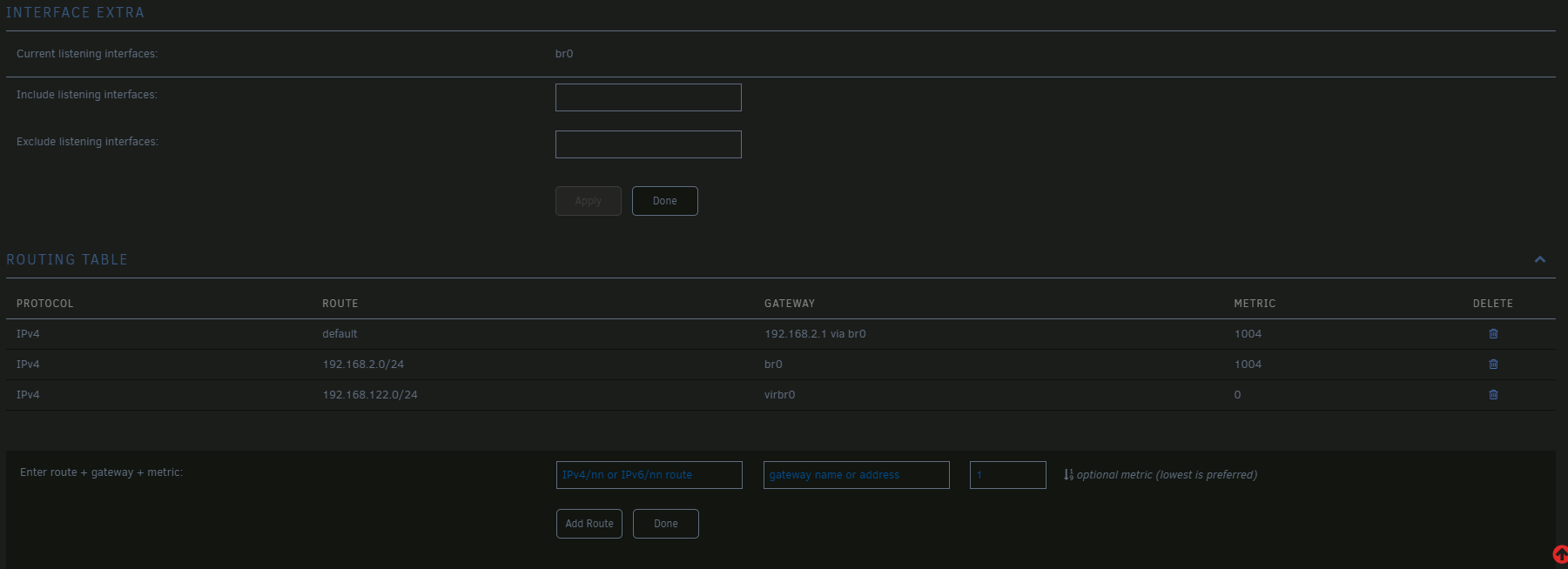

Here are my unraid network settings for reference
My network is pretty simple I have one main router that's a cheap gigabit tplink router and then my server and a few other devices are plugged into a second netgear router that is set up to just work as an unmanaged switch.
