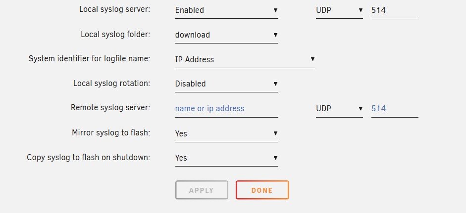

Syslog you posted is the normal one after a reboot, not the persistent syslog.
how do I find the persistant one. I ticked mirror to flash and the guide says its in "/boot/logs". There is no boot folder so Im guessing its the root folder of the usb.
Capturing diagnostic information | Unraid Docs
Thanks
