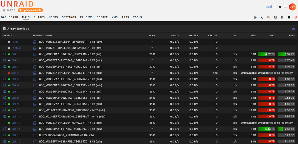

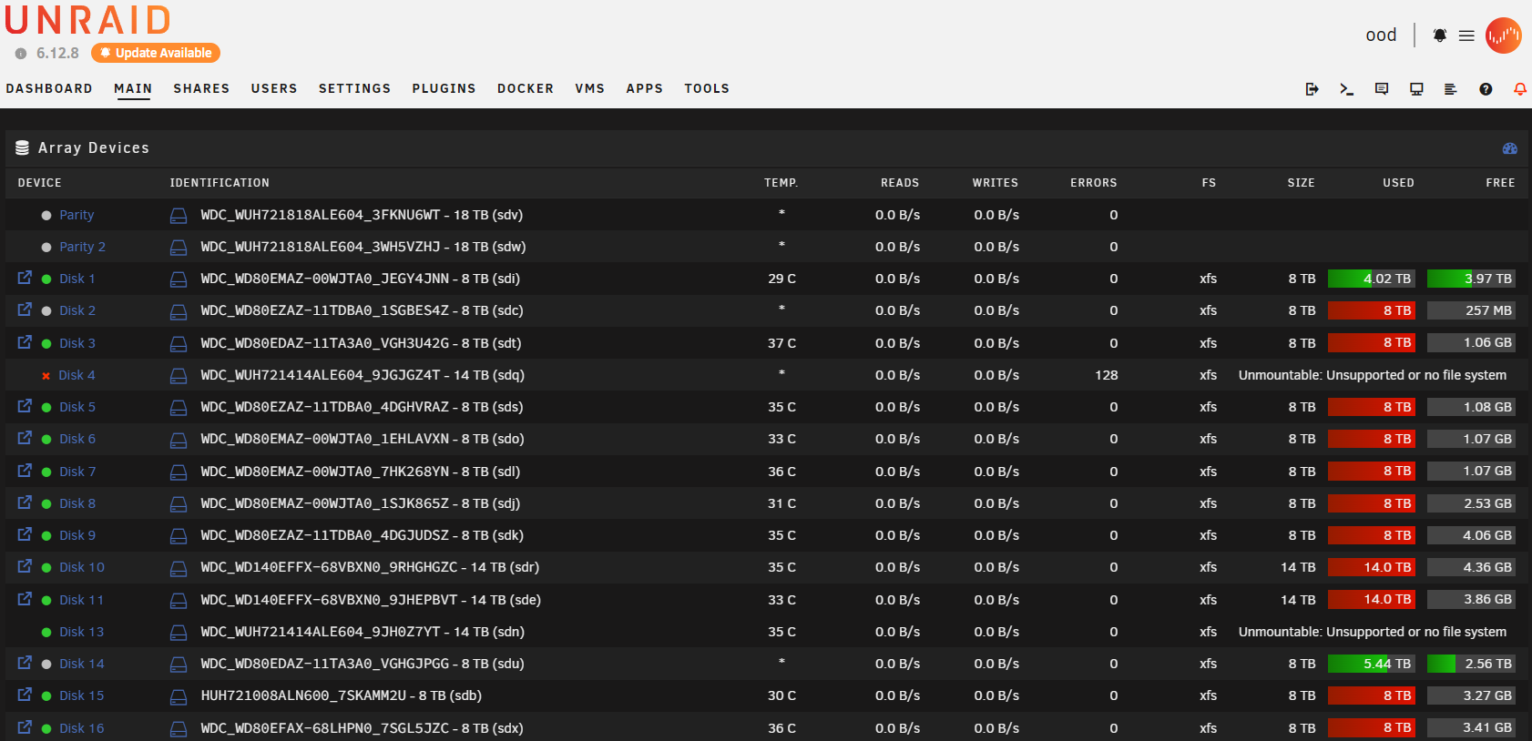

Unmountable Drive After Rebuild
UnRAID removed two drives from my array because of performance problems.
I replaced both with "refurbs".  I restarted the array, and one of the drives dropped out again during the rebuild.  I let the rebuild finish, expecting to restore one of the drives.
Now, I'm seeing both of those drives listed as "Unmountable", even though all but one of the drives appears to be back in operation.
Did I just rebuild my parity and lose the data on my drives?  One of the drives was dumping so many "power on reset" errors that my log doesn't go back to start of the array rebuild.

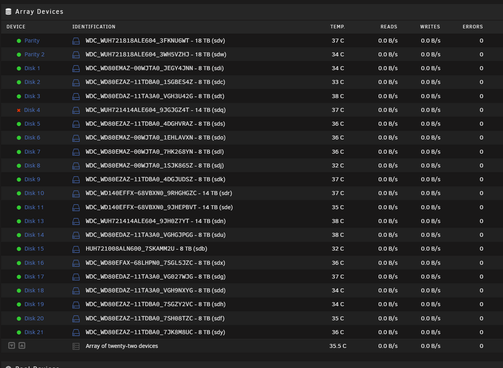

Attached... disc 13 looks pretty scary.
Discs_4_13.txt
Disk should mount now, look for a lost+find folder.
I'd like to be sure that I'm following this.  The disk hasn't been reporting as "unmountable or unformatted" for a while.
Disk 13 appears to be active in the array, and Disk 4 is emulated.  The array is still in maintenance mode.
What should I do next?
Edited by bithoarder

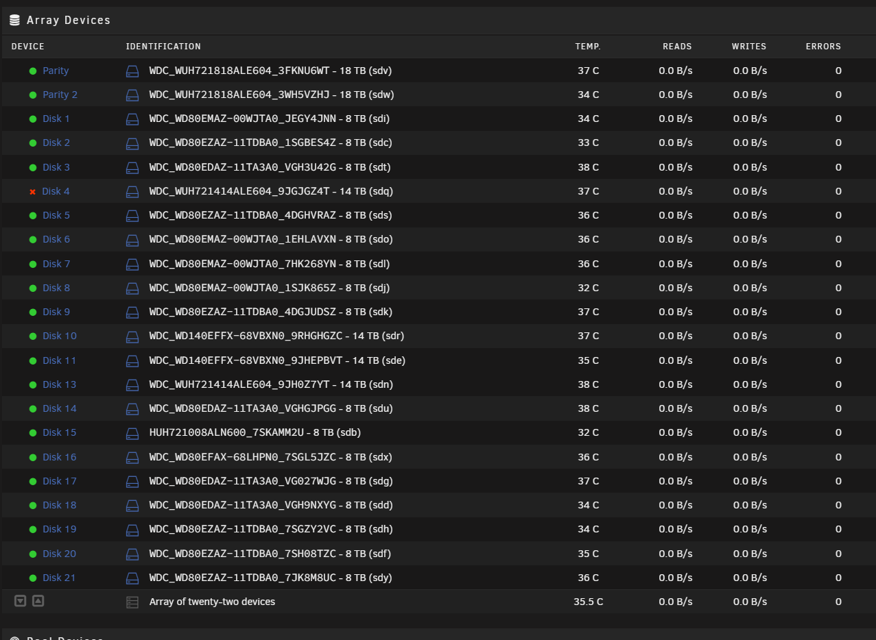

Started.
Disc 4 is currently emulated - I really don't know at the moment if I'm missing any data.

I don't see a lost+found share, so the data should be OK for both repaired filesystems, but if you still have old disk4, you can mount it with UD to compare contents.
Thank you again for your help... I'm not really sure where to go from here, and I want to tread lightly - especially since I don't fully understand what the repairs actually did.
My guess is that I'm ready to try to bring Drive 4 back online?  Another 14TB drive arrived today, but I'm thinking the first one may be okay, after the recabling(?)
Yes, but it would still be a good idea to compare the data with the old disk.
