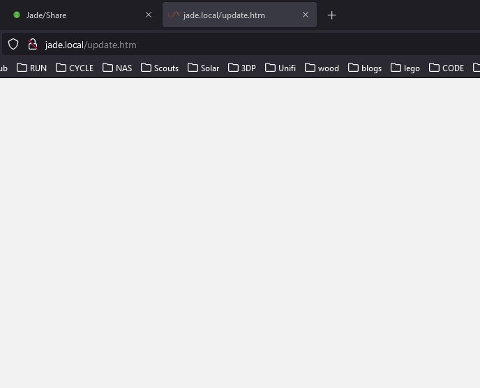

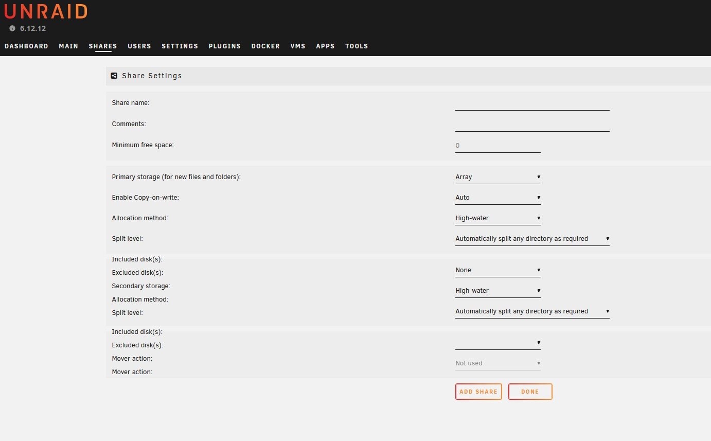

Installed V6.12.12 - waited for array to come online so then go to Shares screen. The screen looks a bit messed up - see screen capture below - and when I come to press add I get a second tab appear in my browser saying update and the share does not get added.

Have you tried clearing browser cache?
I have logged into unraid from Firefox, Chrome and Microsoft Edge and same result on all three - they use different browser caches so not considered that as a fix unless you can persuade me otherwise.

Format the disks and the shares page will show up correctly, it's a known issue.
Okay thanks - I kicked off the format. Will see what Add Share screen looks like after.
Dave
Once the format had completed then the Add Shares screen no longer looks messed up - many thanks JorgeB for the solution.
