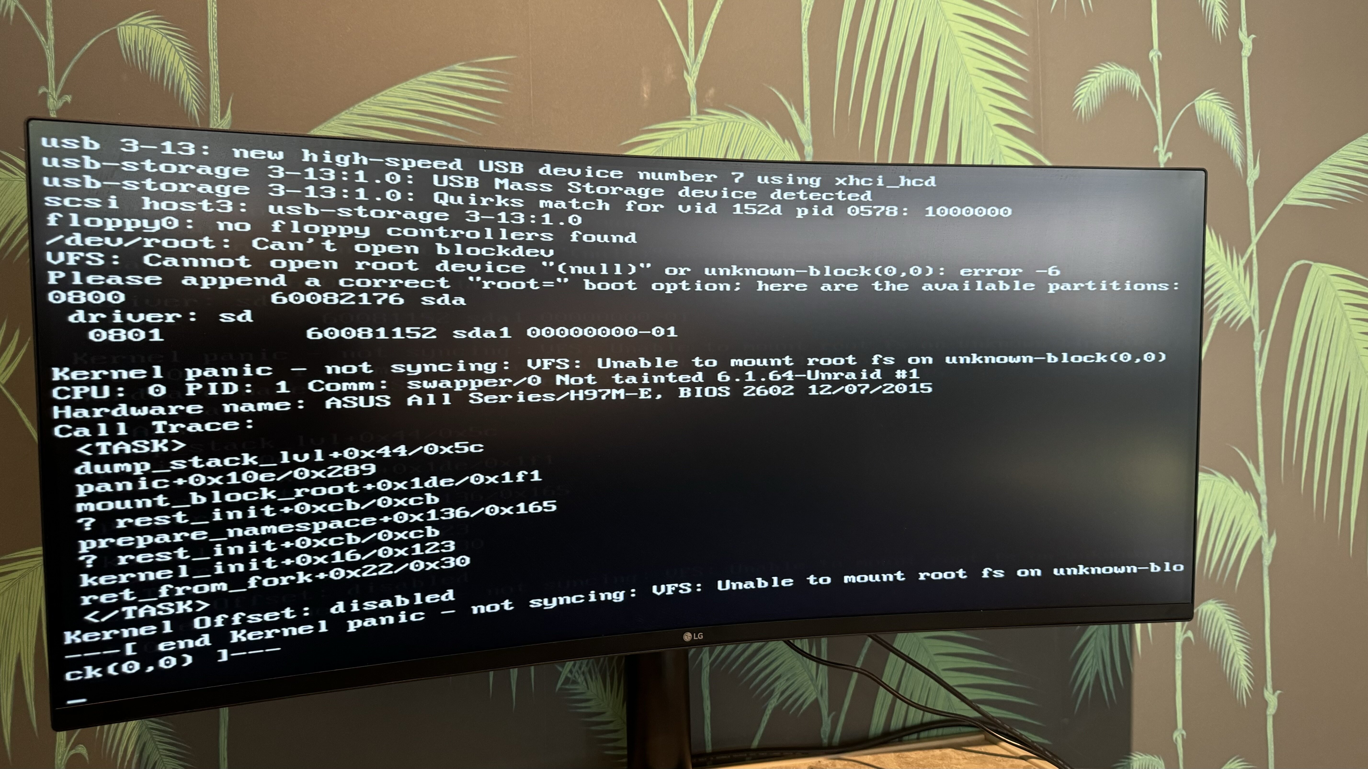

I am getting a already handled Error which is the following:
scsi host1: usb-storage 3–11:1.0
usb 4-6:
new SuperSpeed USB device number 3 using xhci_hcd
usb-storage 4-6:1.0: USB Mass Storage device detected
scsi host2: usb-storage 4-6:1.0
new high-speed USB device number 7 using xhci_hcd
usb 3-13:
usb-storage 3-13:1.0:
Quirks match for vid 152d pid 0578:
pid 0578: 1000000
usb-storage 3–13:1.0:
scsi host3: usb-storage 3–13:1.0
floppyo: no floppy controllers found
/dev/root: Can't open blockdev
nowb
error -6
Cannot open root device "sda" or unknown-block(0,0):
option; here are the available partitions:
UFS:
"root=" boot option;
UFS: Unable to mount root
Please append a correct
not syncing:
fs on unknown-block (0,0)
Kernel panic
swapper/0 Not tainted 6.1.64-Unraid #1
Šeries/H97M-E, BIOS 2602 12/07/2015
CPU: 0 PID: 1 Comm:
ASUS All Series/H97M-E,
Hardware
Call
name:
Trace:
<TASK>
dump_stack_lvl+0x44/0x5c
panic+0x10e/0x289
mount_block_root+0x1de/0x1f1
prepare_namespace+0x136/0x165
rest_init+0xcb/0xcb
kernel_init+0x16/0x123
ret_from_fork+0x22/0x30
</TASK>
Kernel Offset: disabled
pstore: cryptro compress
ck (0,0)
Kernel panic
crypto_comp_compress
disabled
failed, ret = −22
not syncing:
root fs on unknown-block(0,0)
I already tried this (
and wanted to ask if this (
)  temporary fix is still the right way to handle the problem?
I perform itimpi's solution (I overwrite the bz files with those from the zip file) and then it boots fine. However, the problem eventually happens again. I didn't make any changes nor add any plugins.
Othewise i need help please!
Solved by JorgeB
USB2 port is more reliable for Unraid boot device
Thanks, but this is the output if i try to boot from the USB2 port:
I think it has to be something very obvious. And i am just not getting it.
