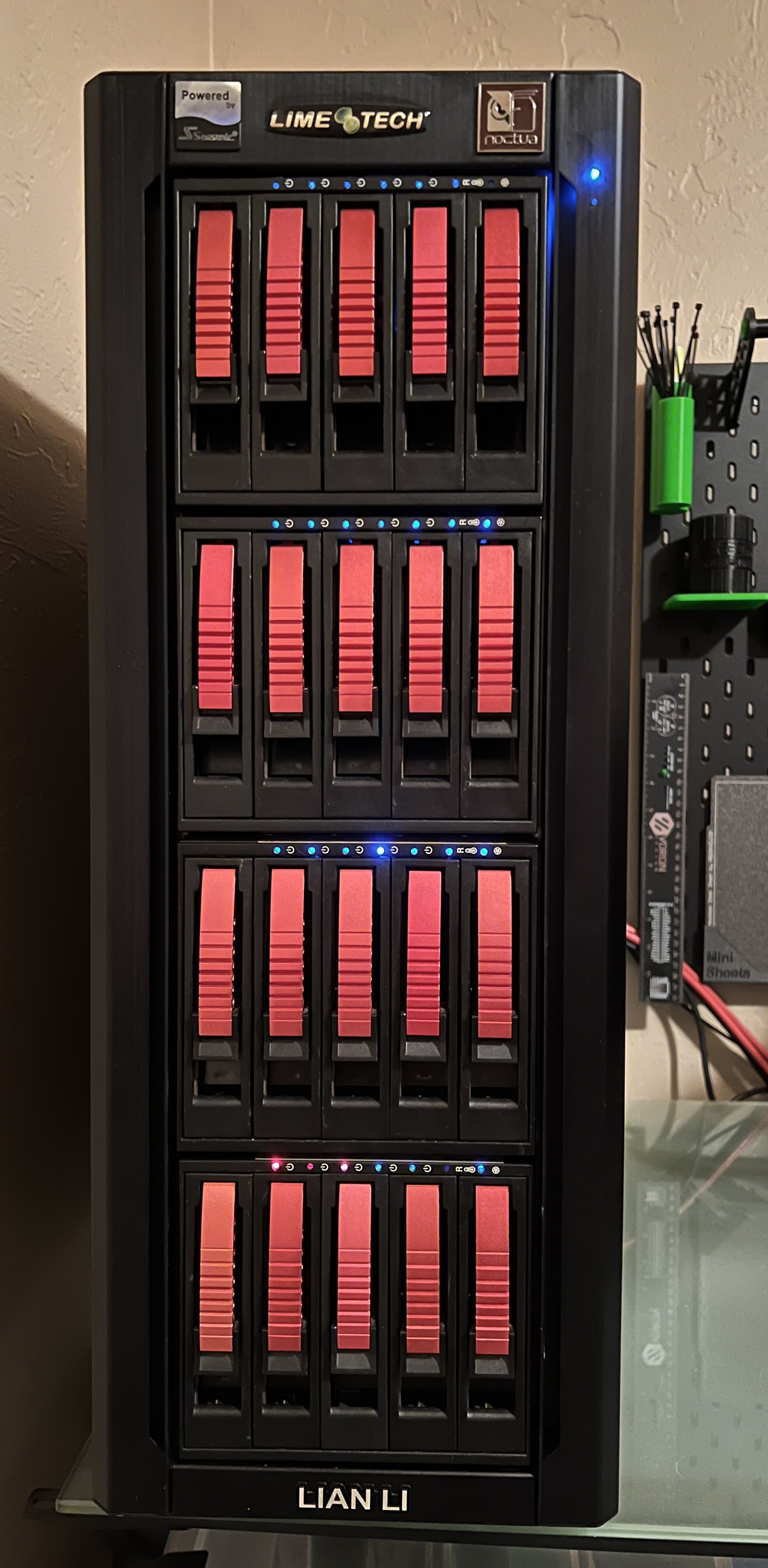

I just finished reconfiguring everything inside.  Since I only have 6 ports on the power supply for SATA/Molex cables, I used 4 or the ports to run dual Molex connectors to each cage.  I moved the SATA SSDs into cage 4 instead of having them inside the case on a bracket.  I used the remaining two SATA/Molex power ports on the power supply to run a SATA power connection to two cages, then the other to the other two.   Since I know I'm going to start reducing the number of drives I have in my system to avoid future power considerations, I don't feel it's inefficient to use some of the trays for SSDs now. (see attached pic of the new layout, the only drive missing is the NVMe that's on a PCIE addon card)  I am going to start getting 12TB drives, starting with the parity drive, of course.  Then I'll start moving data off some of the old 3TB  and 4TB drives and reallocating the 6TB drives to replace the others.  I want to stay below 15 total HDD in the system from now on.
I wanted to get everything squared-away before midnight tonight, when my monthly parity check runs.  I'm considering shrinking the array (removing disk 16 [3TB] because it's only there for ZFS replication and snapshots)
Edited by prongATO
added photo of server for reference

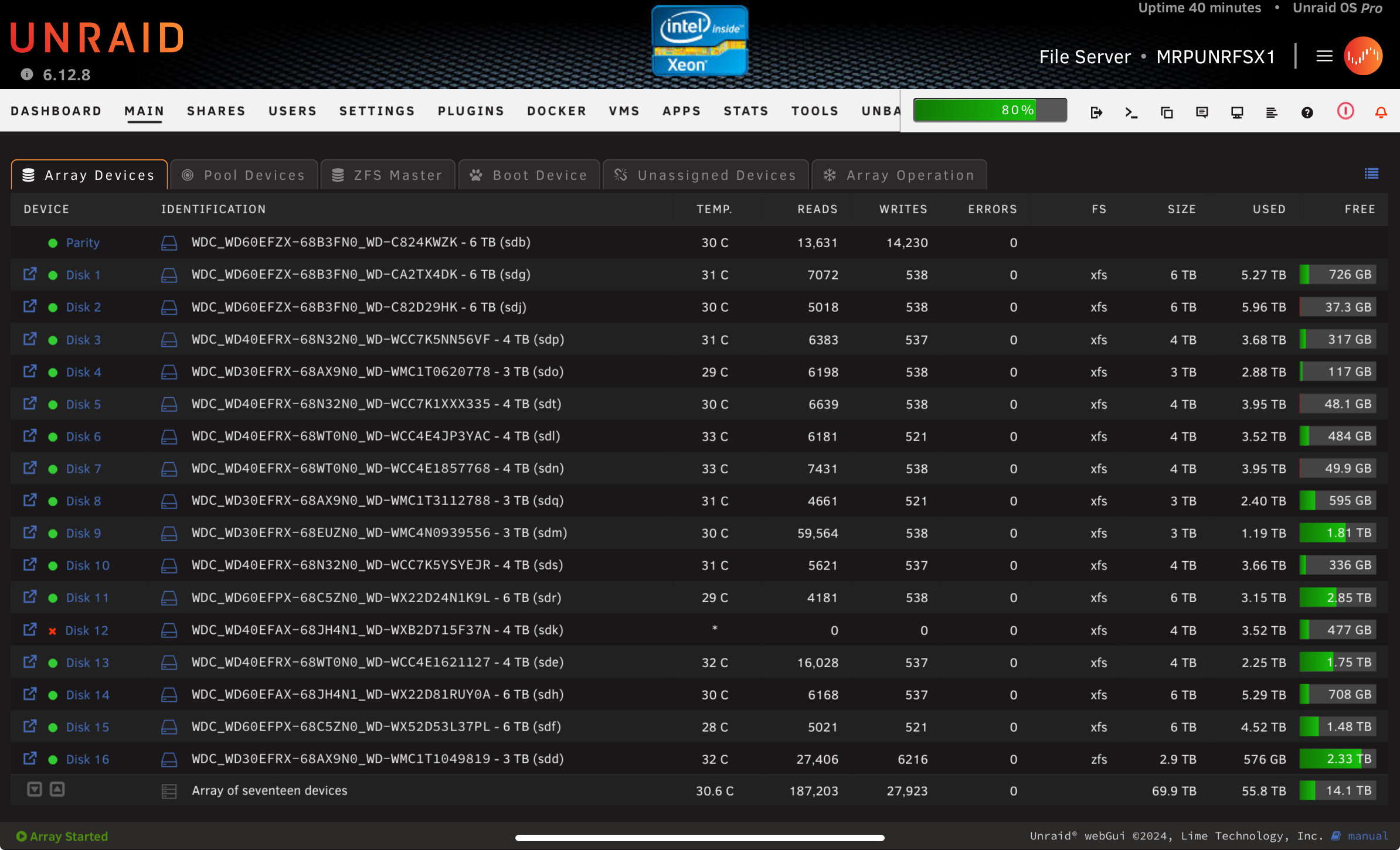

I went ahead and started a parity check today since I realized the 1st will be in another day.  I want to let the system hammer the drives for a day or so to make sure everything is copacetic with power/error issues now.  If the parity check completes and I successfully downsize the array, removing disk 16, I will mark this as solved.  @Vr2Io and @JorgeB, thank you both so much for your help with all of this.  I know it was a bunch of trial and error but it was really nice to have two different perspectives while attempting to solve the issues.
well, $hit..   Diagnostics attached.   Happened during a parity check.  Now it's disk 12
is it just a coincidence that the amount of errors are always divisible by 1024?
mrpunrfsx1-diagnostics-20240831-0114.zip
Edited by prongATO
Tried rebuilding disk 12, I am back where I started.  I’m about to just give up and throw this thing out the window.
i am just going to let it run with the disabled disk 12 so I can sleep.  Every time I try to rebuild the drive and get an error, the whole http interface locks up.  So, this is now the third different disk that has supposedly had errors since I started this thread. (15, 16 and now 14) all different sizes and all have clean SMART reports.
mrpunrfsx1-diagnostics-20240831-0155.zip
Edited by prongATO
Not sure if this makes any difference but I didn’t try to rebuild disk 12, the dashboard shows 0 errors, yet the http locked up anyway.

Disk dropped offline, again looks like a power/connection issue.
I suggest you stop rebuild any disk, if disk were drop-out due to read error or crash and actually no problem.
When disk drop-out, does it can mount by UD ? if answer is positive then no meaning to fully write disk once.
Problem happen over a week. current troubleshooting method doesn't work, you need proactive or a way which could quickly reproduce the problem, so make work more effectively.

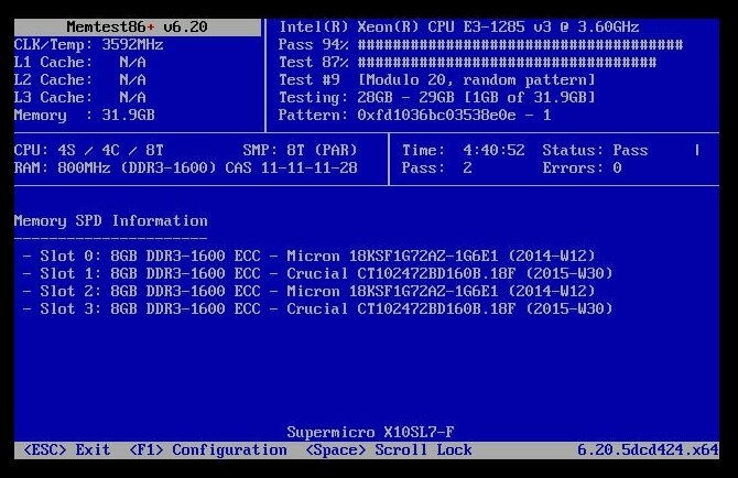

Could you use built in memtest to test, the one in Unraid booting menu( I know you have test by memtest plugin )
Then I will request some stress test later.

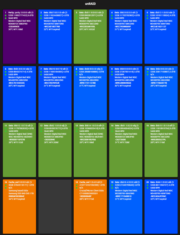

And to recap, before asking for assistance I've already replaced:
LBA Card
Power Supply and PS cables
Processor
LBA Card break out cables
different drives (which we see now it is not drive specific)
Other than it being the motherboard (God, I hope not), I'm not sure what else it could be.  I am going to revisit my power cabling and possibly switch to doing a discrete SATA cable (one cable with two connectors) to each 5 in 3 and double Molex (1 discrete cable for two cages)

Roger that, I'll make sure to supply a diagnostics after every change from this point forward.  How many passes until we're satisfied with the memtest?
It's through 3 passes and 54% on the 4th, all good.
Edited by prongATO
Note and thanks, when I build or make change on hardware, I will first make memtest because it absolutely importance for system stability verify. Form my memory, I haven't DDR3 bad record but for DDR4 I got about 4 times bad record.
Edited by Vr2Io
I'll let it run for 4 passes plus.  Since the server had been down all day, I might as well let it run until we're satisfied that there will be no found errors.  I'll post a screenshot of the test screen before I stop.

I’ll get started on your suggestions tomorrow.  I decided to let the memtest run overnight, just to be safe.
