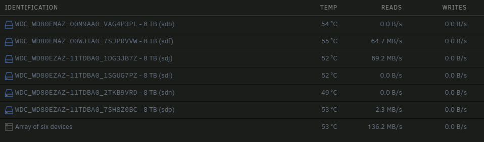

First, man, your drives get toasty!  The highest I’ve ever seen any drive in my system is 38c.
Yes, bad cooling and room temp 30c 😅

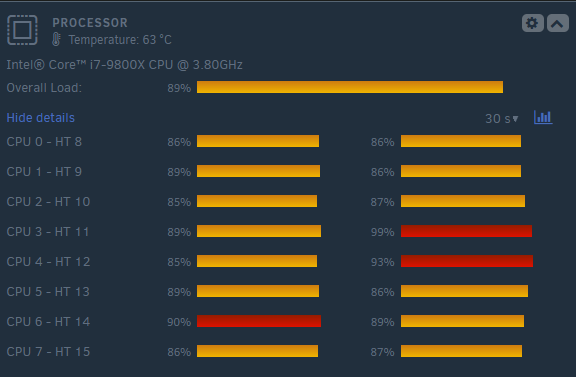

(4) Parity operation should generate maximum I/O and useful stress disk to drop-out, but in this case seems not. So I will suggest some different test hop can reproduce problem ASAP. But I won't know what will trigger this, so just try it.
Pls open 3 terminal, execute below command, concurrent two hash for big file should provide enough loading to CPU, the 3rd one just make another hash for small file.
find /mnt/disk5 -type f -size +8G -exec b3sum {} \;
hash file on disk5 which large then 8GB.
find /mnt/disk6 -type f -size +8G -exec b3sum {} \;
hash file on disk6 which large then 8GB.
find /mnt/user -type f -size -5k -print0 | sort -Rz | xargs -0 -n1 b3sum
Hash file on user share ( random sort ) which smaller then 5k.

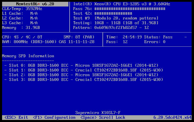

While the memtest was running I removed the 3rd 5 in 3 and thoroughly cleaned it out.  I ordered a new fan to put in it and will likely do that for all 4 cages if it works well.  After I reinstalled the 5 in 3 it rebuilt disk 12 with no issue.  I still have the server in a state were I can service the cages.  I will stress test it to see if we can make it error again on Wednesday.  Right now, the parity is valid and the array is green.
Diagnostics from the latest boot attached. (no disk errors, so far)

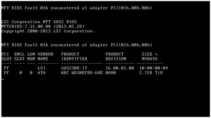

Just noticed this on a reboot
Never found this type / form error, likely HBA or Mobo related, because disks won't cause this. How many disk detect when booting in Unraid ?
Edited by Vr2Io
I have all 8 populated on the LBA card.  There is also an LBA card built into the MB.  All are full at the moment.
On a reboot the error is cleared

Just notice you have onboard (2008) (2308) and addon HBA (2308) (2008).
Need check does disk drop at either HBA or cross.
Edited by Vr2Io
6 minutes ago, Vr2Io said:
Just notice you have onboard (2008) and addon HBA (2308).
Need check does disk drop only at onboard HBA.
I thought that was the issue at first, overall with all this, I've had most of the errors on the LBA card, that's why I replaced it already but the error we got on disk 16 was connected to the MB at the time.
Through you have more then 8 disks and you need two controller, can't isolate the controller to test.
Because I thinking if a fault controller will affect another good one, but this I can't confirm.
In normal booting, does LSI BIOS will show two controller in same list ?
The error message said addon ( 2008, 01:00.0 ) fail, but onboard ( 2308, 02:00.0 ) fine.

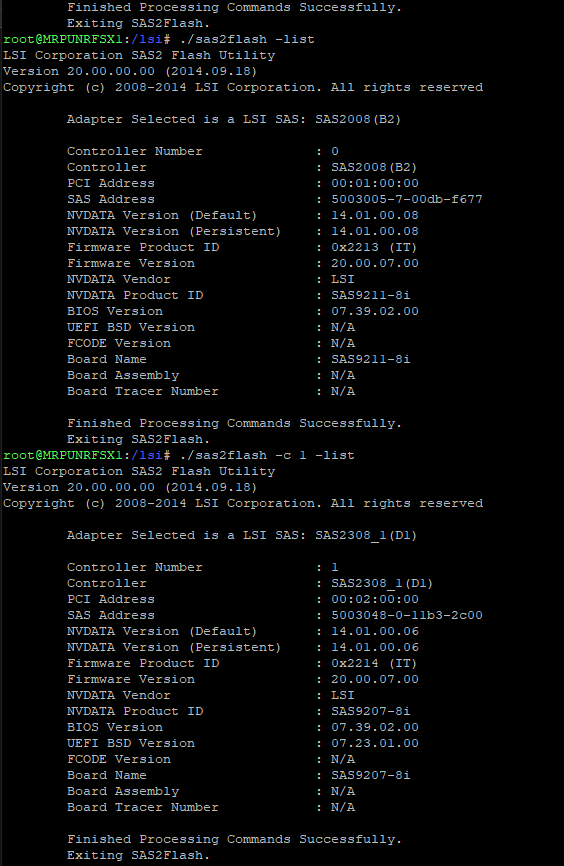

3 minutes ago, Vr2Io said:
Great if you crossflash addon 9211 ( 2008 IR ) to ( 2008 IT ) for best combination.
They're both flashed to IT mode and both are the flashed to the most stable version 20.00.07.00 firmware and the bios has been updated
Edited by prongATO

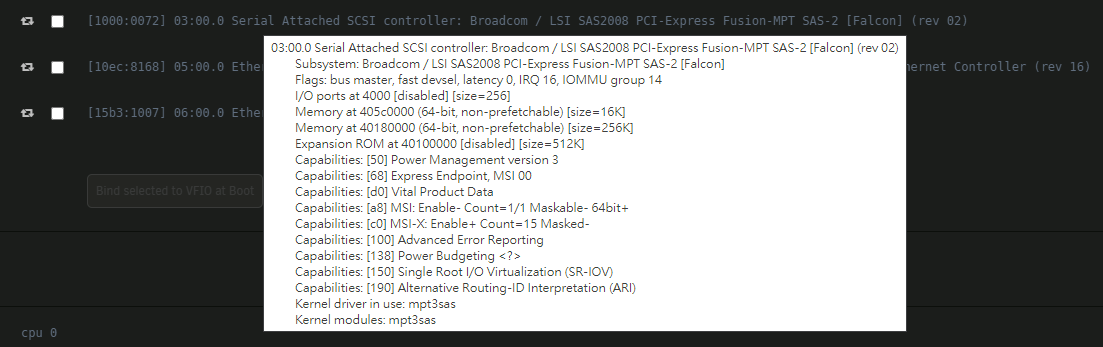

Below is my previous SAS2008 HBA look like.
Edited by Vr2Io
I haven't any SAS2008 in system, but your one show RAID bus controller, it look like IR firmware, anyway this doesn't matter.
