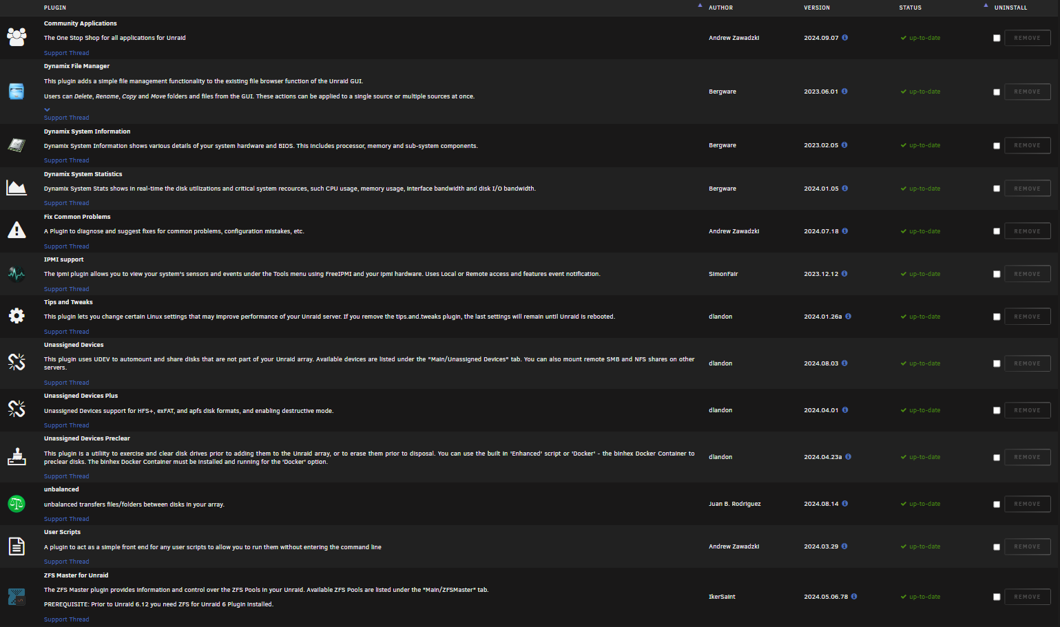

I removed all the plugins I either no longer use or thought might be the genesis of the issue.  I also removed disk location.  I paid special attention to the plugins that haven't been updated in a while and removed them.  I now only have the following plugins installed

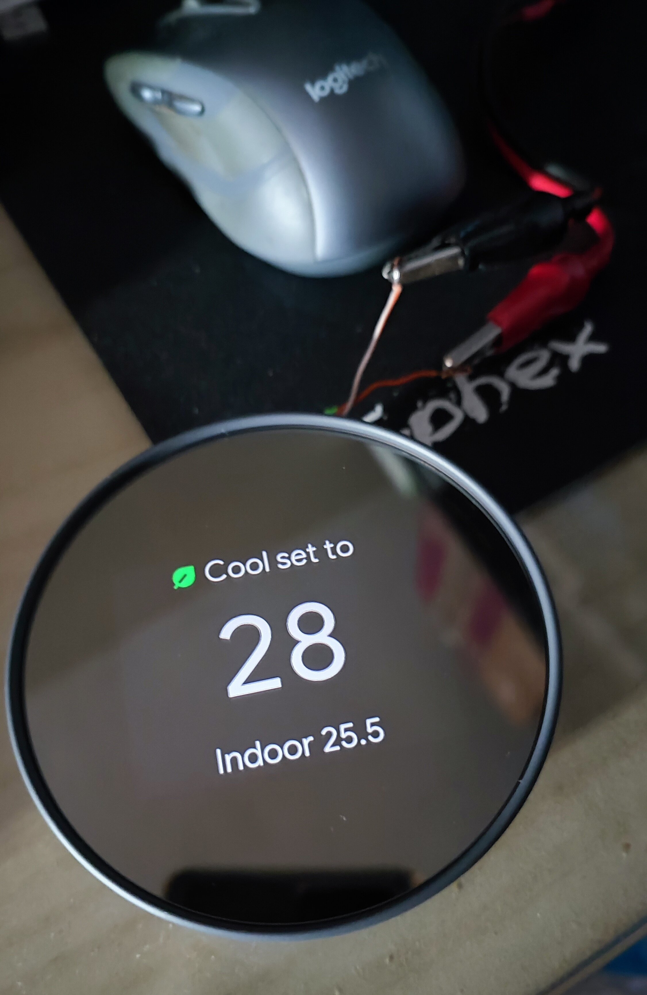

IoT and automation stuff is current project, my 2nd Nest thermostat arrives, I like those gadgets.

Yes, we always need consider security issue, so I have put them in different VLAN, and mostly important the application server ( Unraid with home assistant ) haven't any critical private data.
The reason for the 2nd Nest is because the old Nest doesn't support Matter ( that means must cloud base ), so I realised I should advance to Matter for future prove, also an entry point for some new technology.
