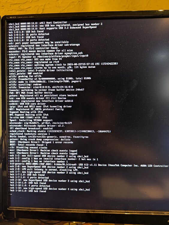

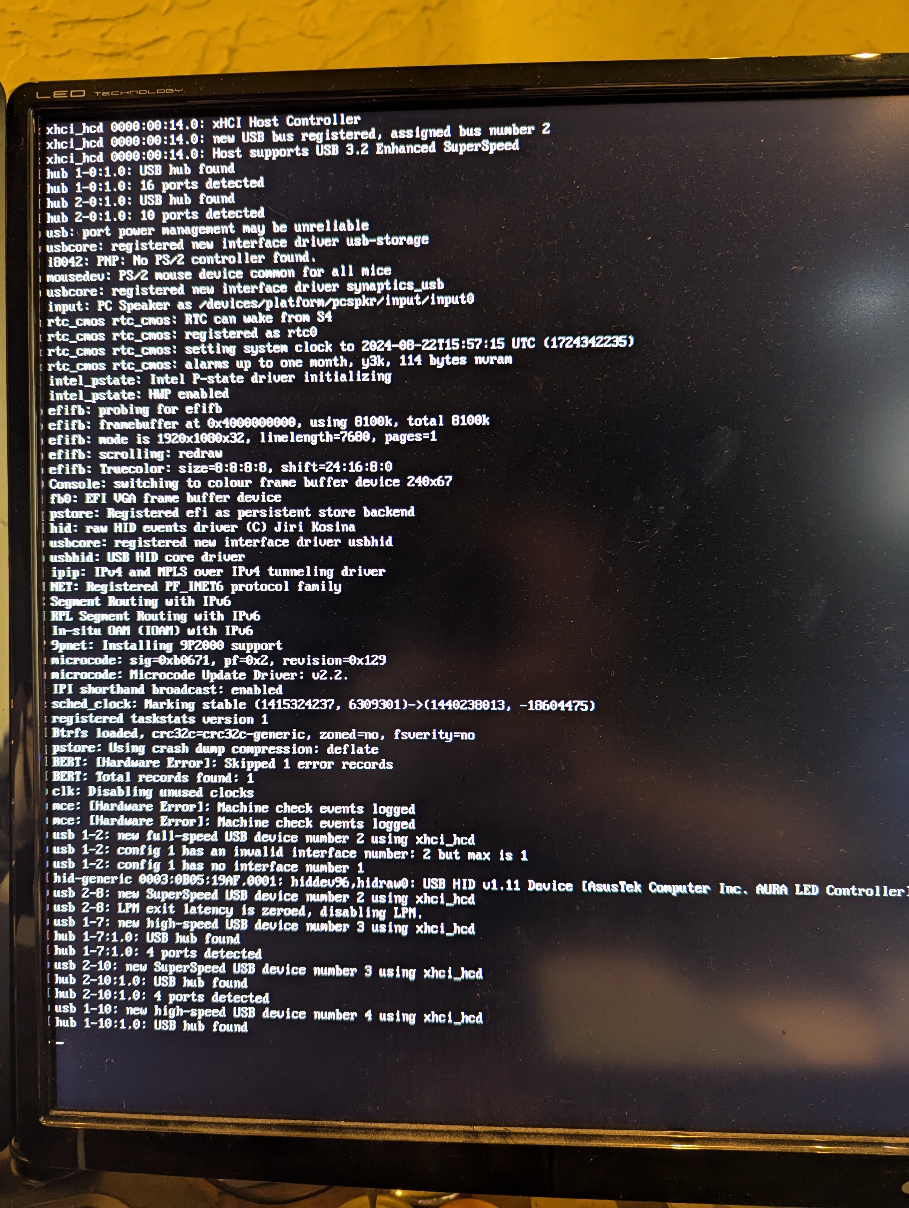

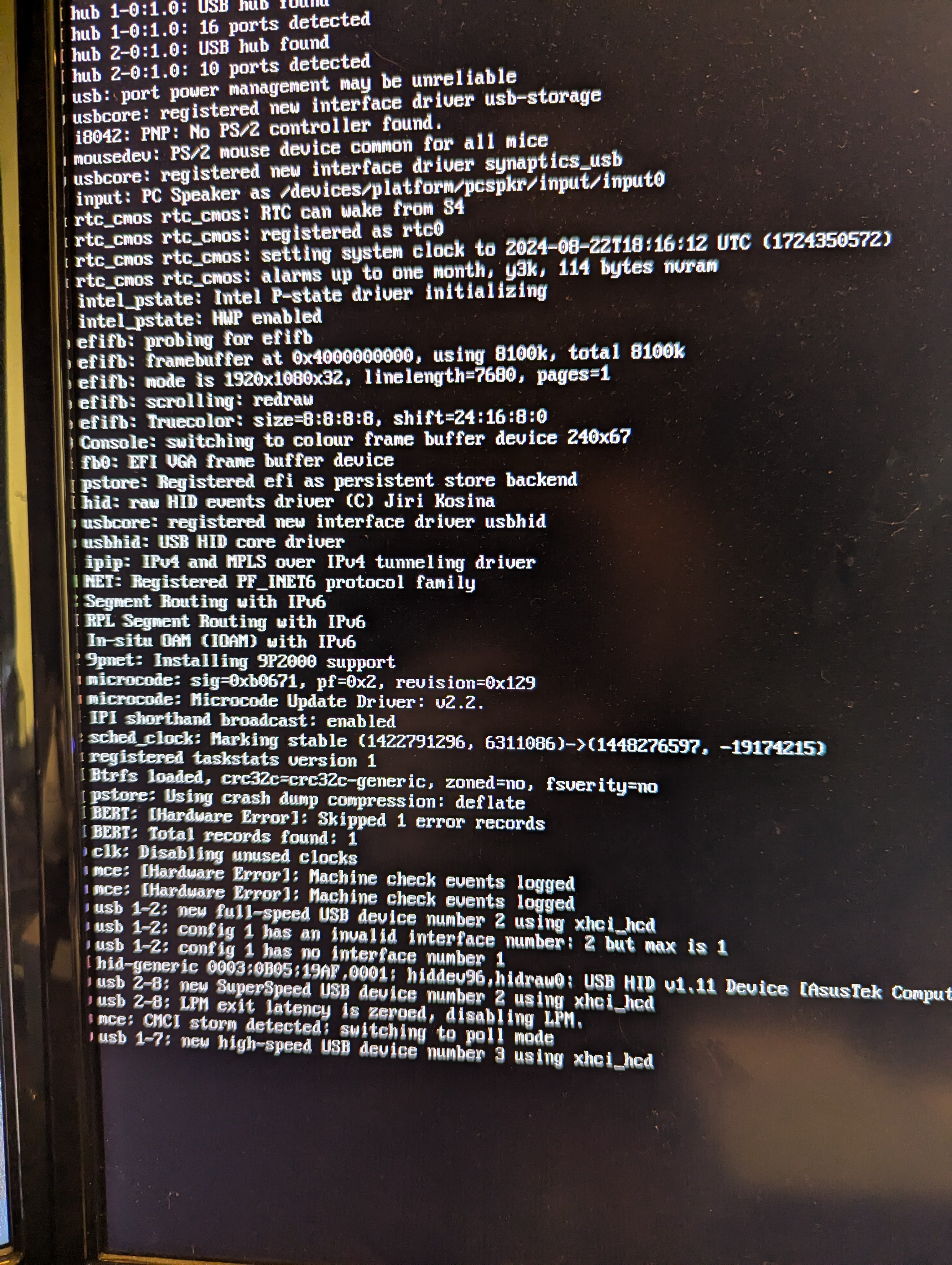

I'm not sure whats going on....I can't figure this out.  When I boot up the server, I get the Bios beep, and it goes to load Unraid.  It does the first option of standard unraid, and starts loading, and then freezes at the USB section....I'm not sure what is going on.  I tried doing the safe mode, and I get to a similar position.
Each picture is from one load, one is safe mode, and one is standard load.  I do see a MCE error, but I can't get anything up to actually check the logs...

worked before....I was having issues about a month ago, and it ended up being the CPU and intel warrantied it out, but I checked everything and they were all good.
It was working, and then all of a sudden the server froze, and then when I went to boot it back up again, this started happening.  Already tried a new port....let me try a different set of ports maybe..
well that didn't work, still stopping on the USB section of boot

Ensure bios is updated.  Edit: Seeing 13 and 14 gen Intel CPU makes me nervous with failing equipment.
If a spare drive, see if you can fire up a different OS and maybe you can glean something from logs.
