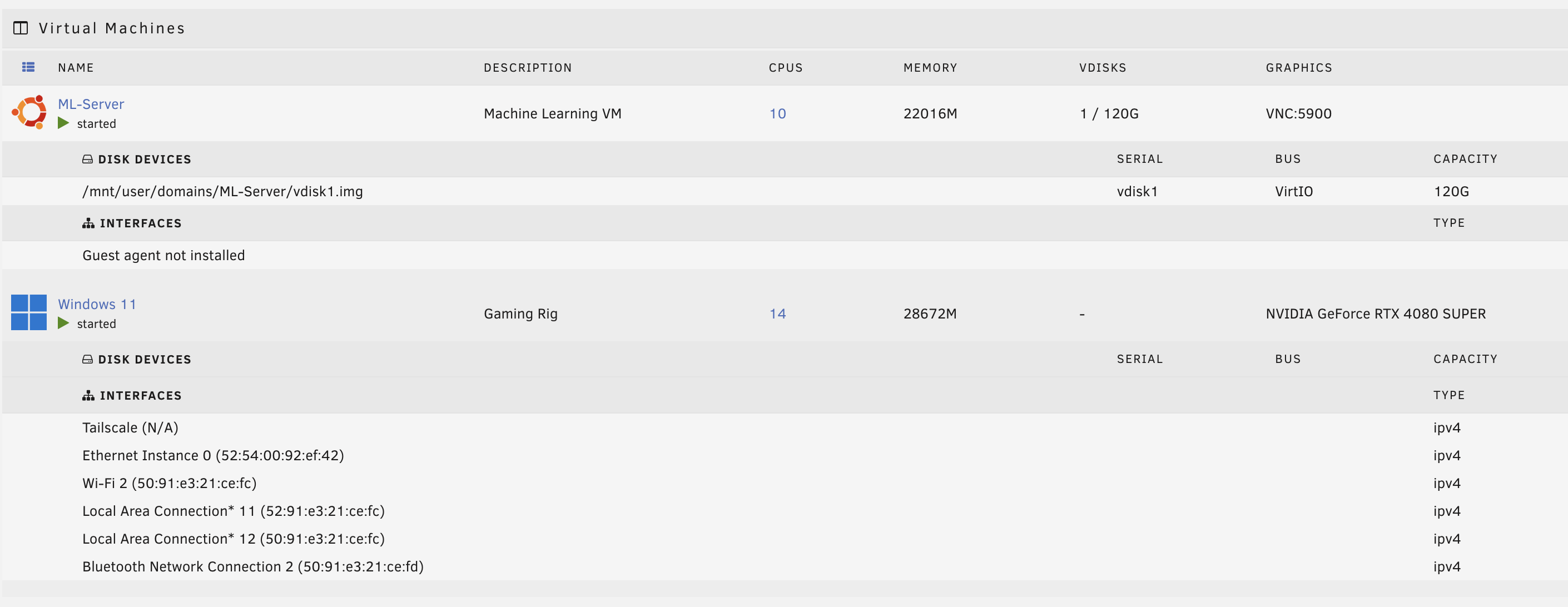

I have two VMs in unraid, Windows 11 for gaming and Ubuntu Server for developing. The idea is that typically my gpu is passed through to Windows 11 and if I want to run gpu accelerated dev workloads I can shut down windows, pass the gpu to ubuntu vm and restart it. I had done this in the past (maybe 6 months ago) and it had worked fine although I was using a different gpu back then. Today I attempted to do this and after rebooting the ubuntu VM it was completely unresponsive. It does not connect to my network (cant see it in router, cant ping, cant ssh), it does not stop gracefully I need to force stop in order for it to shutdown. I did force stop it eventually and remove the gpu passthrough to see if it would work but its the same and VNC console simply says "Guest has not initialized the display (yet)". Not entirely sure how to fix this I would appreciate any help. Here is screenshot of vm tab, vm logs, and xml files:
Unfortunately I did not save the xml prior to making changes (rookie mistake I know).
ubuntu.log ubuntu.xml
Edit: Previous gpu was also a 40 series but I had removed all the nvidia drivers from the vm and was planning on reinstalling them with the new gpu passed in. I also didnt make any changes to the xml directly for passing the gpu I used the gui view to switch from vnc to 4080 and back.
